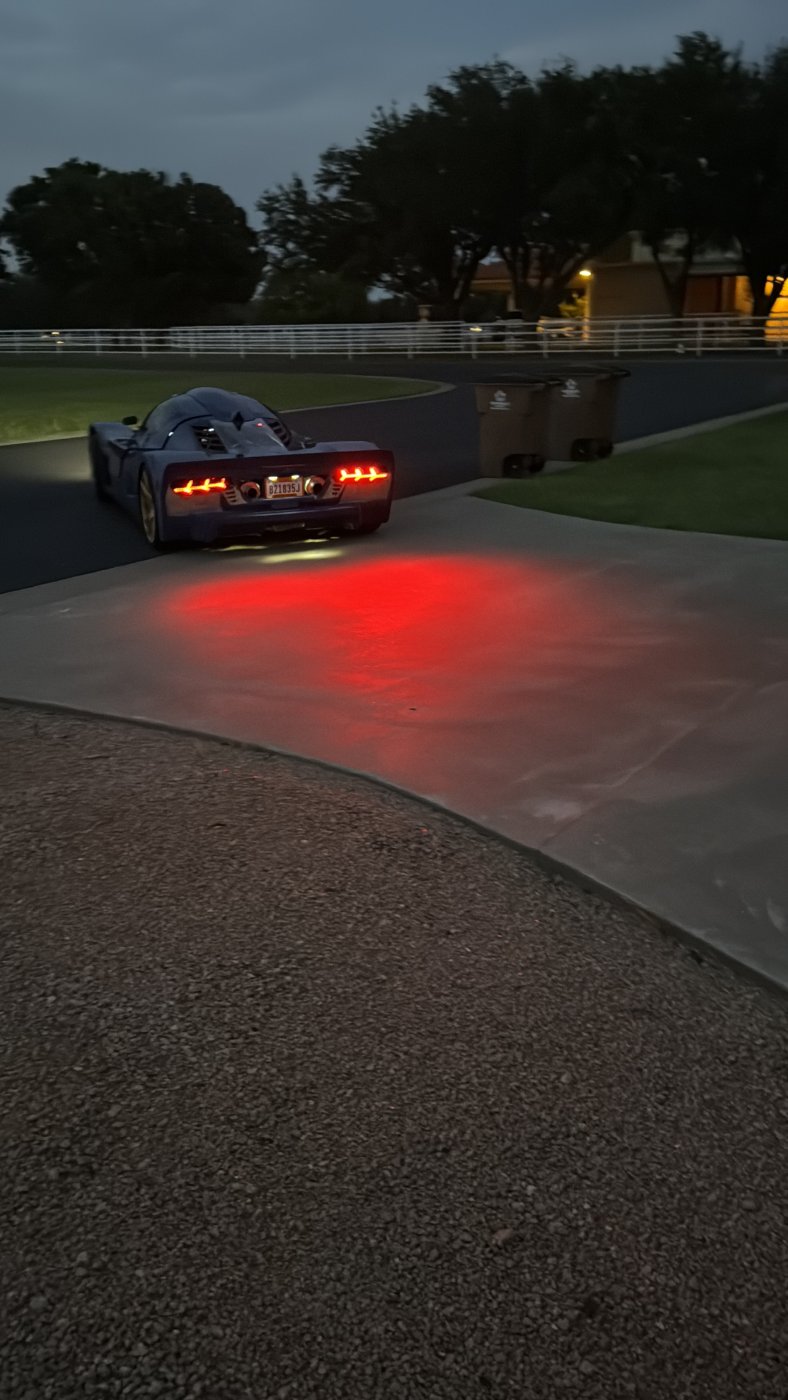

I absolutely love my corvette lambo style sequential tail lights
The last picture shows the car agains typical Texas vehicles, it really looks like a toy !!!
Truly enjoying every ride, and getting butterflies every time, scary and cool at the same time, a totally new experience . Strongly recommend it :cool:

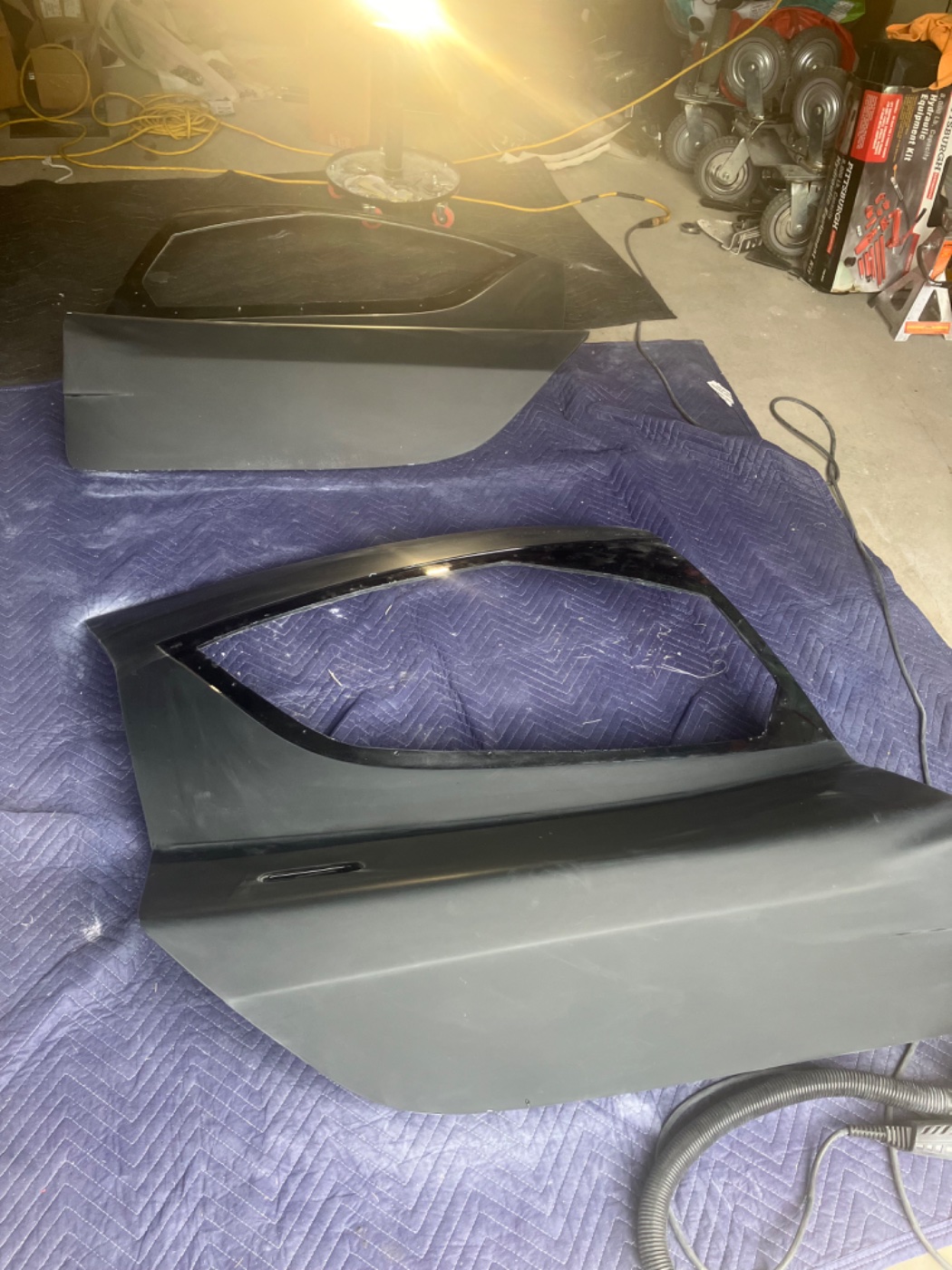

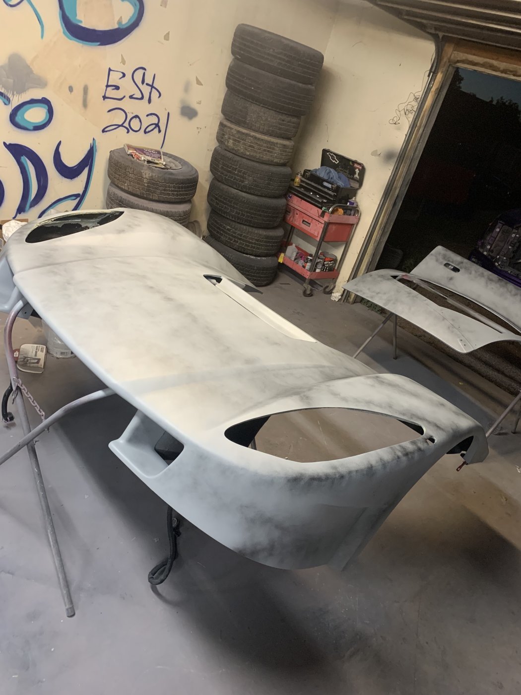

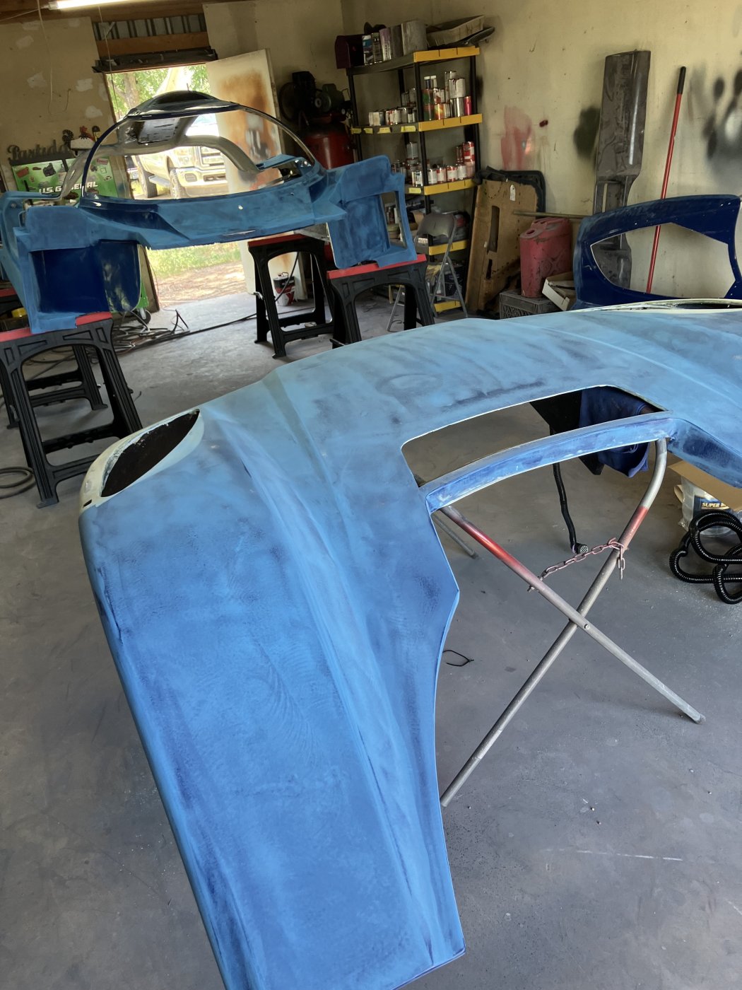

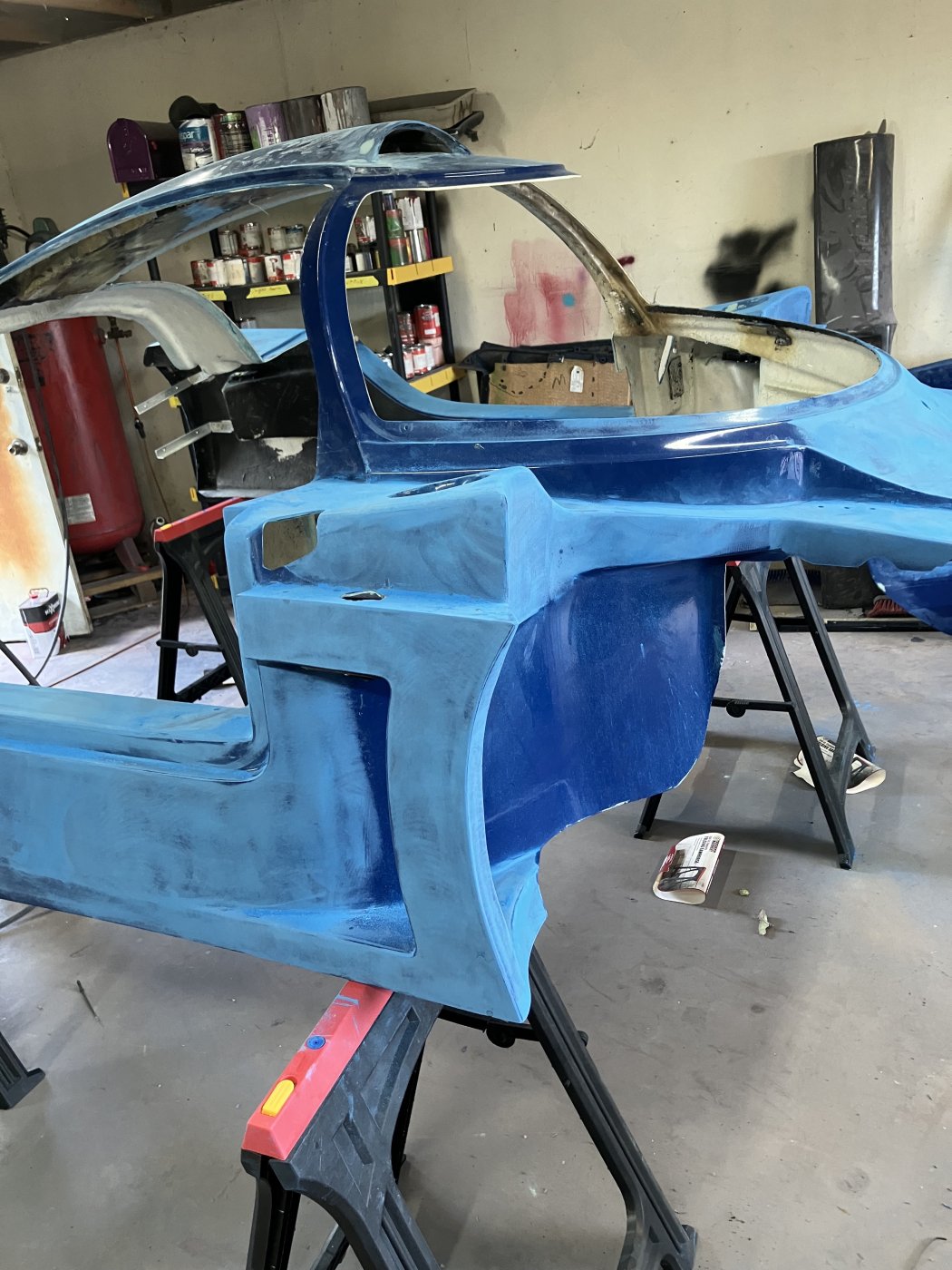

Just when you thought I will have no updates for a while. As I was leaving cars and coffee I saw a guy with a paint shop T shirt , I asked him if he was a painter, he told me he just started his own paint shop here in town, that since he is building ip his business he will work with me super reasonable, and he has been doing painting on the side for many years but just got laid off and will switch to painting full time. He showed me some of his work, top notch .
So I was going to Plasti Dip my car like Cam but I was hesitant about spraying the 2K primer, I heard is thick and tricky, so I figured might as well let a pro do it, then I will do the Plasti Dip myself.

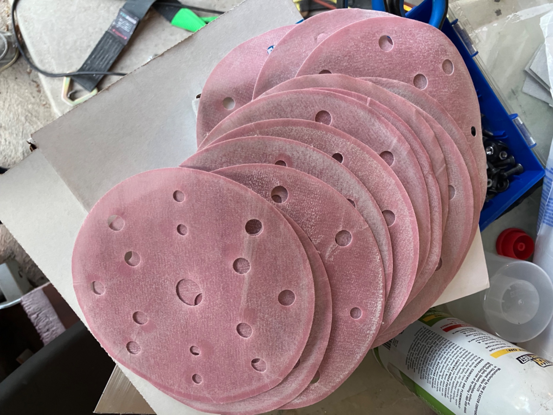

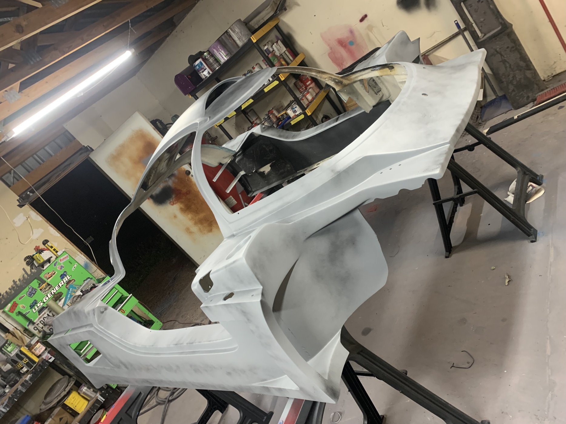

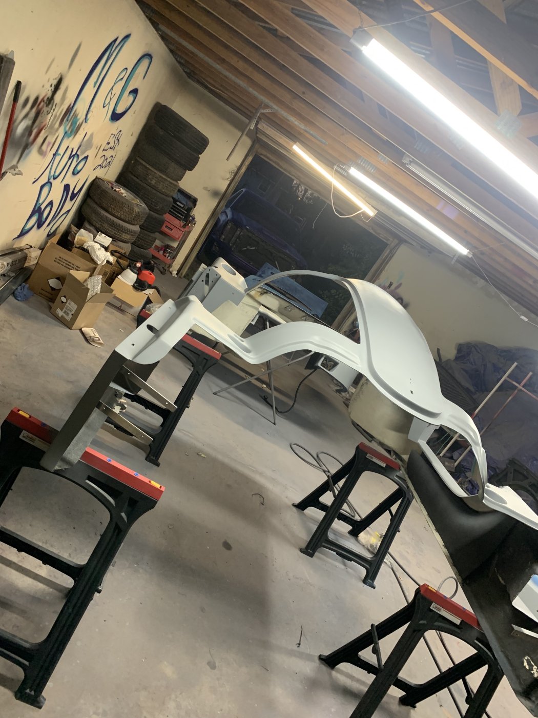

So I helped my new buddy with a lot of the sanding, I was going to leave a few parts on like door hinges (that are tricky to fine adjust) , but decided at the last minute to disassemble everything 100%. no masking of any kind . :)

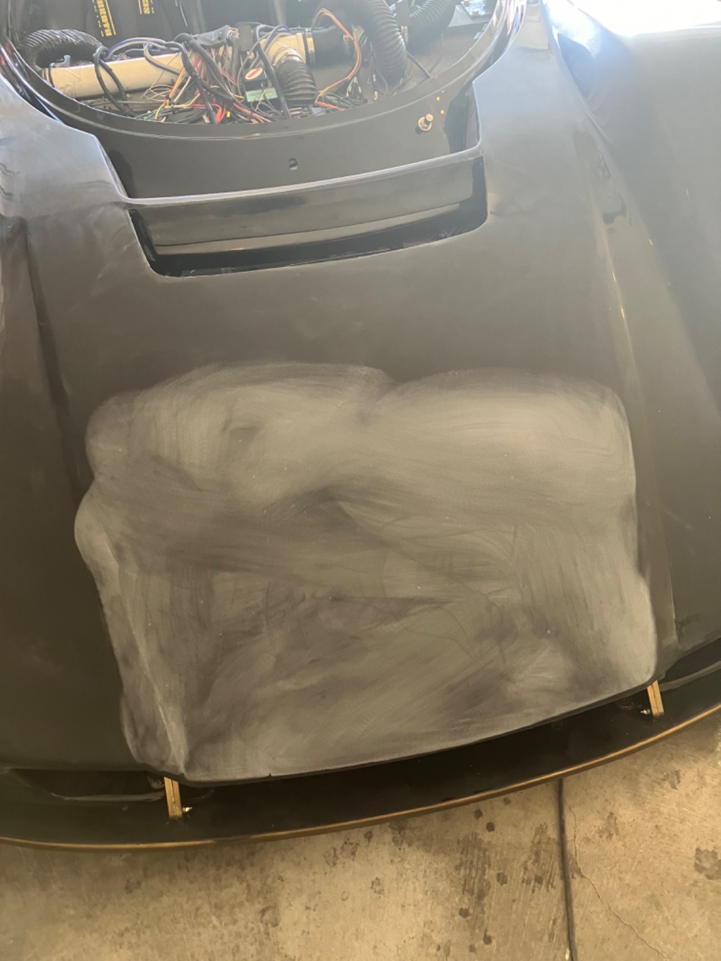

I had done most of the fiberglass work, defects, mold lines and such , hours and hours of detailed body work .
So today I went to the shop and my new friend was asking me why I wanted to do the Plasti Dip. My answer was for 2 reasons , flexibility (try different color schemes) , and second let the cracks and rub spots develop over time and not ruin an expensive paint job.
But the kicker is, some of the spider sections will be painted black , the door sills , the areas that sit under the front and rear clams , so basically a large portion of the spider.
And his point is , we have done all the prep work, a very nice priming job, you will have to partially paint and clear coat the spider, why not just do a full paint job?, if I choose to Plasti Dip on top of that that is fine. the major expense of a paint job is the prep , primer and re sand, which we already have done.
But I already bought the Plasti Dip, spray gun and dip armor protection for the Plasti Dip.
So ........ I will leave you in suspense and show you pictures in a few days, you will see what direction I went .
So basically my two choices are Plasti dip , very little additional cost, worry free driving (no worries about damaging the paint) , or a nice paint job for much less than a cheap Maaco job and a beautiful metallic finish with clear coat ( I am leaning towards a BMW metallic black that is gorgeous).

Howard Jones
Oh fuck that's easy, PAINT the CAR! Then add clear chip protection to the nose and the area that is the place where the front tire throws road crap onto the body in the front of the lower center section in the rear of the lower wheel well. Done and dusted! Be sure to use a color that is used on a production car. That way you can repaint the front clip in a few years and it will be like new. If you use clear protective film you may never repaint. Be aware that the heavier the metal flake the harder it is to match later.
In all honesty, I personally don't like the plastic dip look, but that's me, and it's your car. I like the look of wrapping the car better, it looks more like paint.
So that is what I would do. Take advantage of the super deal on the paint job and then wrap it someday if you want to change the color. You might be able to use a clear wrap on the nose, I am not up to date on the wrap versus the clear protection comparison.
Why would you plastidip the car ... this isn't a ghetto ass 1996 honda civic ... and it's not 2010 anymore where plastidipping everything is cool.
If you're worried about durability and letting things settle, then you sand/polish the gelocat to a mirror finish .... I did that for my 917 and sl-c (after having my 65 cobra re-painted 3 fucking times because I somehow kept choosing the most incompetent people even though their samples were top notch somehow) and almost 15yrs later you couldn't tell the difference between them and (white) paint. Plus gelcoat is tough as nails so I love that.
Hector
yeah, that's the direction I am going , and used a standard BMW color with very little flakes and I am planing to use the clear bra thing in a few places . The paint job is taking forever , I think the guy is inexperienced and got over his head , but at the end, is cheap and much better than what I could have done.
Hector
unfortunately there were too many places where I modified the body and there was bondo and primer, no sense trying to match weathered gelcoat , and I like what Cam has done, he already changed the color 3 times , and it looks very nice , not ghetto at all , and super cheap.
but once all the sanding and priming was done the cheap paint job was the path of least resistance and least work for me short and long term
Hector
With the popularity of semi-mat finishes, plastidip or wraps fit right in. Unless you are going for a simple classic paint job, it will be dated in a few years.
In West Texas you are always one good sand storm from needing a repaint anyway ;)
or a hail storm, had a couple of bad ones recently , hammered two of my cars , old ones thankfully .

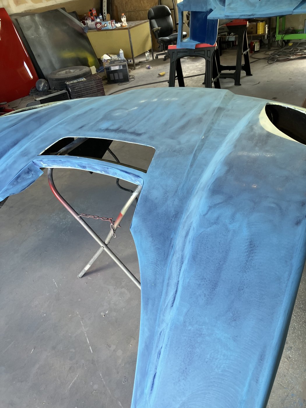

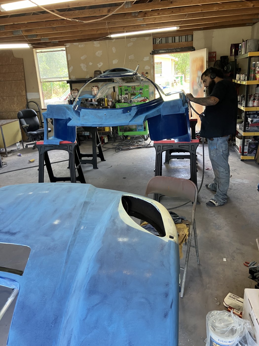

Hector

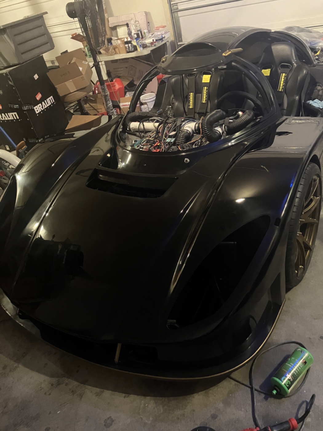

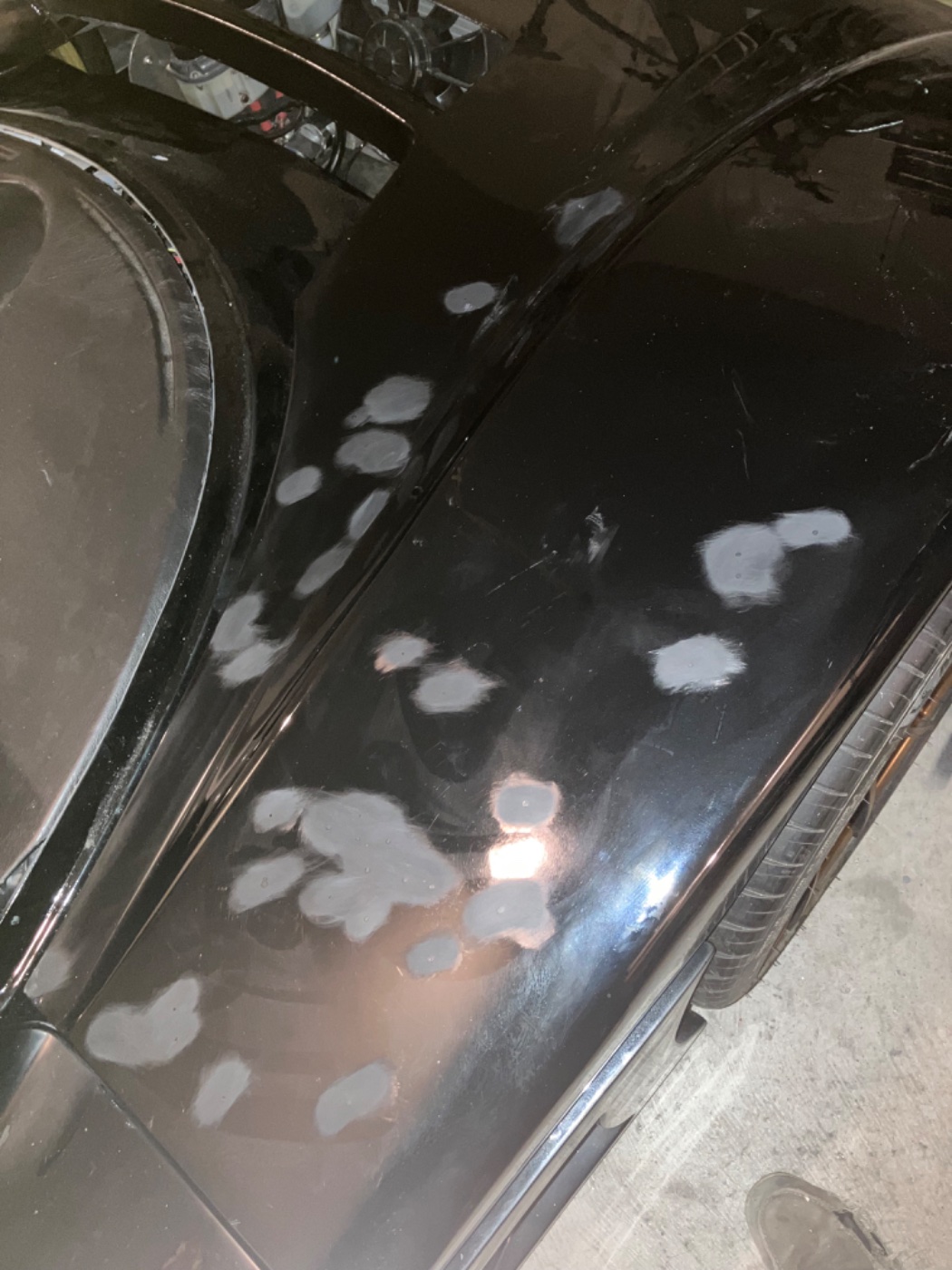

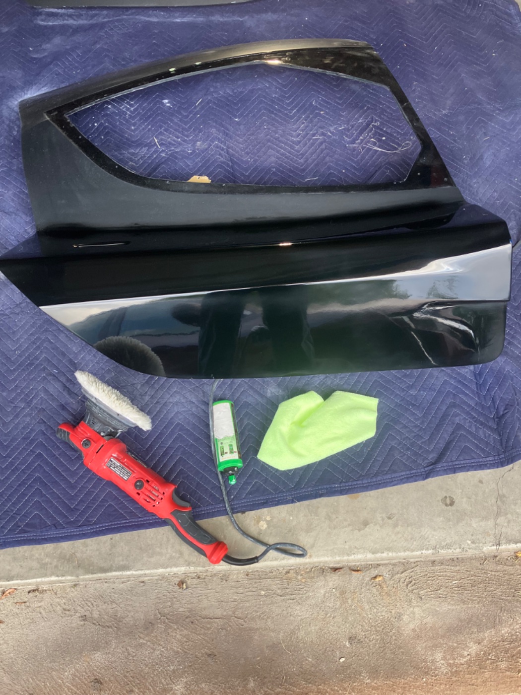

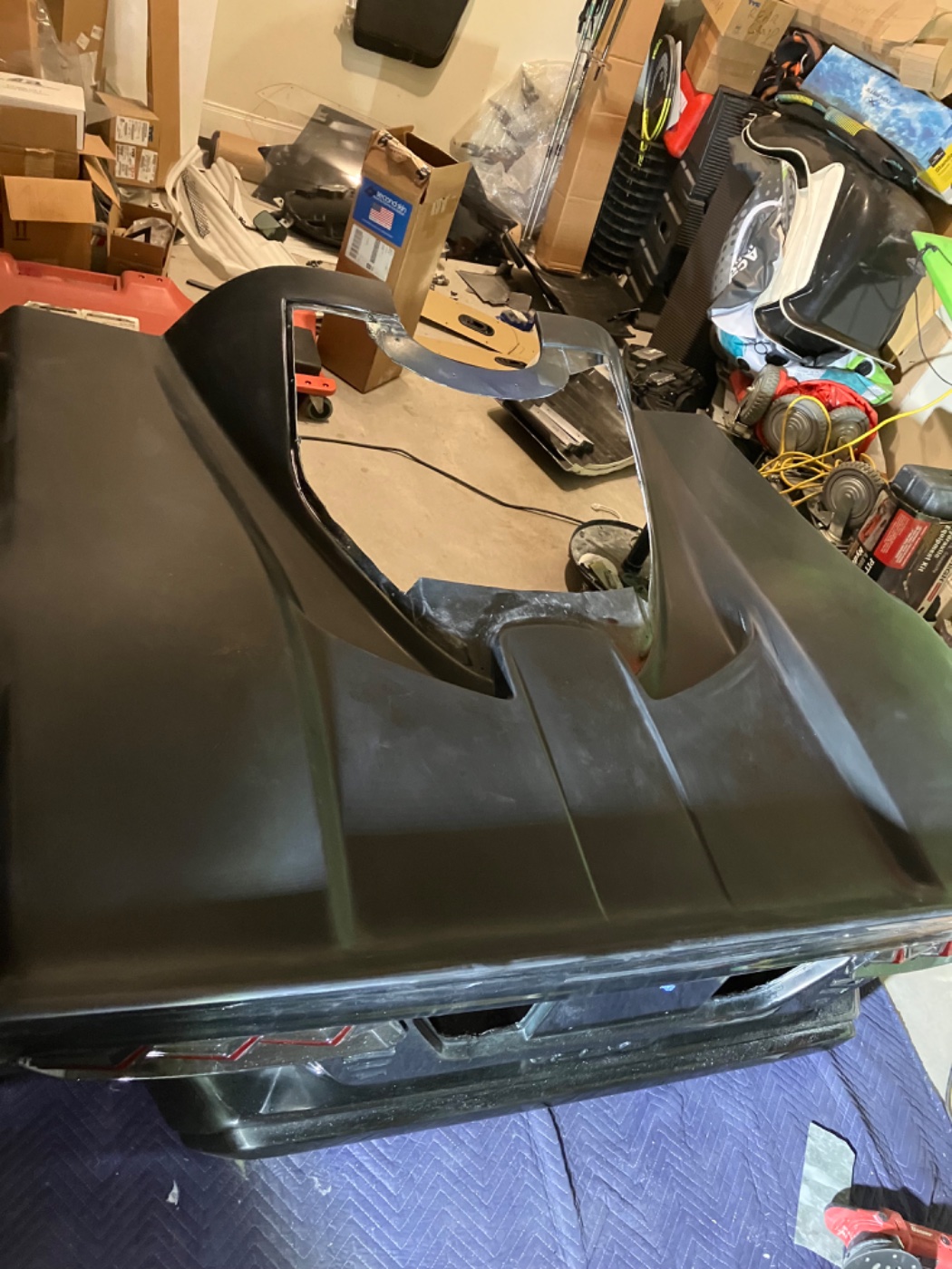

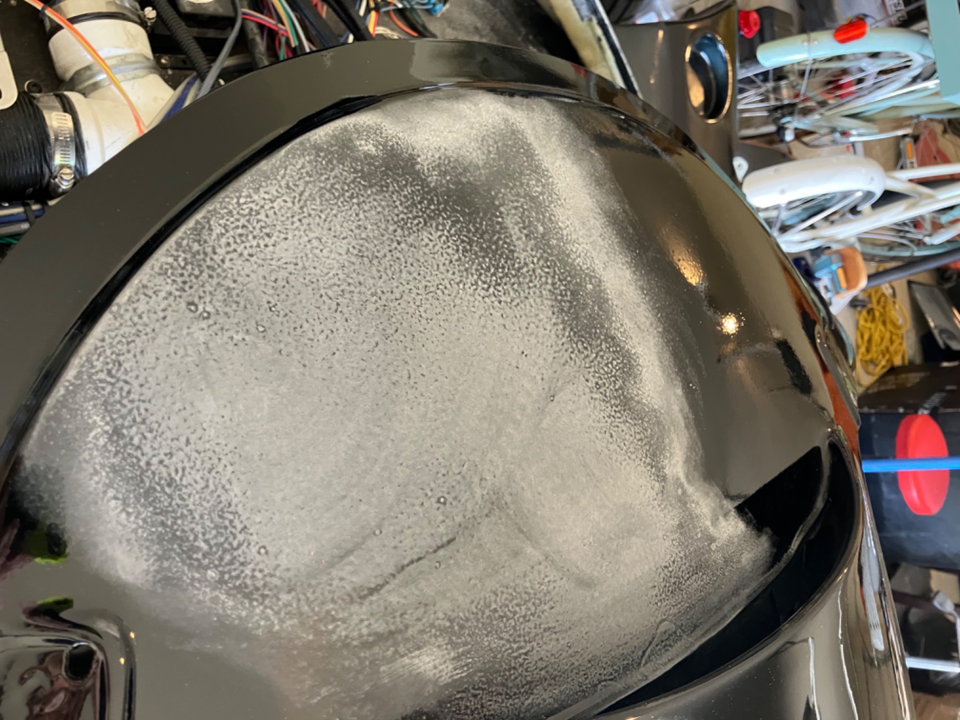

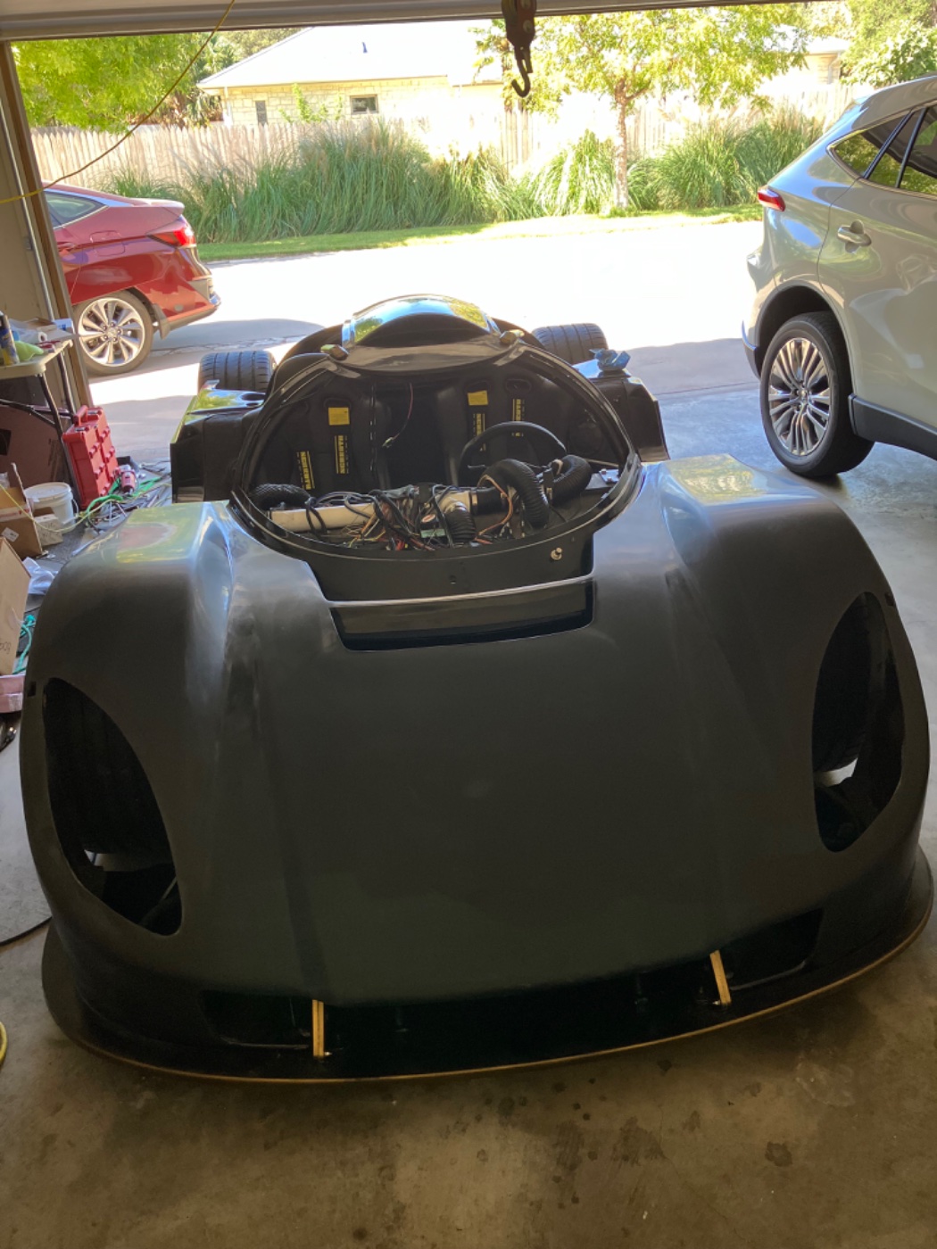

Well , just when you think you are almost done with this project, a butt load of things show up at the end, I have not posted an update for a while, so here it is .
Yes, decided on a cheap paint job, and let me tell you, I got A SUPER CHEAP paint job, the good news I learned a lot about paint correction, getting rid of orange peel , fixing defects , fish eyes , trash, you name it. I found a system that is much faster and easier than wet sanding to get rid of orange peel , i used a ton of sanding disks Kovax Super Assilex K-1500 (the pink ones) and got really good at it, since I had to do every freaking nook and cranny. Those sanding disks are amazing .
At the end and after hours and hours of sanding and polishing, I am decently happy, definitely much better than plasti dip , but the elbow grease needed to make it look decent was absolutely insane. A recurrent theme for me . LOL

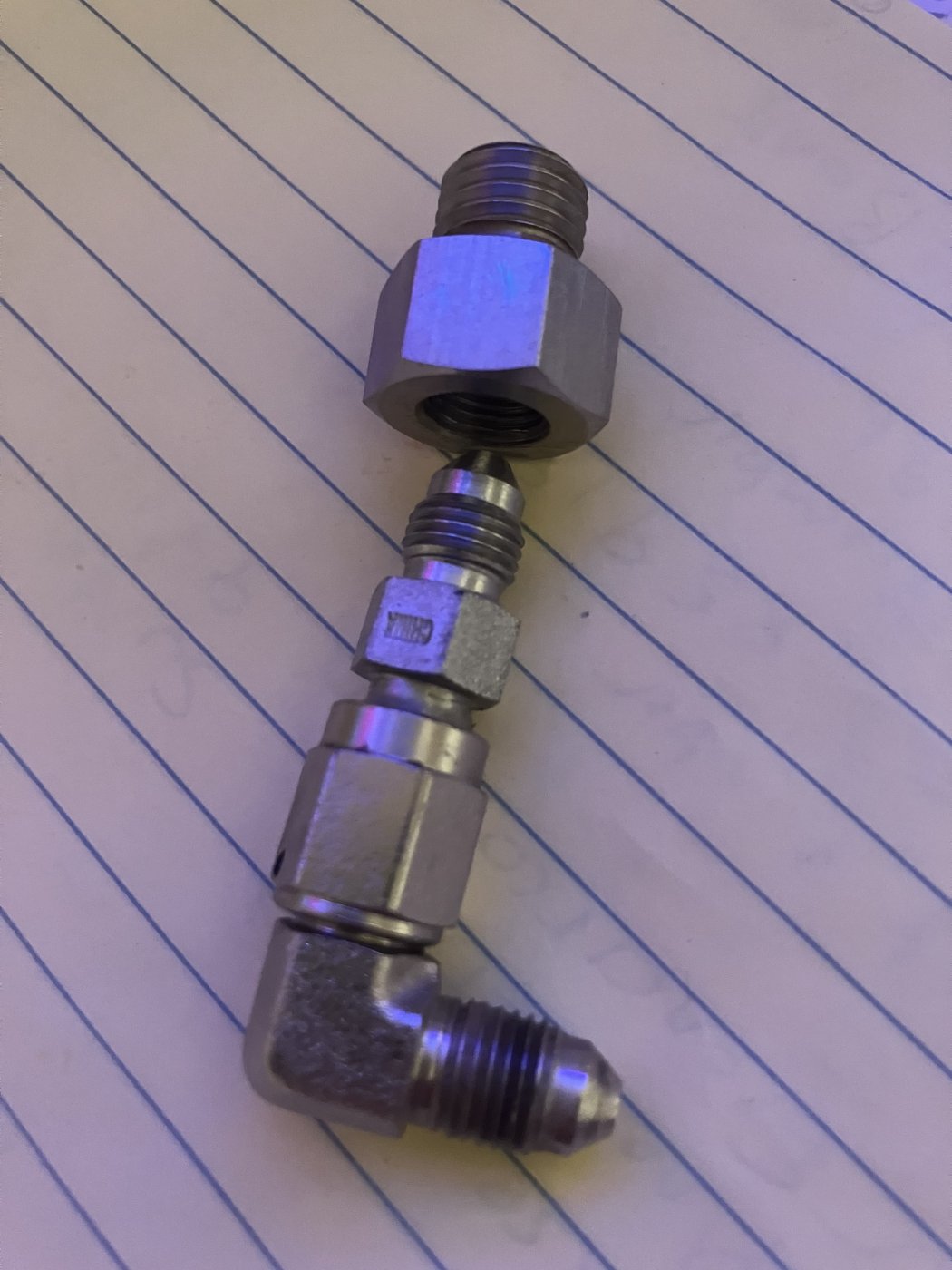

Hector

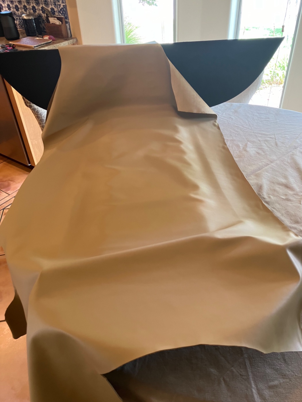

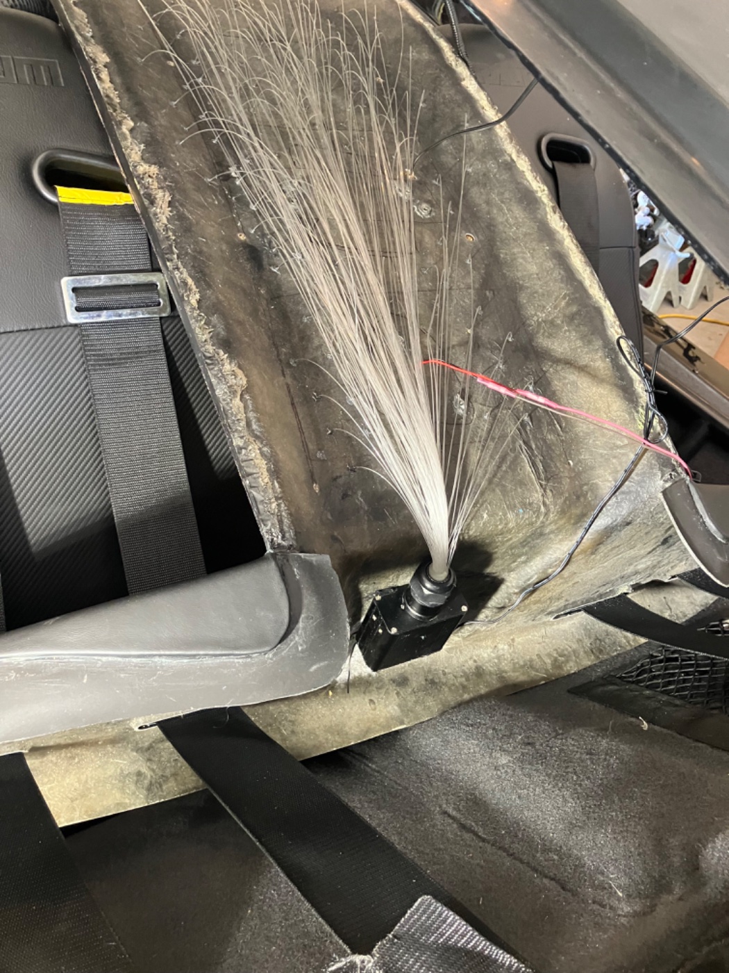

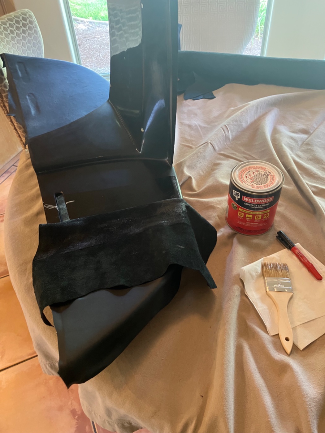

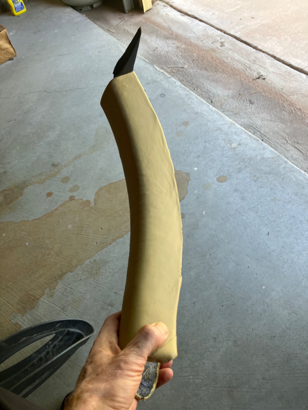

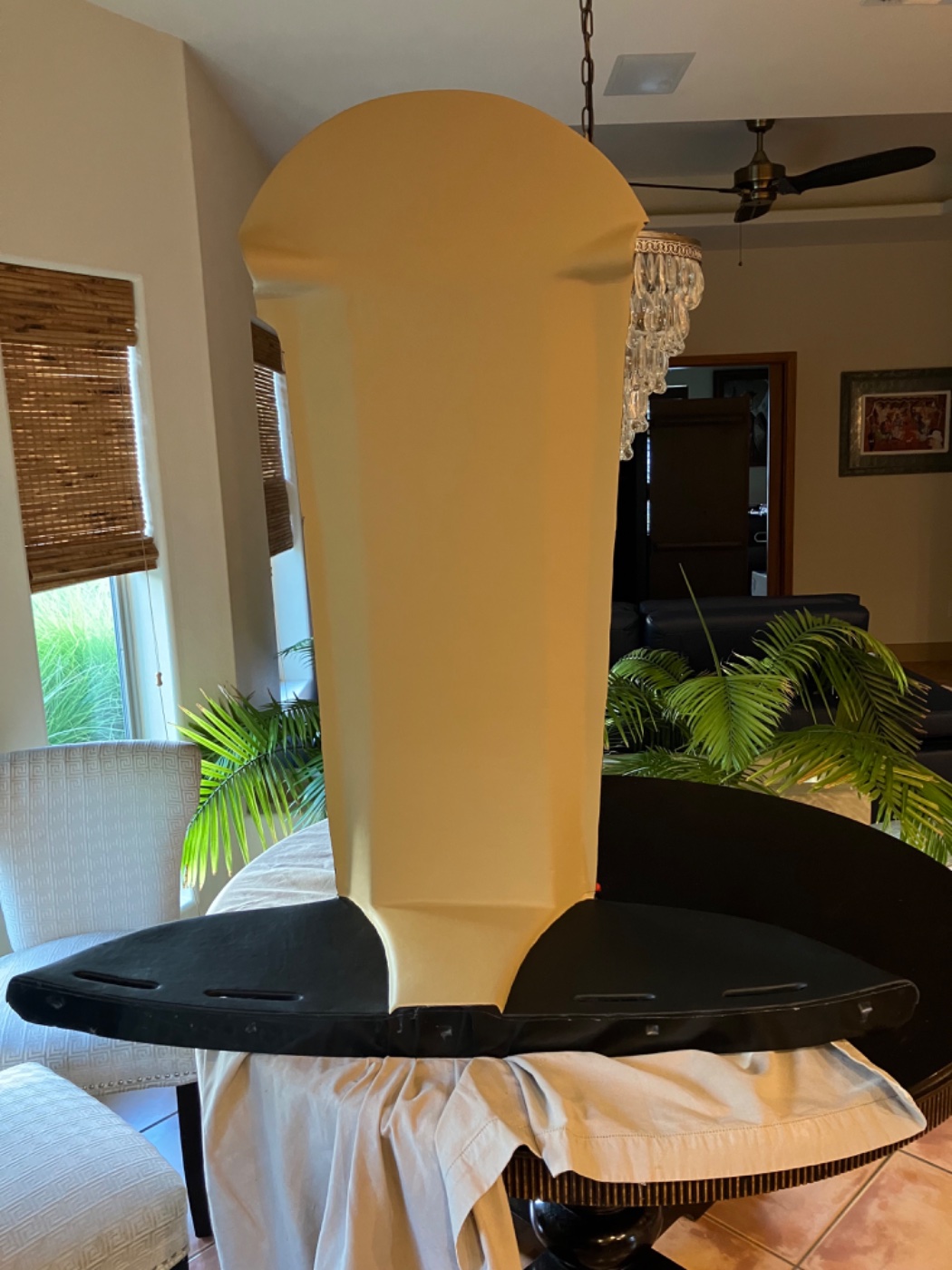

While I was waiting for the paint job, there were a few smaller projects that needed to be done , one of them , wrapping the roof in black and tan leather , as well as the A pilars . Not a bad result for a beginner . navigating steep curves with a single piece is very very challenging . But got it done !!!

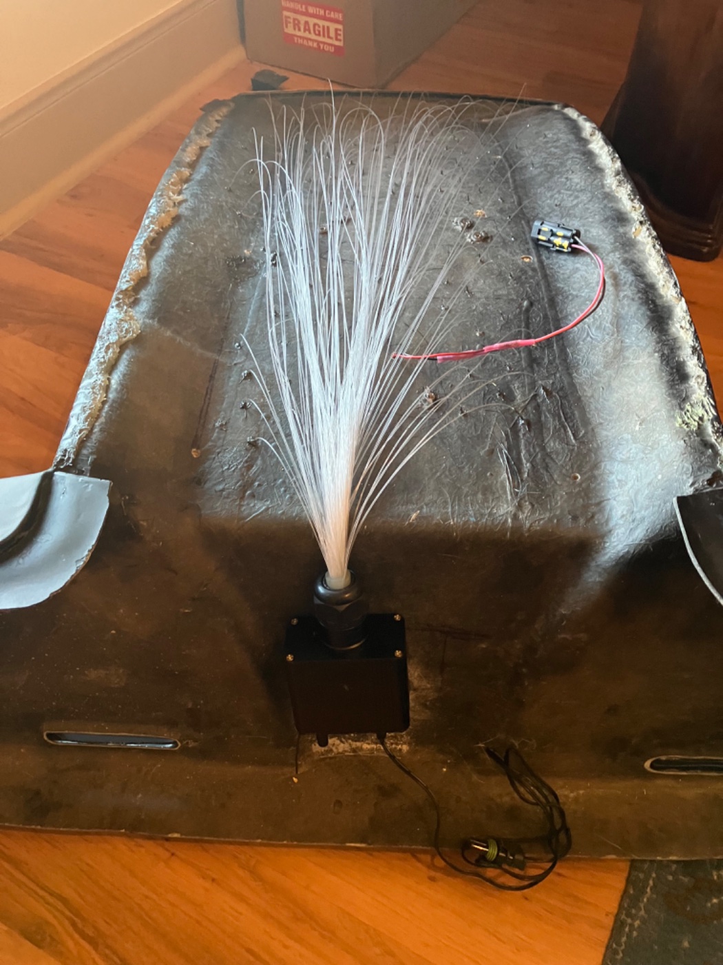

Well , while I was at it , why not do the Bentley thing and add a few stars to the roof . LOL . Call me crazy but those fiber optic lights are super cool , and cheap, I can change colors and patterns with the app on my phone, I absolutely love it , it was my nephew's idea . You have to see it to really appreciate it . Who knew, a superlite with Bentley touches . I will post videos later .

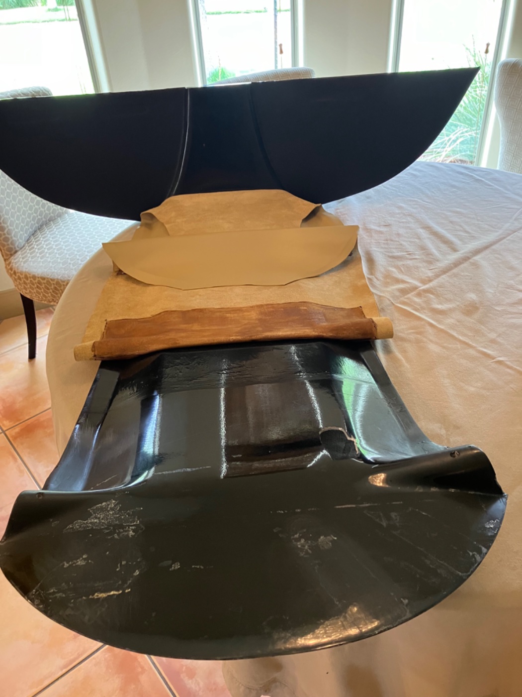

This is exactly my plan for my interior. Good to see that I now know an expert at this process. I will be looking you up for pointers when the day finally comes that I get to this part of the build! Nice work!!
Sorry to hear about you painting issues. Even a decent paint job takes A LOT of prep work which equates to a lot of hours/money.
Doing it myself saves a lot of that cost, especially doing the block sanding. I would certainly not call myself an expert at spraying paint (I am very good at primer and basic paint spraying) but with every car/motorcycle that I paint with the base/clear process I get a little better. My nephew just bought another truck (square body this time) that he is building and already wants me to paint that one for him.
If you ever to repaint your SLC down the road maybe we can work together.
