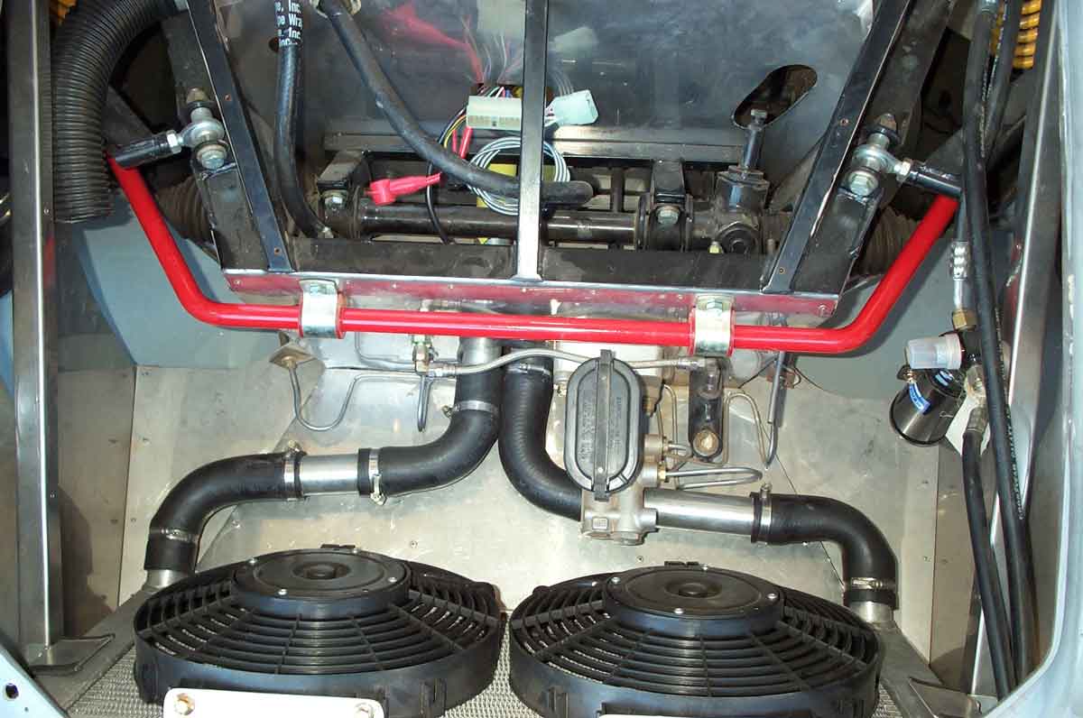

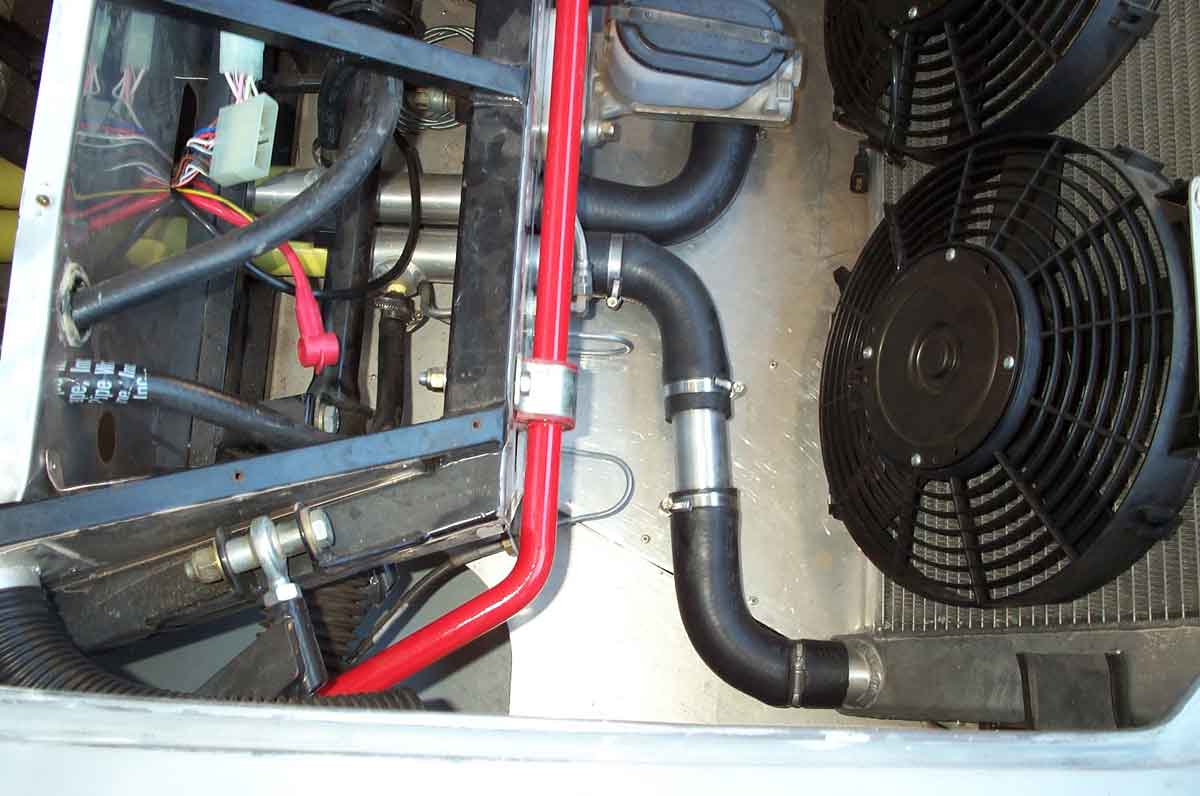

Any pictures of the radiator with the coolant pipes? I would like to see how they attach and route to the back.
Here are some...

nice pics. I am just staring to hook up the radiator. I was wondering which way to route the heater. Thanks.
