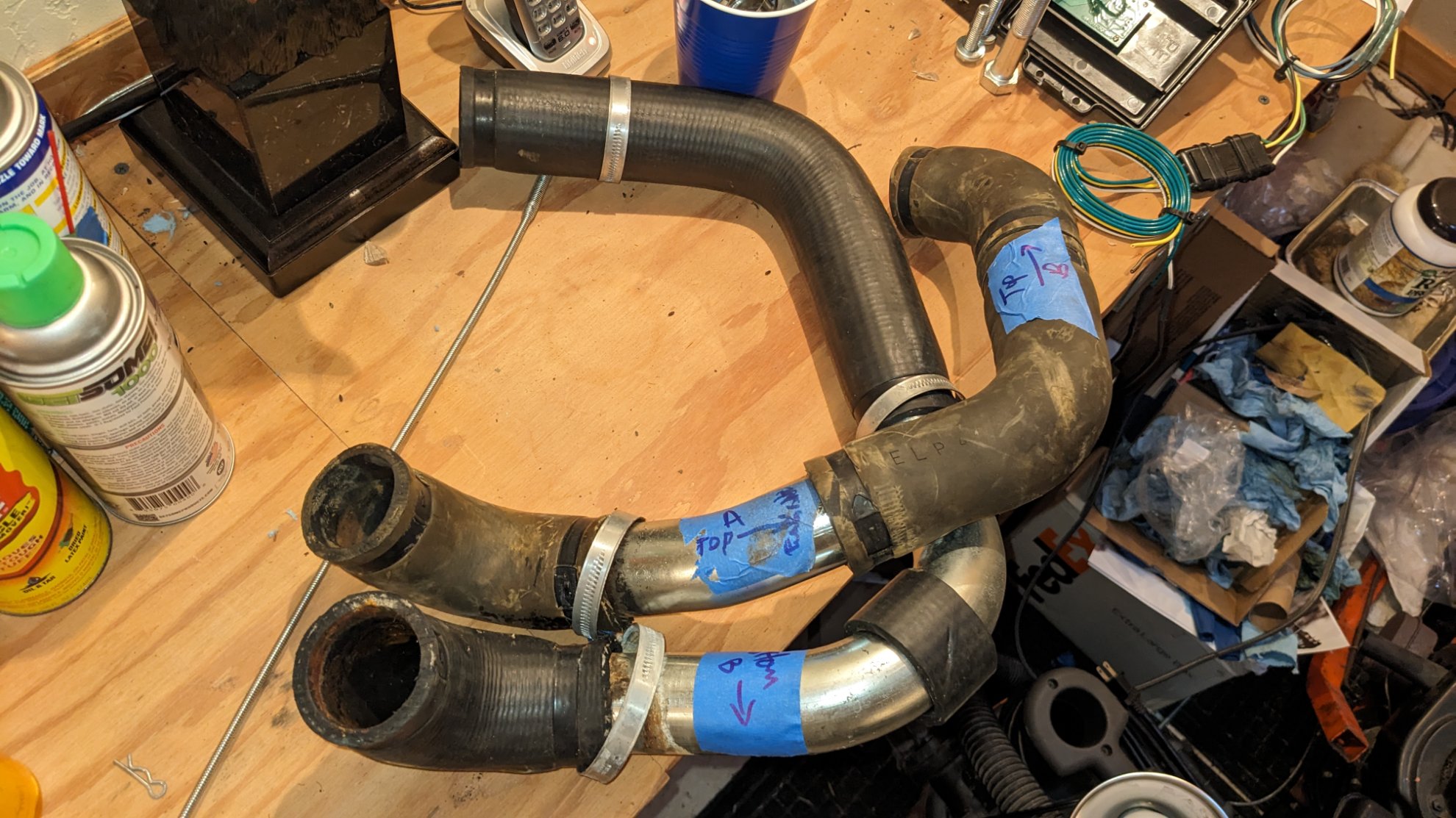

I want to install new coolant pipes in my SPF MKII with typical Roush 427...where can I source these?
Thanks in advance for any advise!
Michael
Mike, I already posted to your other thread, so I won’t repeat, but I will add this. Regarding your center tunnel pipes, you should carefully assess their condition as well as possible. If they’re only surface rusted and otherwise solid, you should consider sticking with them, otherwise you’ll be in for quite a job to replace them. If you decide to replace them, you may be able to buy a set of SS pipes from SPF, RCR or other.
Michael, I will see if I can get those two rubber 90s out of end of the center tunnel to access the pipes. Not sure if I can continue too far down this coolant leak rabbit hole.
Brian, thanks. I will check it out. Looks like I need to develop my own custom hoses. This should be interesting.
I do have queries into SPF and Olthoff to see if they have bits known to fit.

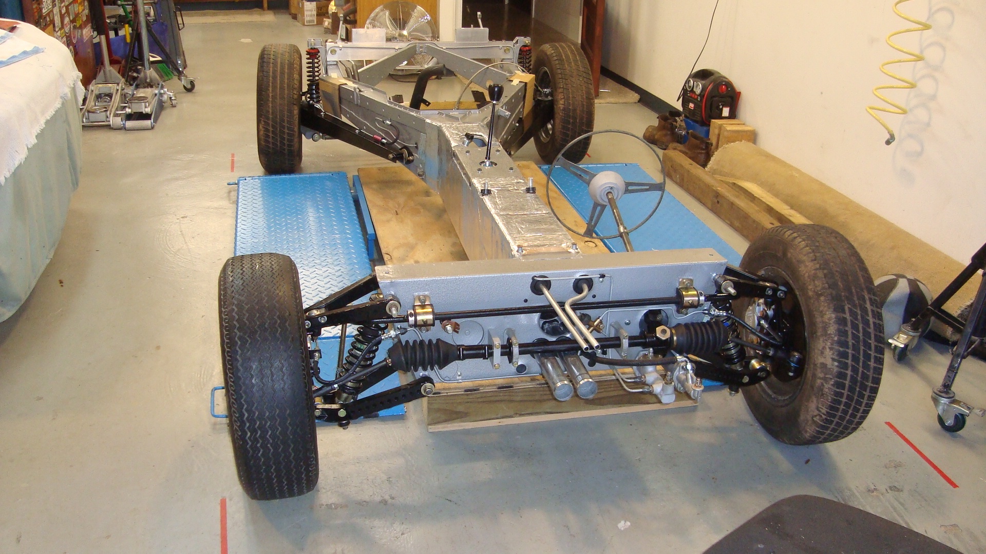

I built a mid engine V-8 Lotus and used plain steel exhaust pipe, had them ceramic coated by JetHot, same coating used on headers. You can just see them peeking out at the bottom of the frame. I figured if that coating can hold up to exhaust heat and its' velocities, water with antifreeze at lower velocity shoud not be an issue. Have never seen a JetHot coated header rust, the ones I have on my GT350 race car were coated in 1985, no rust.

Thanks everyone. I now have some ideas to work on. Like most things, I am probably overthinking it. One pipe I am replacing is welded from pieces bent at different angles...breaking down the segments of the pipe, it wouldn't be hard to replicate it out or three silicone hoses or to find a local exhaust shop to do something similar. I was just hoping for a quicker solution...

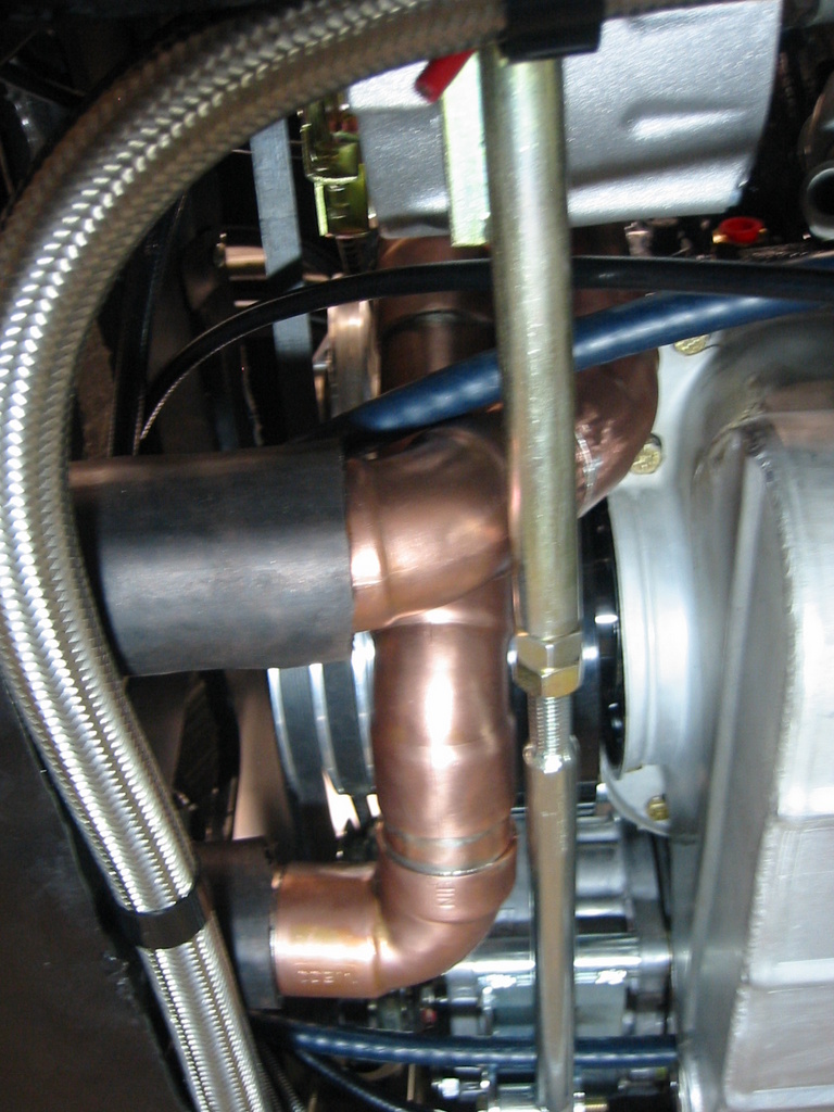

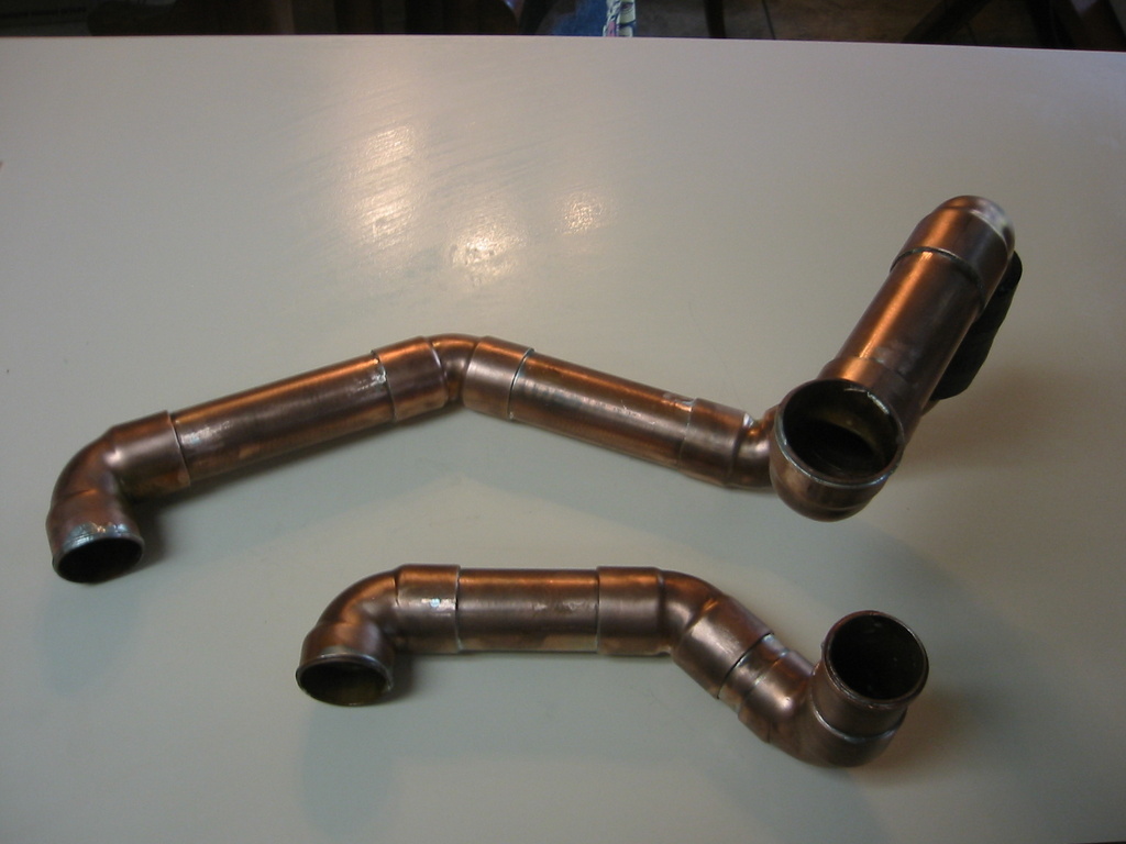

Some time ago a forum member did some coolant pipes in copper.
