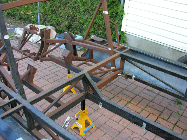

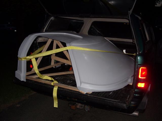

And now the fun begins, so they say. Currently researching photos of Type "C" chassis to restore my ICW back to original spec.
Some background history, it appears that the body panels and my new chassis were one and the same but were separated back in the 1980s,
having them back together is some sort of kar-ma (pardon the pun).
I should have more pics up including SolidEdge CAD drawings as I intend to
document the chassis and associated modifications as I go.

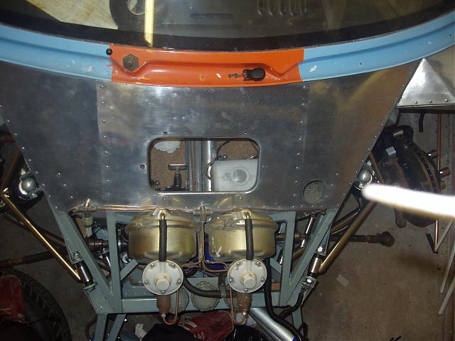

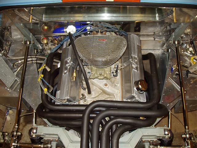

I have been finishing off my KVA for the last 18 months and getting close to the SVA......only a couple of small jobs to do........
Rich
Hi Frank
Only a couple but i like all the shiny bits......plus a big tasty lump
Rich

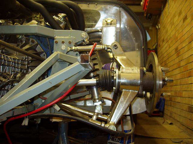

Hi Rich:

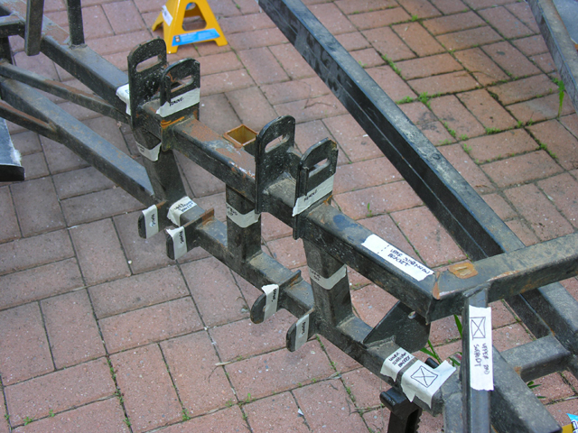

One thing I had to find out is the measurements for placing the upper and lower radius rod brackets on the B-pillar upright post, any ideas?
In addition, what is the distance from the floor to the horizontal brace linking the two B-pillars (just under the bulkhead rear window) ?
Rick (F3L)

The thing is what datum are you using? the window can change position as well as the floor, the only constant is the ground. Give me a call if you want a chat, the floor in my car car is 5cm lower and the front pedals are forward, i am 5 11 and will have to pull the seat forward to reach the pedals.
Rich
Rick
I just read your question again and yes i will measure any distance for you, the car is in the air at the moment so i don't have a datum to work from unless you pick one.
Rich
PS My car was mostly built by a racing fabrication company and they have done a few mods as well as fantastic ally work.... i wish i could take the credit
Rick
If you are into KVA's the you will notice that all the wishbones/uprights are light weight bespoke items.....like a lot of the rest of the car. I will send you some more pictures but please don't get upset at their workmanship

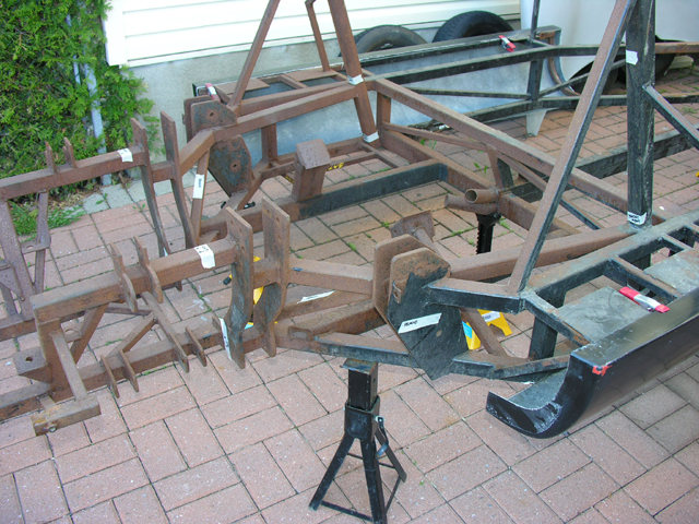

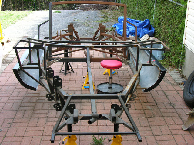

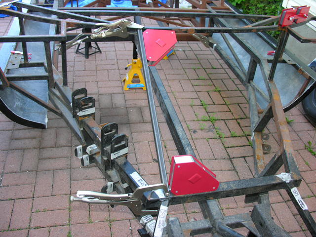

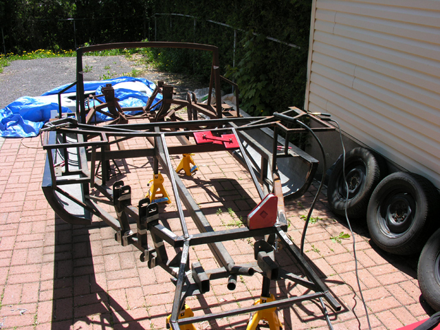

Further progress... "x" marks the spot, that is, the 48 feet or so of 3/4" tubing
Much thanks to everybody so far for the great reference pics. This week is the fabrication of the 1.5" square tubing front shock uprights.

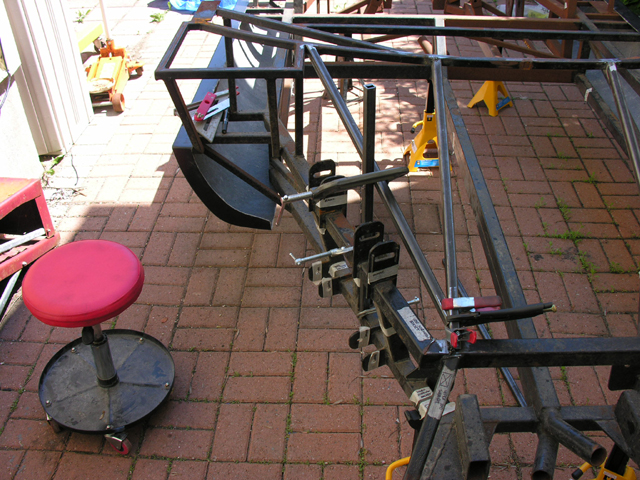

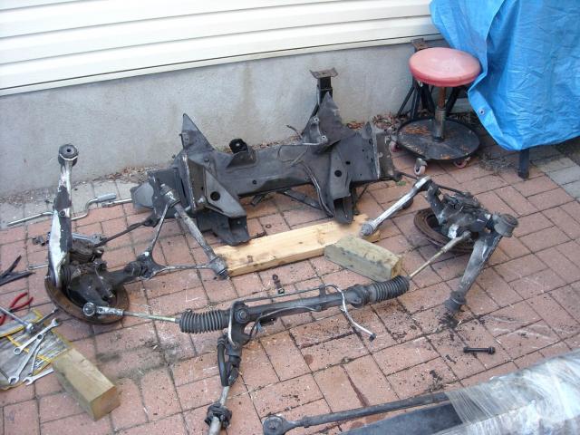

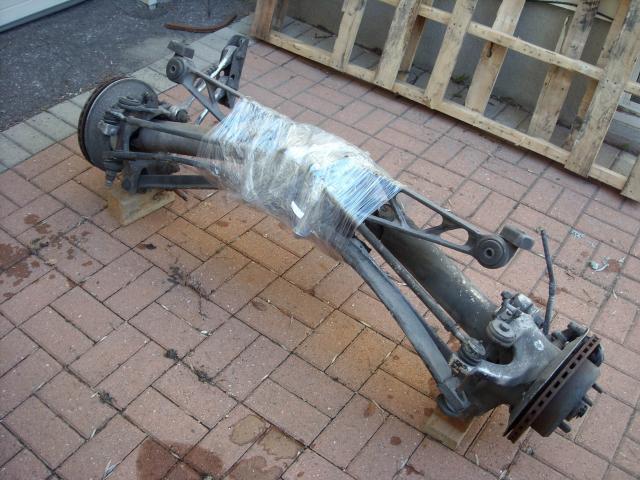

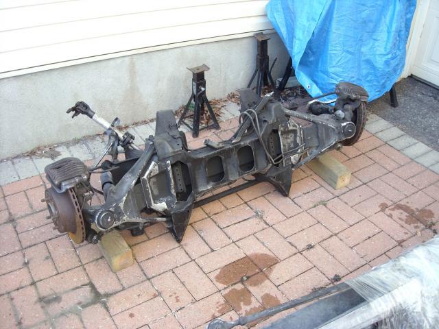

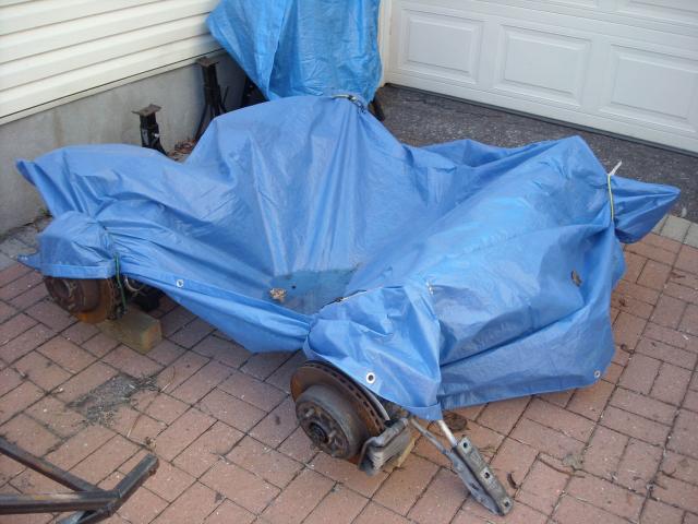

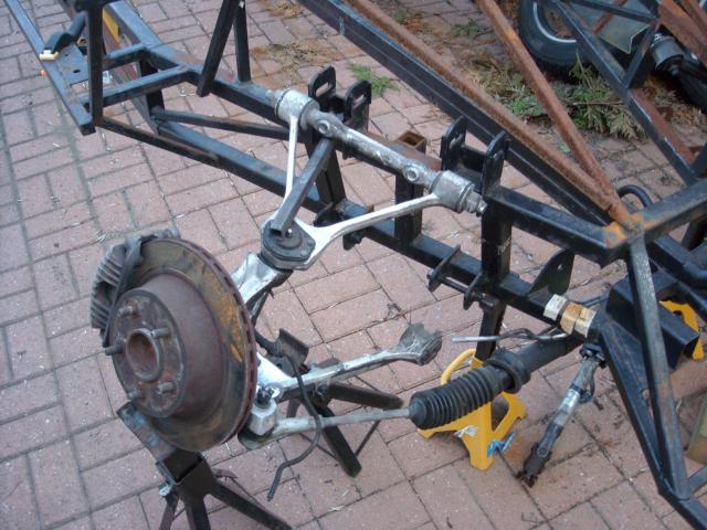

Finally time to finish off the car.
Just purchased and received complete front and rear C4 suspension components, I'm now drawing up plans to construct front and rear suspension using reference pictures from Larry's Intergrity Koach Works GT-40 in Houston (thanks Larry!).
Sourced an engine ('68 Ford 302) and transaxle (Porsche) so making headway on many fronts.
I don't mind constructing from scratch but if anyone knows where an extra set of front IKW A-arms are, please feel free in sending me a message as I would be definitely interested :)
The last pic is a temporary placement, just to sketch out what needs to be done before sending off the chassis for further welding / media blasting / painting...
Next month sees me down in Maine to visit Jay to pick up some stuff, looking forward to that.

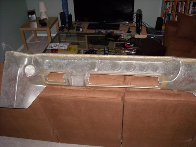

More components for the build, courtesy of Jay :)
I've been waiting for a mid-section spyder for eons!
