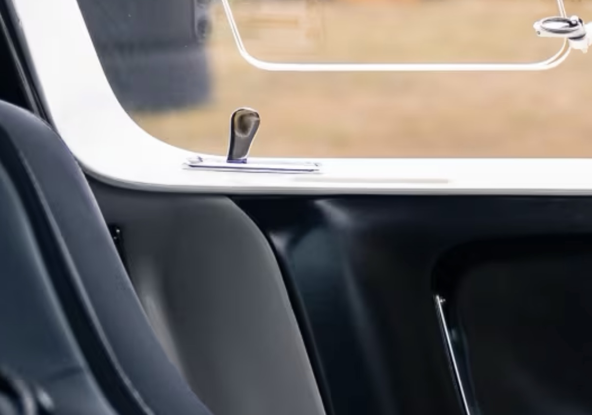

J James Oct 31, 2025 #1 Does anyone have detailed pictures or dimensions for the interior chrome door latch release and plate? I think I’ve only seen these on the road cars. I’ve been able to source most all the other parts for the original door lock and latch system, and want to get the interior release right.
M Morten Mortified GT Supporter Nov 1, 2025 #2 Rover P4, external plate, handle from release tab through top of door, then plate bezel to finish. All info of this is on the forum under originals.
J James Nov 1, 2025 #3 I’ve got the correct door latch, striker plates and everything else, but I’m looking for the chrome release handle and bezel. I might be missing it, but those don’t look like they came off a P4 Rover. Attachments IMG_2432.jpeg 106.5 KB · Views: 122
Ian Anderson Lifetime Supporter Nov 1, 2025 #4 Tornado do them https://www.tornadosportscars.com/GT40/partslist.html 40-84
M Morten Mortified GT Supporter Nov 1, 2025 #5 easiest is to make your own lever and plate. Lots of photos and few sketches around.
