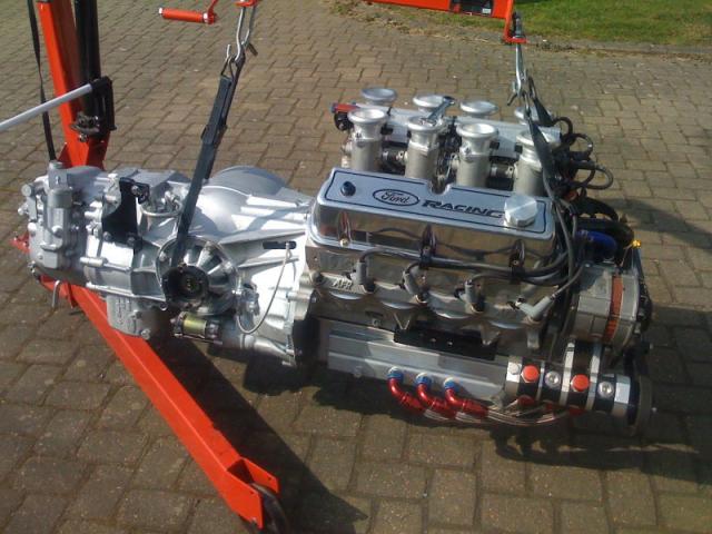

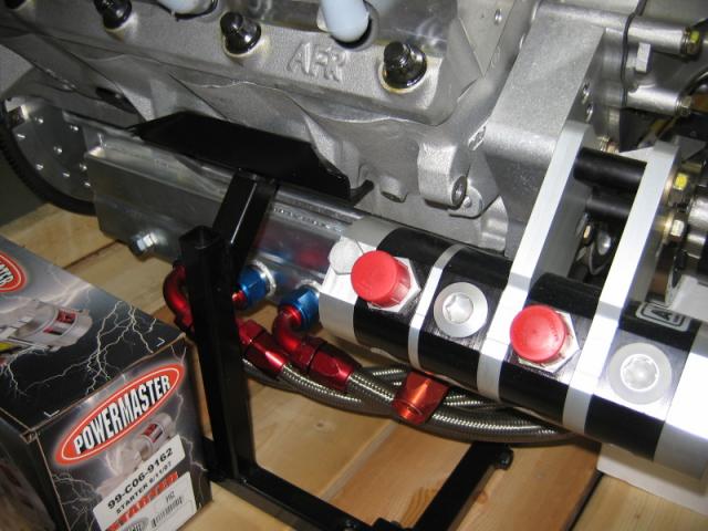

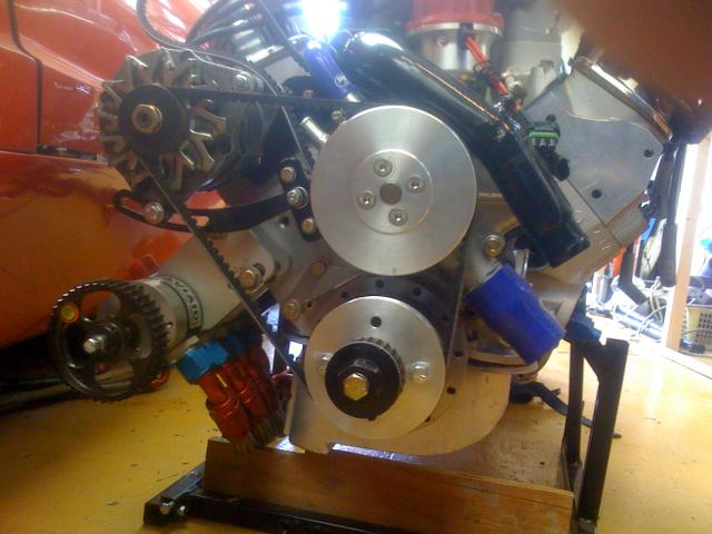

Hi Urs, for the GTD we've fitted an alloy Roush 427IR to, the chosen drysump solution was supplied by Aviaid as we have had good results previously with their kit. Pump & pan both seem to fit ok.
It's in the car now so not too easy to get measurements from but perhaps the pics will help. :thumbsup:

The sump was on but the pump was not positioned in required manner so we set position and piped up. I'm not sure whether Roush dyno'd the engine with or without the dry sump setup installed or installed it afterwards...
