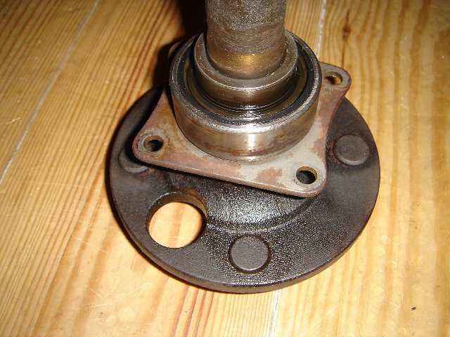

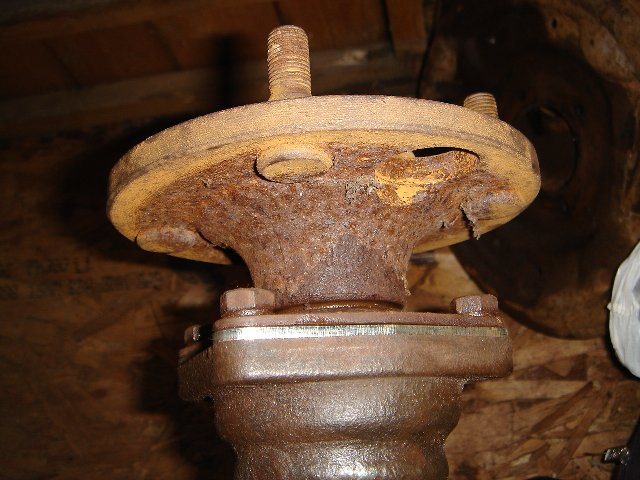

Pictures paint a thousand words.....
Atlas axle half shaft before and after. Two hours in the solution and the current was around 1A. The shaft was rotated 180 degrees after 1 hour to ensure even rust removal.
Cleaned with scotch bright, dried with the better halfs hair dryer (dont tell!!!) and sprayed with WD40 and cleaned again. The axle was immersed to just below the bearing (about 2mm off)
I will do the other one tomorrow.
