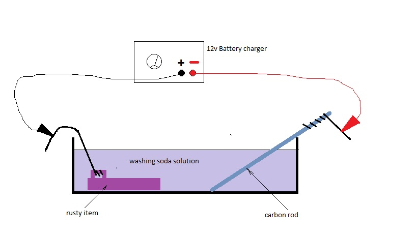

Connect the carbon rod by wrapping the iron wire round it tightly and put it in the washing soda solution, keeping the connecting wire out of the liquid and connect it to the red wire from the battery charger which is positive and this is then the anode +ve.
Connect the part you want to derust to a piece of the iron wire making sure that it makes a good electrical contact. This is then connected to the black wire from the battery charger which is the negative and this is then the cathode –ve.
Switch on and you should see bubbles of gas at both the carbon rod and the rusty part. These gases are hydrogen and oxygen caused by dissociation of the water molecules which can build up and are explosive so do this outside or in a well ventilated area. Oxygen is produced at the anode (red) +ve and hydrogen at the cathode (black) –ve. Naked flames or sparks are obviously a bad idea.
The current travels in a straight line between the two electrodes so you will need to move the carbon rod around the part to even out the derusting over the part. Make sure the carbon rod does not touch the part and short out the battery charger. Leave it running until you see the red rust disappear or chang to black. When ready switch off and remove the part and give it a good scrub with a stiff brush, scouring pad or wire wool to remove the black residue (iron oxide). The red rust has been converted from red rust to black iron oxide. If any rust remains repeat the process until all the red rust is gone. Badly rusted parts will still have pitting where the rust has eaten into the metal. The metal will now need some protection to stop it going rusty again.

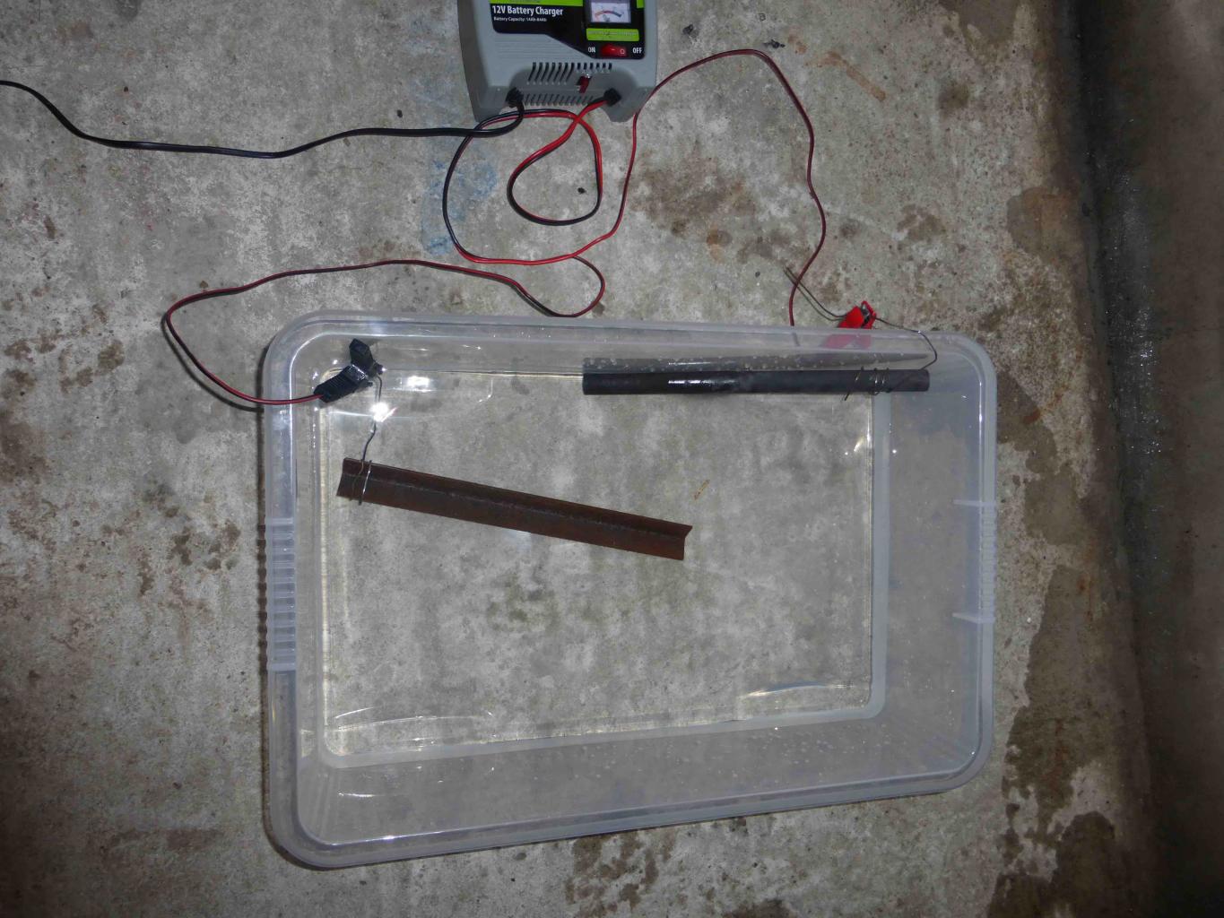

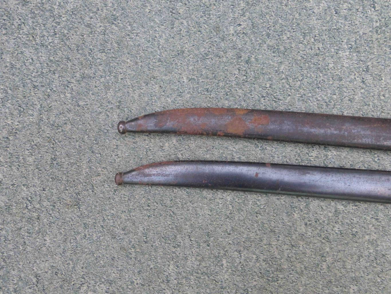

Some photos attached of the set up and some before and after pics. After derusting the items were treated with cold gun blue and wax.

they look like the scabbards for a Chassepot bayonet.
Your system is an excellent one, but I would warn those who use it on Antique items that you could devalue the piece by removing the rust and leaving visible pitting. There are ways of neutralising rust without unsightly pitting and retaining character and that all important patina.
Patina is everything with antiques, and once removed can not be replaced.
Forty+years in the Antiques and specialised restoration trade.
Mike Pass
Hi Graham,
You are spot on. They are indeed Chassepot bayonet scabbards. I tried this method as it does not remove the original blueing. They are not very valuable so not to worried. They are a lot better now as they were left to rust away in a wet garage when I found them. I would be interested to hear of other methods for removing rust and keeping the patina of similar items.
