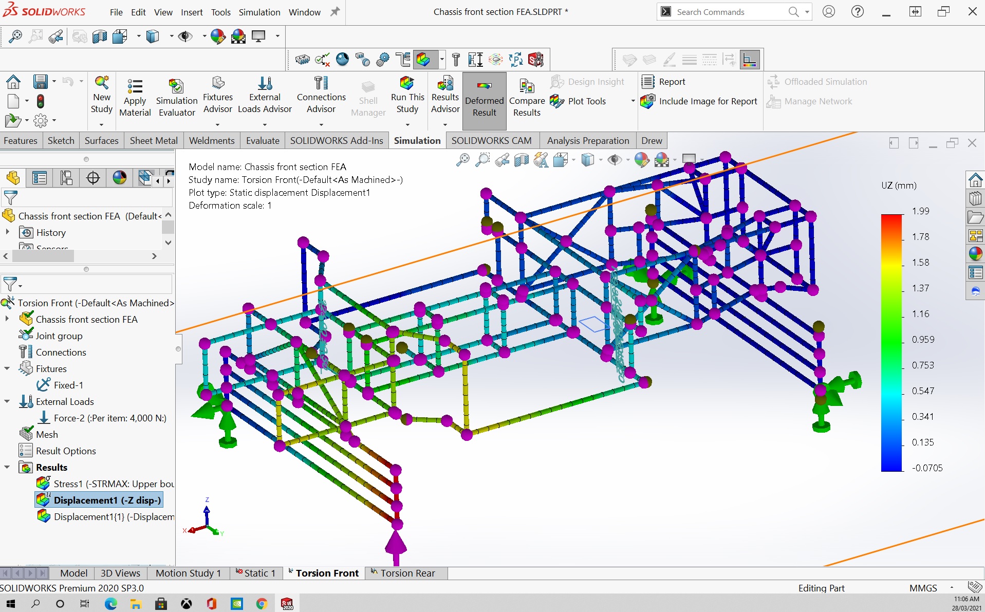

Hi Clive, it looks very weak in bending have you done any FEA work, to look at other load cases? I assume you are not using the roof as a structural member?

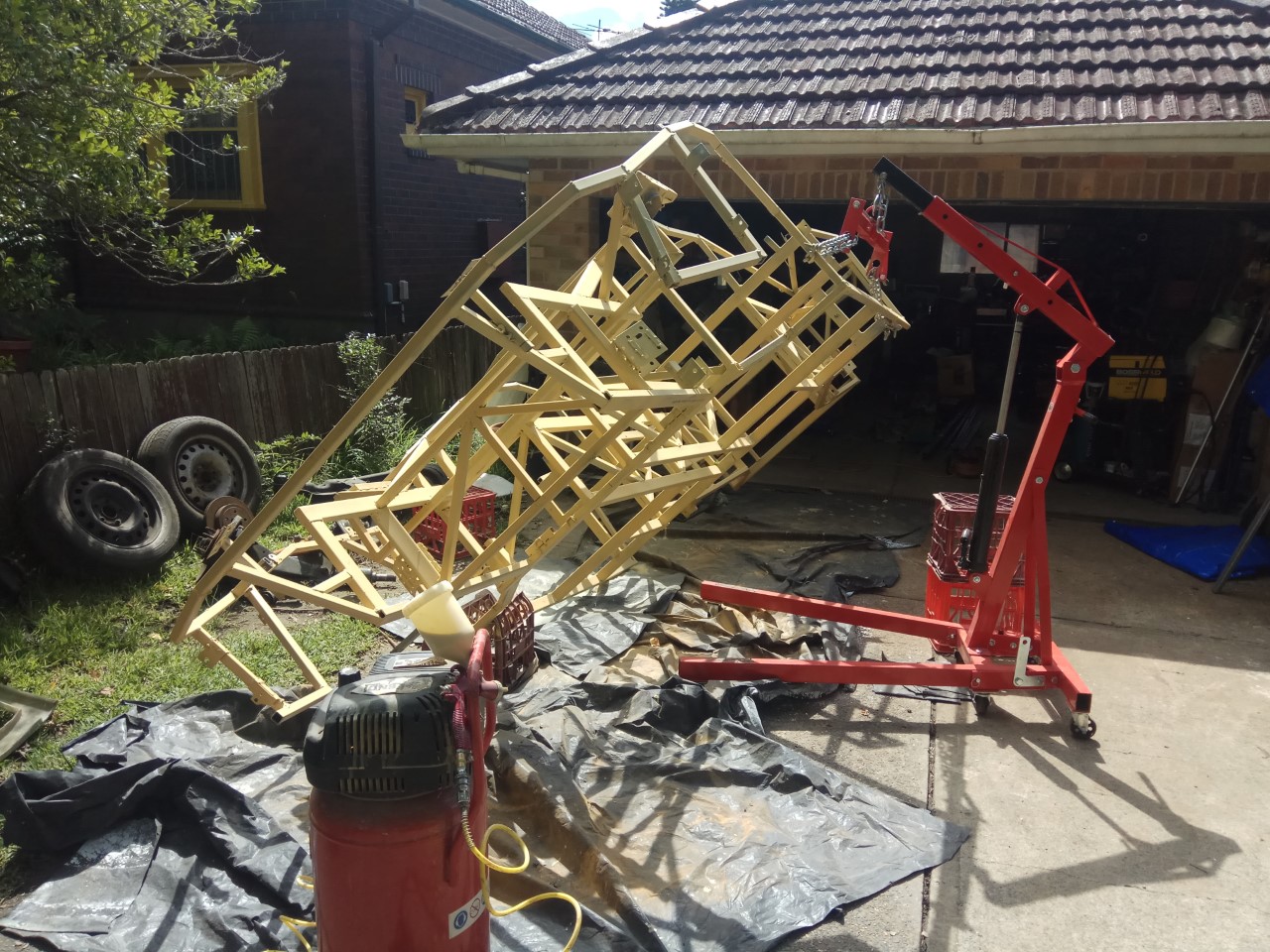

Im assuming you mean the large floorpan area is very weak? This is yet to be filled as seat mounting tests are rather stringent and the seat runners will need to be firmly mounted to the chassis members (50x25x3mm). Will be adding these when I decide on the seats I will use.
The centre backbone (within the passenger cabin) is also braced on my actual chassis as well as front and rear firewall crossmembers to channel strain through trussed members (triangulate squares!)
I did revisit the front torsion test (from post 20) this used 8000N force rather than the 4000N requirement. Have re-posted the correct one here.

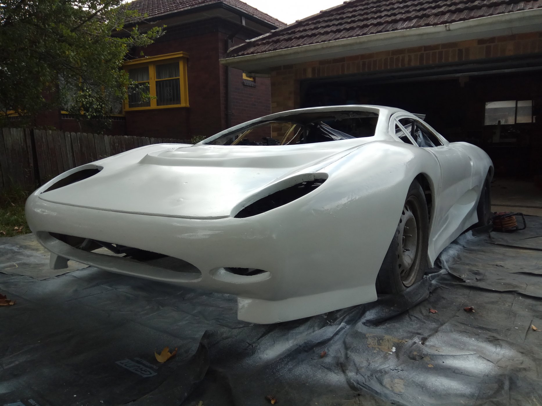

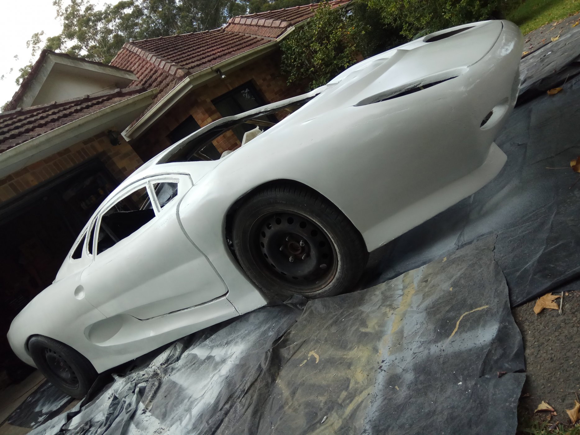

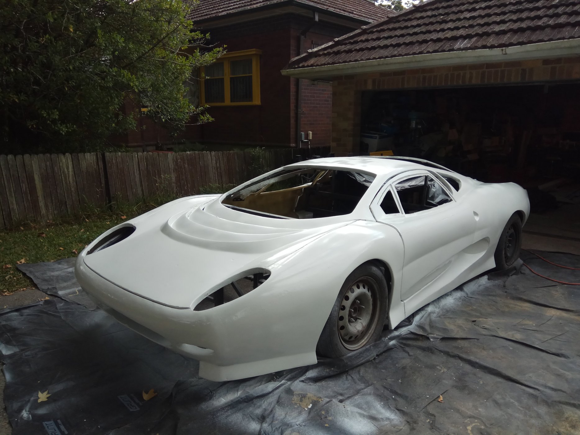

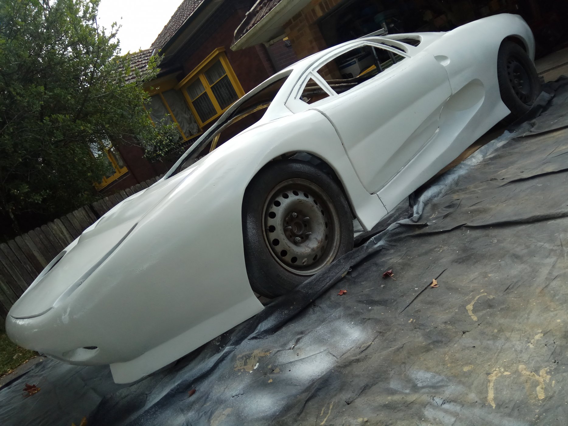

Here are a couple of pictures, have epoxy primed the car and temporarily fitted the doors, boot and bonnet. Im now fitting hinges and gapping the panels before applying high build primer and blocking.

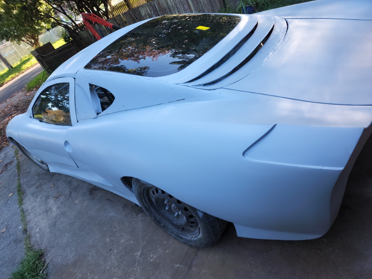

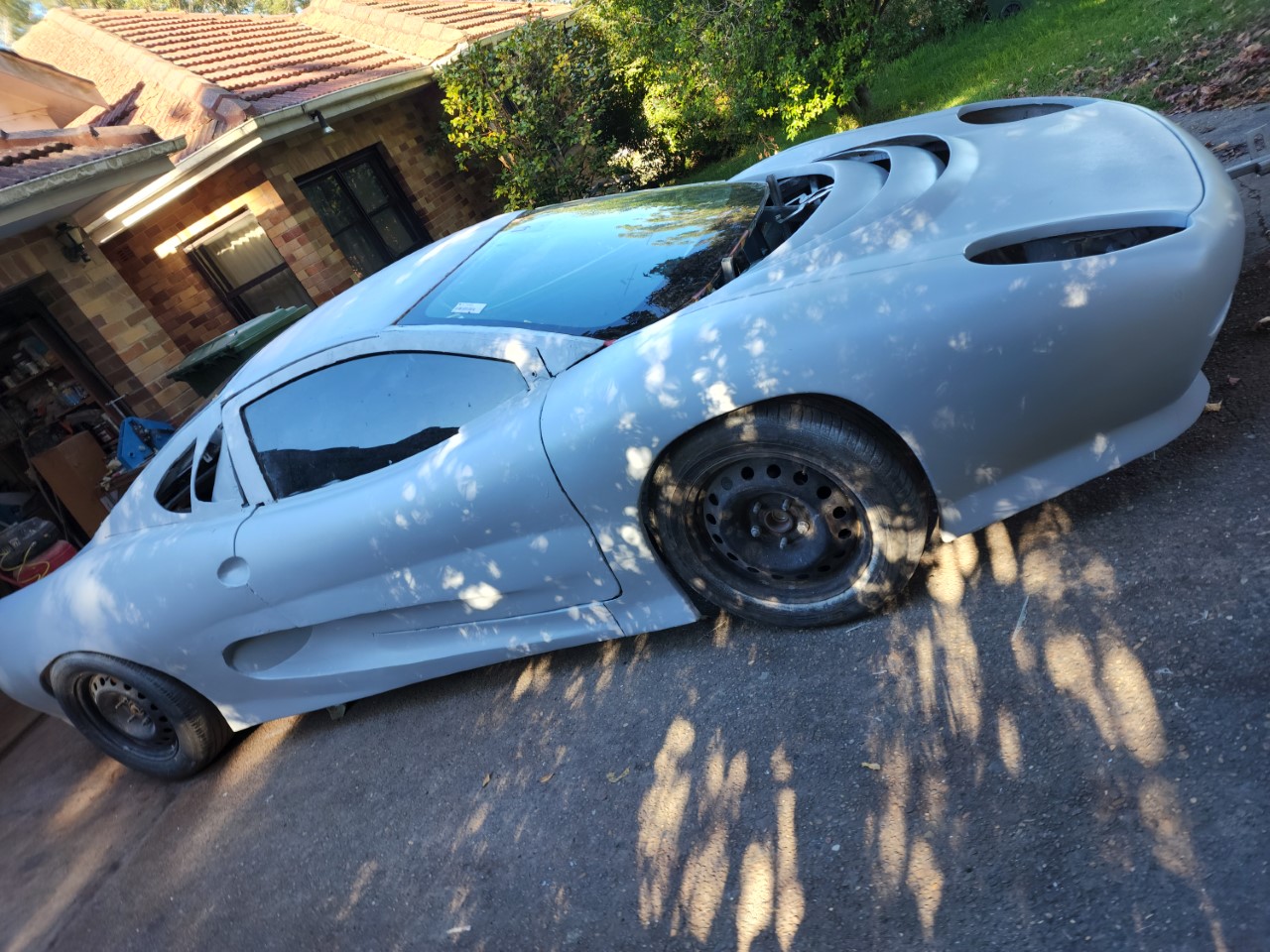

Got the windscreen, hatch and door glass in! Have had big problems with the windscreen and door glass, this is version 2 and have spent lots of time trying to fit it. Its not quite complete yet, apologies for the gaps and some panels, these still need much work.

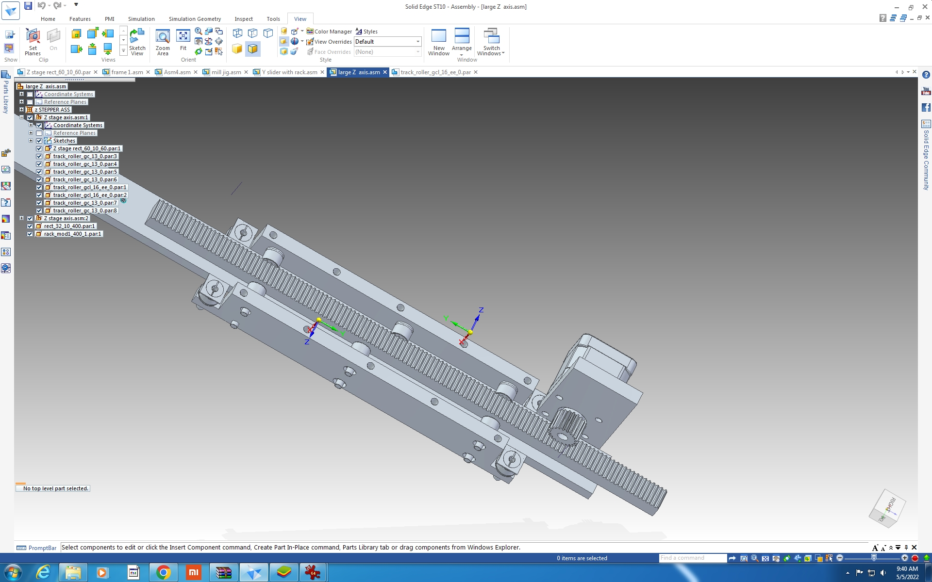

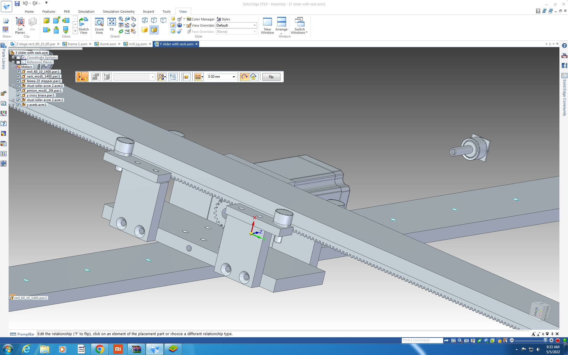

Someone asked a question on the CNC router I built for building the panels. Here are a couple of pictures of the Z and X axis which will give a better idea of how its built rather than a long explanation. Here are a couple of key points:
I used a 'mod 1' (fine pitch) rack and pinion for the X,Y and Z and the smallest pinion I could find that fit the shaft of the stepper.
Bearings were 'cam follower' type bearings and aluminium bar as the guides for the axis.
Stepper motors were closed loop type - HSS57.
Software to run the CNC used was Mach 3.
Screws for assembly were metal self tappers (into aluminium, used lots).
Design aim was for a large format, high speed and foam cutting only.
Things to improve:
Increase the length and strength of the roller guides and rollers. These undergo a lot of leverage especially at high Z lengths.
Use eccentric type cam followers to adjust for zero lash.
Use lighter spindle with larger diameter bit, max size atm is only 10mm.
