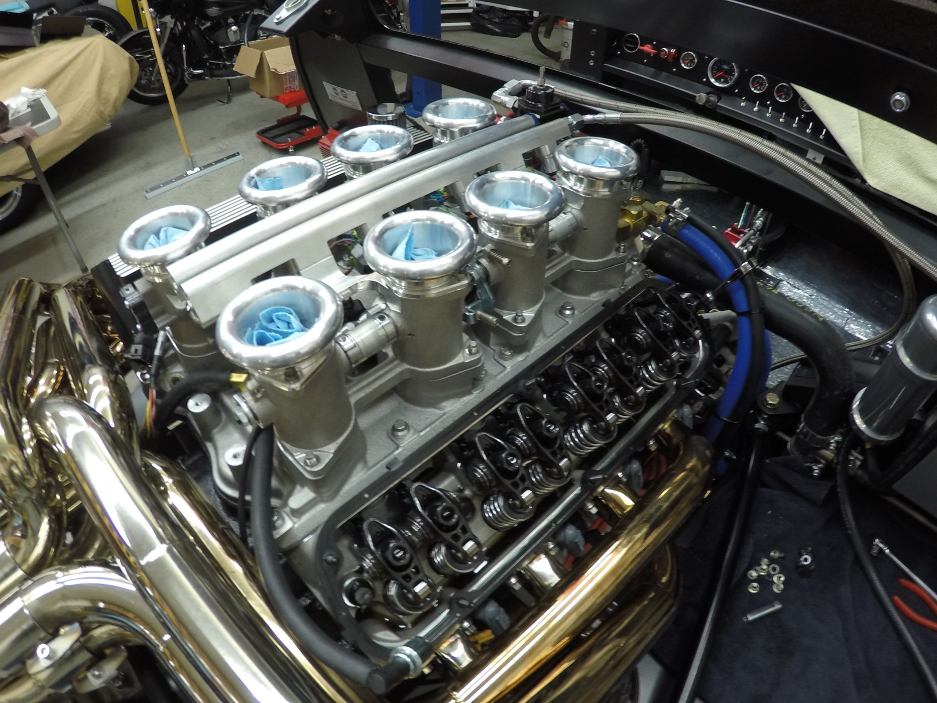

GT40s have a very long cable and when Borla 8 stack is used you have a very heavy throttle.
I also have concerns of cable issues.
My head is working on some sort of assist system that will take some of the load off the right foot and cable.
Ideas welcome !!

I'd like that Brian but never heard of it being used with the 8 stack. ??
Mark, it's only a matter of pedal travel vs Borla ratio. I'm using all the pedal travel I can.

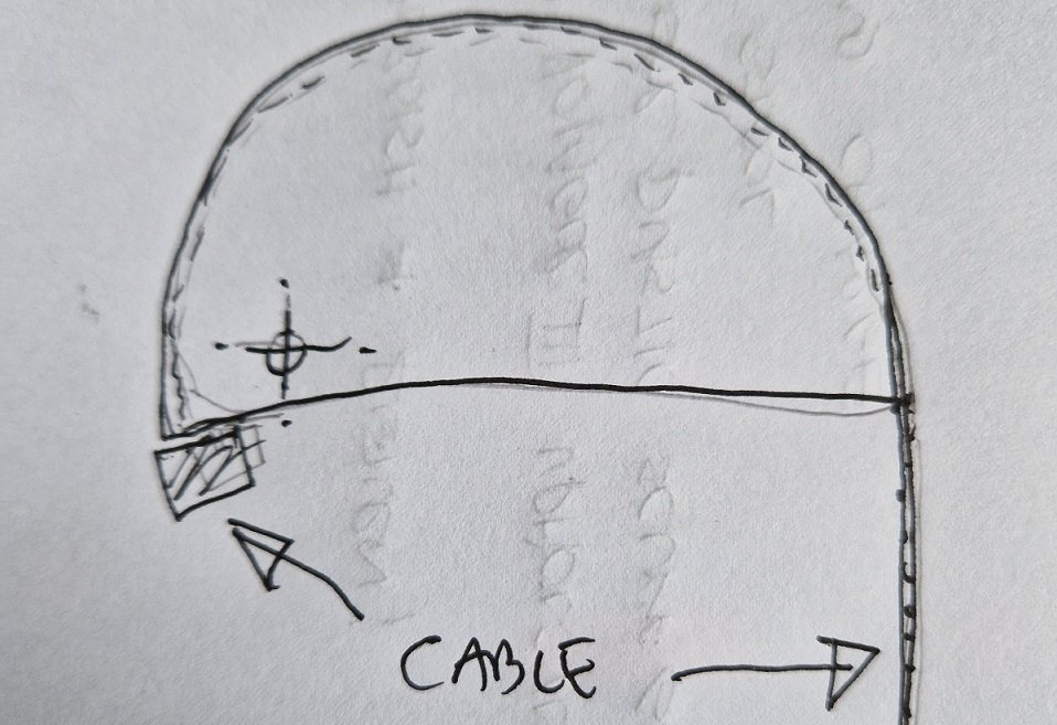

I had that same set up Bill, with the same problems, the throttle was really stiff off idle and in the first opening. My solution, after making sure that the pedal, cable etc was as free and lubed as possible, was to make a snail cam giving the maximum pull/leverage away from idle and reducing towards WOT. (See very quick sketch to save a thousand words.) Obviously adjust dimensions to suit your cable pull etc.
It worked a treat for me.
Bill Kearley
Thanks Glenn, I'll have to give that idea some thought, I like it. I also had the idea of a spring at the manifold end of things to take some load of but that could be very risky !!!
