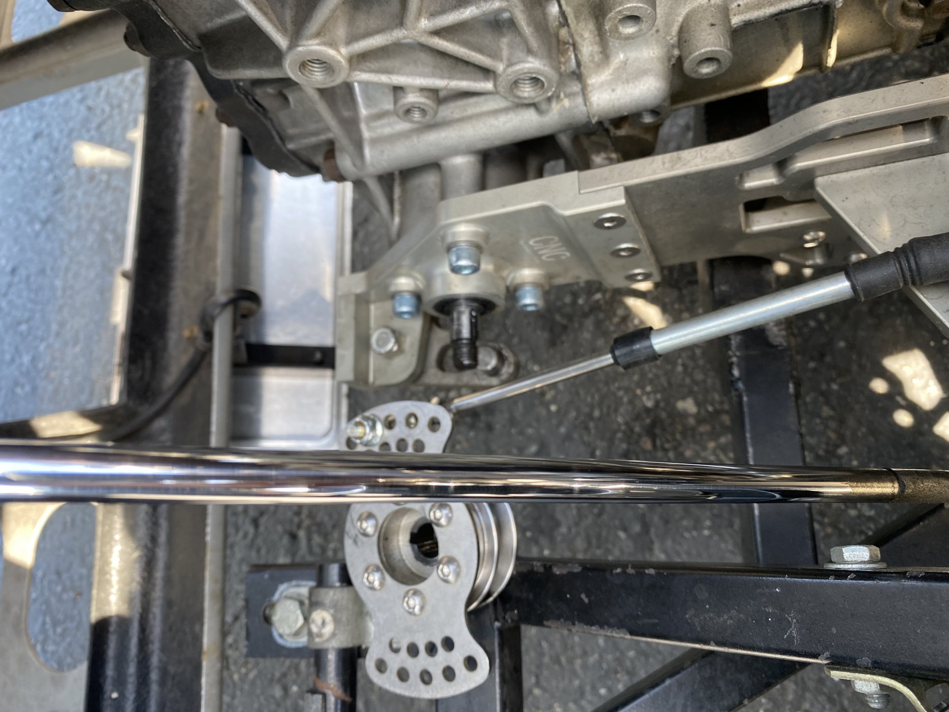

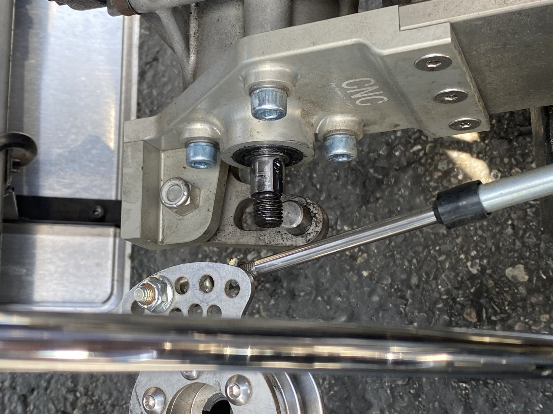

Out for a Sunday cruise and lost the nut that holds the piece on in the picture. Transaxle is a ZF. Can anyone tell me what size nut and key way I need to get it secured? Thanks

Sorry, I can't answer that question but I'd suggest replacing the bolt through the locknut (visible to the left of the ZF shaft) with a longer one. The bolt through a locknut should have at least 1 1/2 threads showing.
Well spotted that man, and turn it round putting the bolt in from the top so you don’t lose it if the nut dose happen to drop off if possible

Can you measure to od of the thread and also how many pitches there are in say 10mm of thread. As ZF are a German company the thread will probably be metric but measurements will confirm this.
Ron McCall
Rick,
The nut is 12mm x 1.5 . Where are you located?
If you are in the states, I can send you a nut and keyway. ( I think I have spares anyway)
