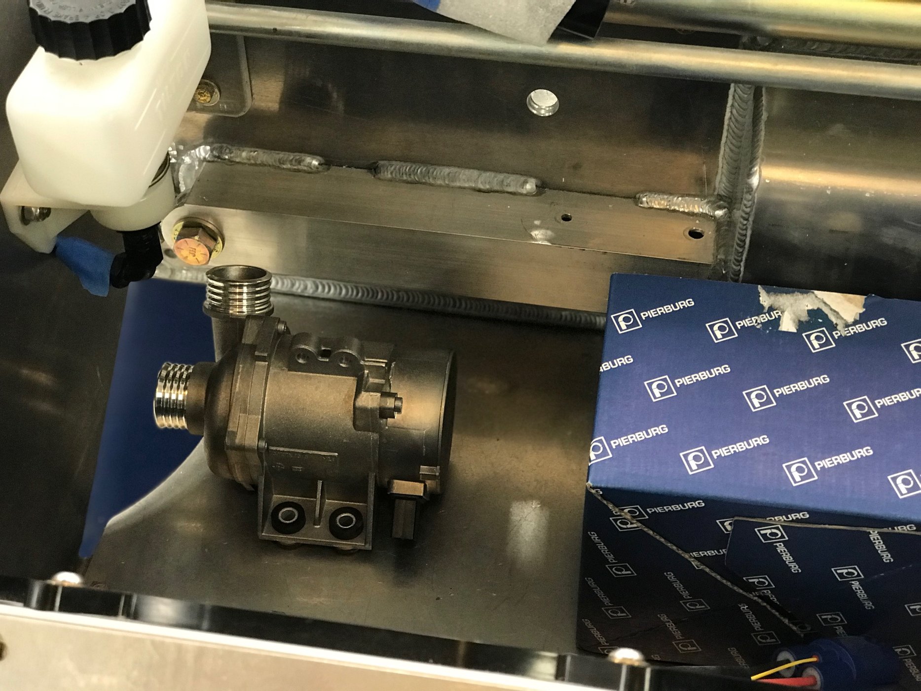

A couple of more points on the Pierburg. If I recall correctly, the race SL-C never had to run the pump greater than 70% duty cycle. Also, there are lots of crap Chinese fakes out there so you need to be careful. The picture below shows how compact the pump is (ignore orientation) and what a legit box looks like.

S2, that is a really nice looking piece. What do they cost?
