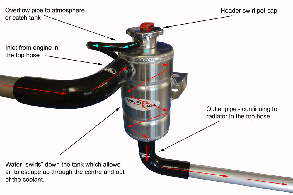

I always like to keep things as simple as possible. Of course, the combination of swirlpot and expansion tank from Concept Racing would be ideal.
In my car, it's all about engine cooling, I don't have heating or air conditioning.
If I understand everything correctly, such a combination swirlpot would be sufficient, e.g. on the firewall, without any further opening in the cooling circuit. Possibly another bleeder screw at the front of the radiator for filling.
The system could look like this:
Engine water outlet -> electric water pump -> up to the swirlpot -> down to the radiator -> back to the engine.
that sounds almost too simple now...
Paul Hendrickx
engine coolant out----swirltank----radiatior in---- radiator out---- water pump as low and close-by the engine...
bleedline from radiator to (with restrictorof 3mm) expansion tank

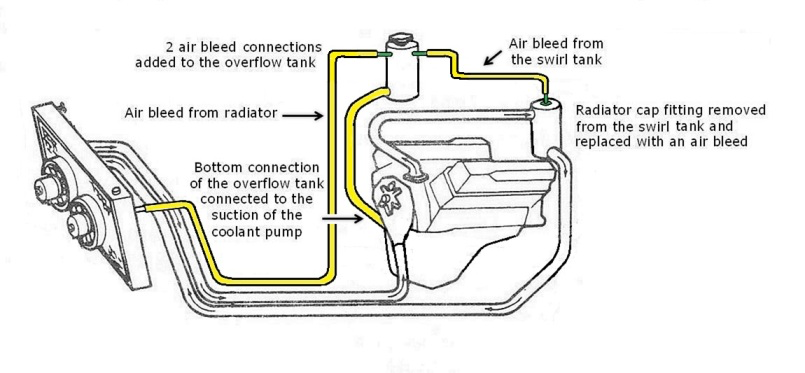

Paul,
Thx for the guidance. I don’t quite understand the connection between the overflow tank and the suction side of the pump. I am guessing there needs to be a way to ensure that it doesn’t cause too much coolant to bypass the radiator loop.
Cheers, Randy
if you connect te expansion tank is to the pressure side you will presurerise the tank.

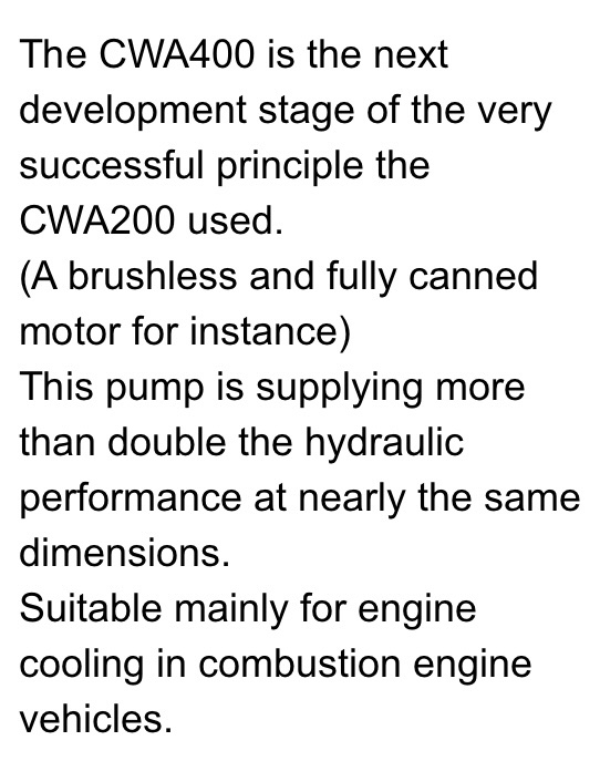

I got the 400 because it has double the capacity of the 200 which it replaced and the mounting bosses are better situated.
I just learned that if you get a 400 it will need to be an older model (eBay or a junk yard). According to Tecomotive, the newer models are not compatible with PWA controllers.
Thank you Paul.
This arrangement makes more sense, you're right.
If you use a combined swirlpot/expansion tank, it has to sit high in the engine compartment.
But then it will be difficult with a bleeding line from the radiator at the front to the rear

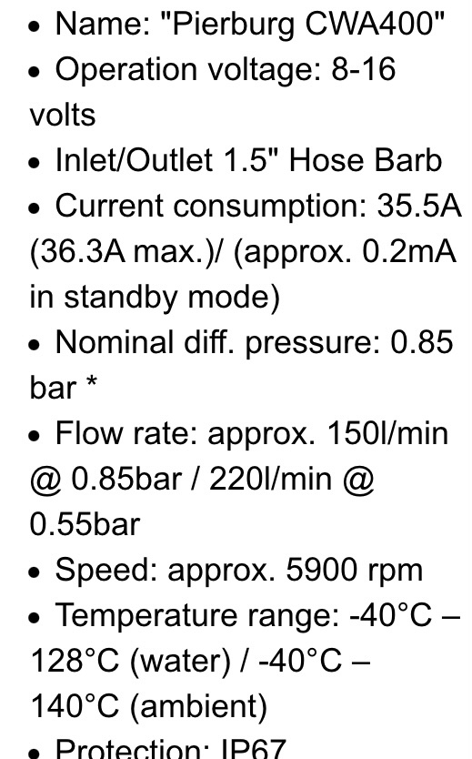

OK, I'm sold on the CWA400 pump but as I research purchasing, I am seeing a lot of knock-offs. Amazon has them from $89 to $548. Few if any are identified as Pierburg pumps. Most all are foreign-made units, which I am very skeptical.
Has anyone had any experience with any of the clones? Is there one that is preferred? Randy mentioned he purchased a reconditioned one but I don't see any reconditioned units.
The video he provided the link for comments about the $100 water pump. But when you follow the link to Amazon, it turns into a $389 pump.
Any recommendations?
I think I just got lucky with the price because the packaging was damaged. I would not take a chance on non-OEM.
