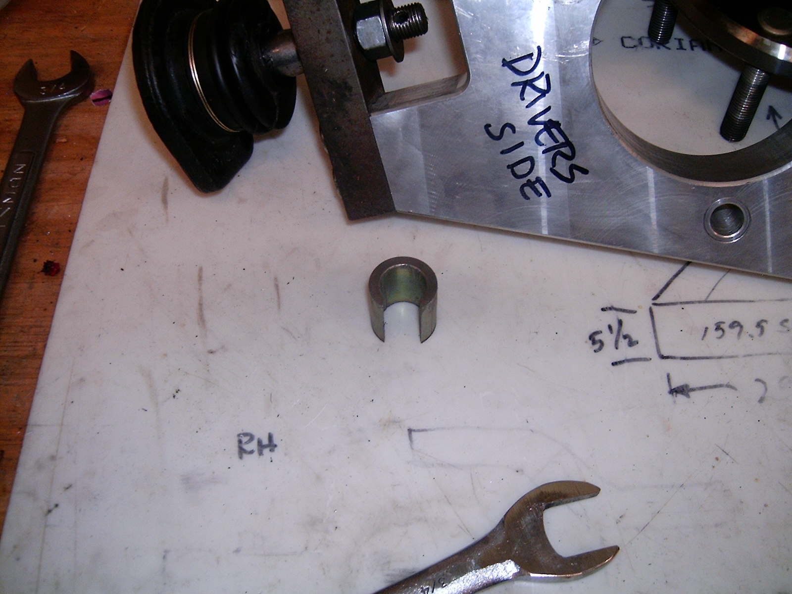

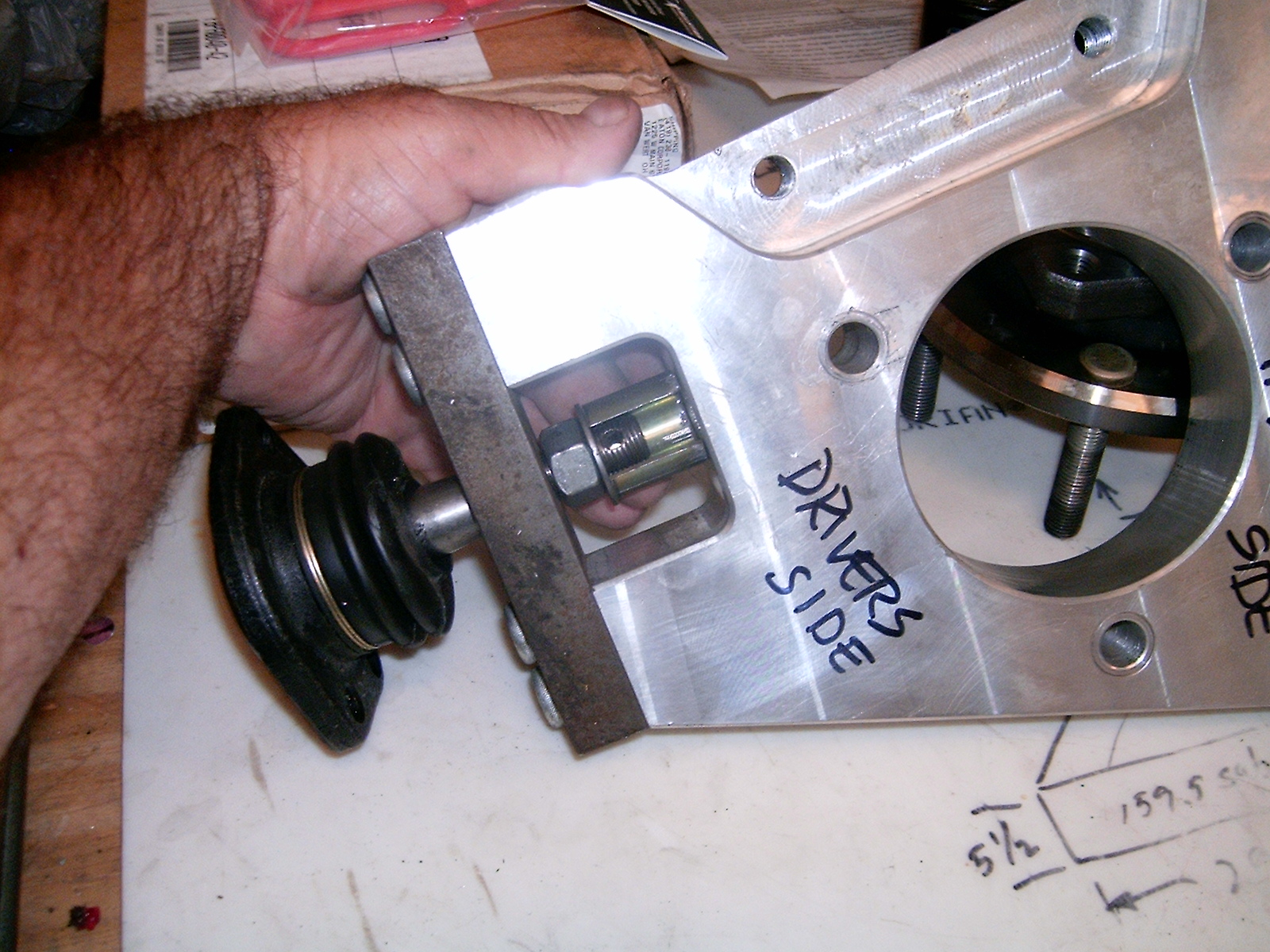

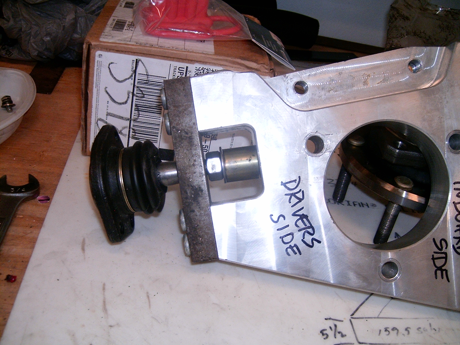

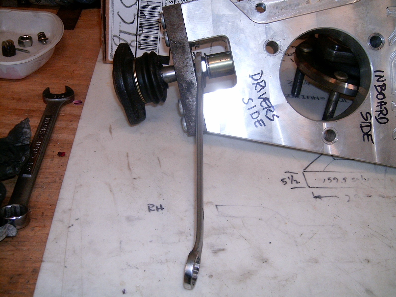

So how did I get the rears out without pounding, prying, using a mis applied ball joint tool, etc.?

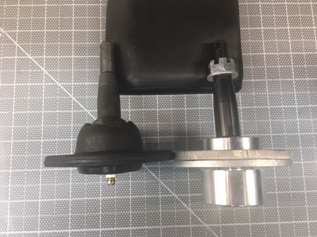

I have received a set of new ball joints from Summit Racing, They seam to be a bit stiff but after I cleaned them out and re greased with new grease they seamed to free up quite a bit. I really like red line products so I use them. I am sure other manufactures products work well also. Just stay away from the 3 dollar stuff. Look for a temp range of at least 400F. This stuff I use is good up to 500F. Why? the heat generated by the rotors is very high and the ball joint is very close to that heat source. When I removed the original ball joints the rubber boots were hard and cracked from the heat and the grease inside looked over heated to me as it was dry and seamed to have been overheated. I will check these after every track weekend from now on.
On to the fitting, The K6136 is about 3/16s taller than the OEM piece. I will make a spacer to fit between the mounting plate and the A arm. This should place it in the original position. I also ordered a 7 degree reamer to clean up the stud hole in the plate on the bottom of the upright. The original placement left about 3/32s inch of threads in the hole. I would like to have the entire stud bearing surface in the hole with maybe a single thread left to be pulled into place as the bolt is tightened. More on this as I final fit the ball joints in the assembly.

I have a supply of spacers for these and for the QA1 ball joints. There's a complete explanation of the ball joint story in the SLC wiki, here.

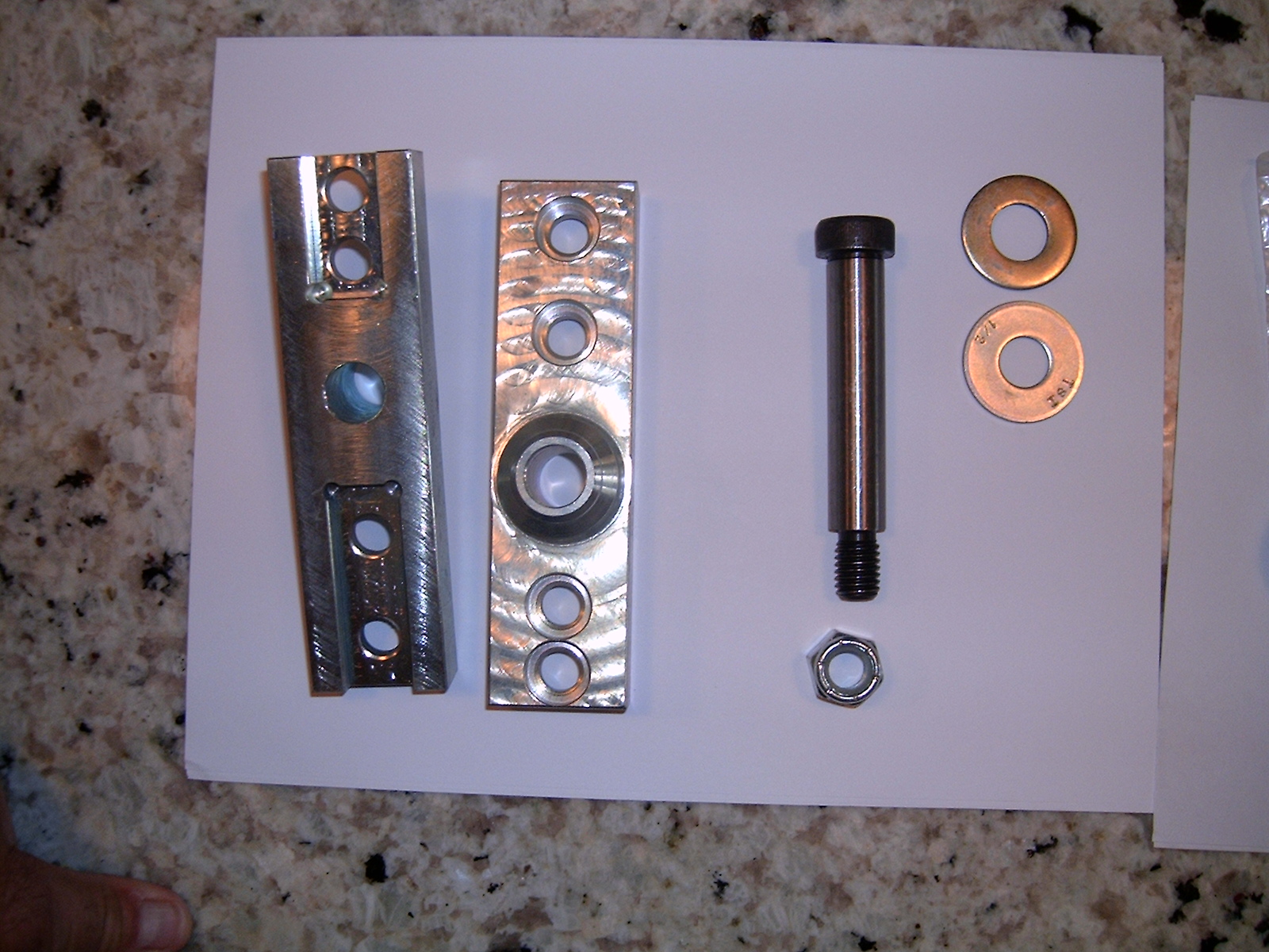

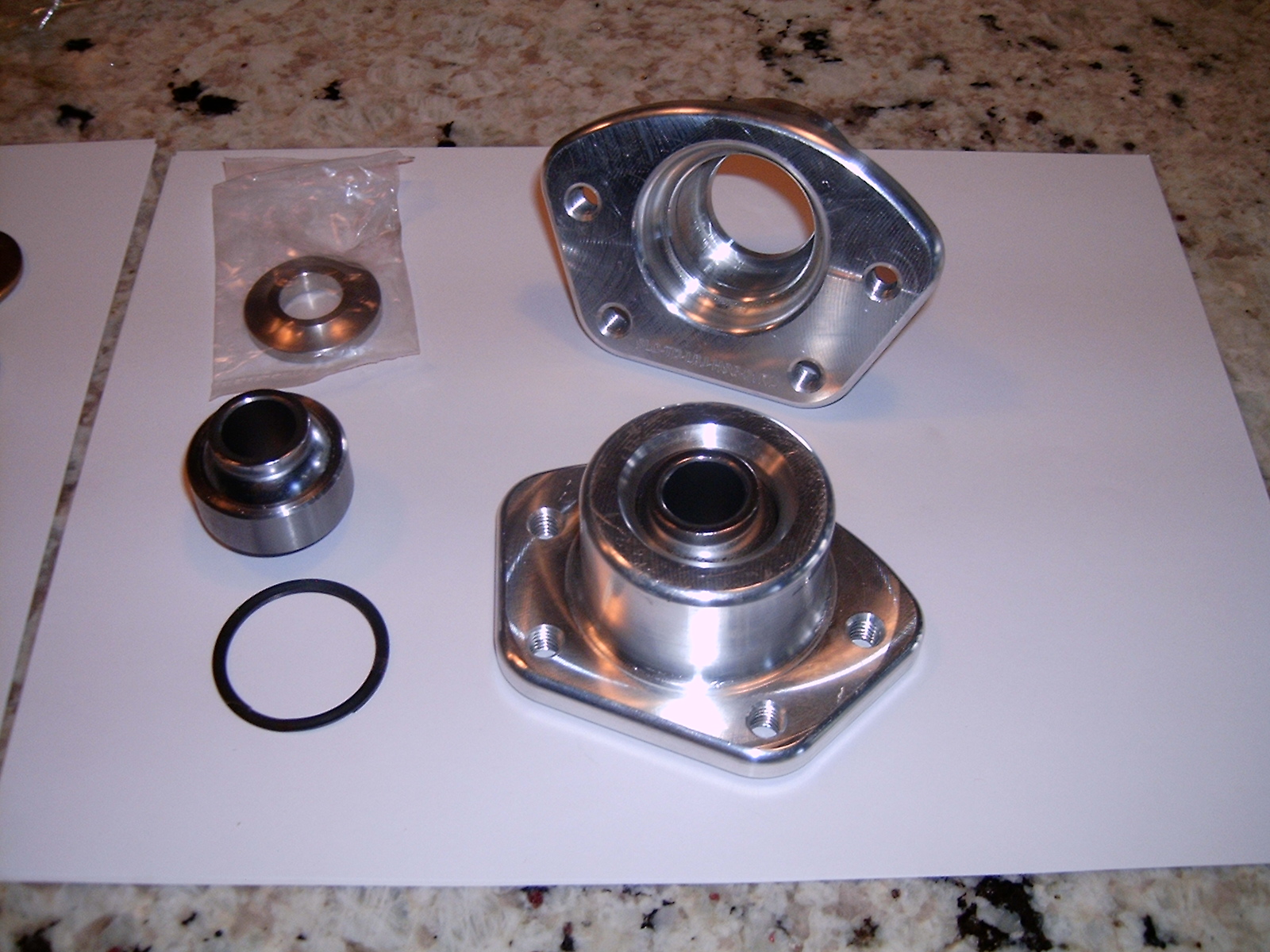

I decided to use the spherical bearing/ball joint retrofit kits on all four corners. The parts in this kit seam to be very strong and well made. The thing I really like is that they use a shoulder bolt in the place of the ball joint tapered shaft. This piece alone must make the whole thing much stronger which is what I am going for.
The other thing is that the stricture of the spherical bearing must be less than 10% of a new ball joint. The whole car is so stiff that it is hard to say the ball joint stiffness can be felt but it's there and it can't be helping.
The last thing is the heat issue. Rubber grease boots will not survive on a track car. It's just too hot in that location. The SB's do not have this problem but they will need to be inspected and kept clean. Normal track car maintenance and just one more thing on the list.
