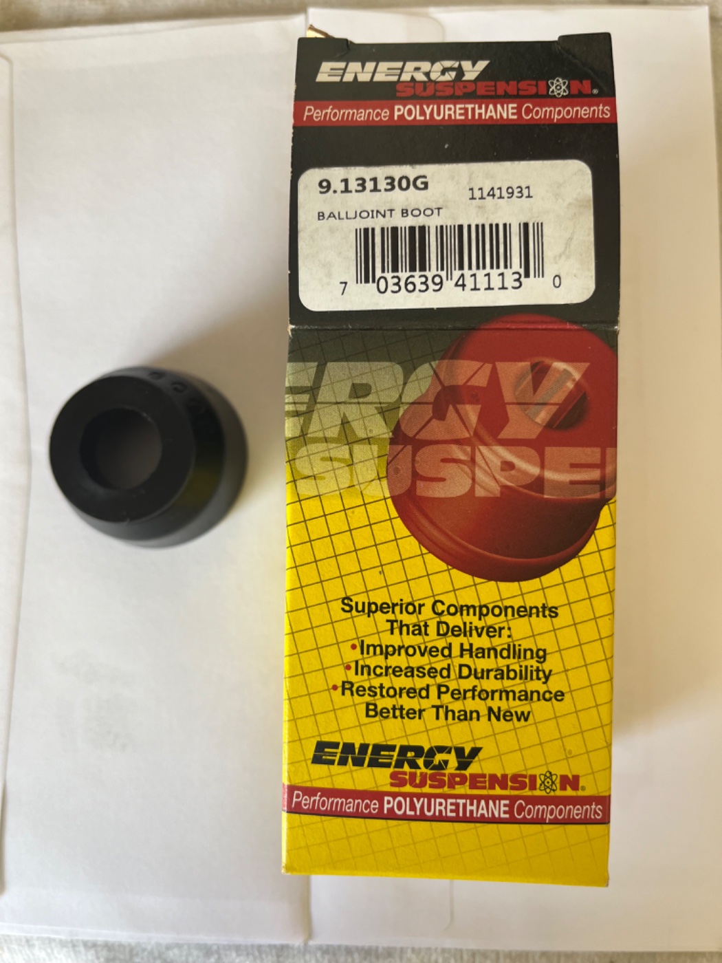

Also, for anyone searching for upper ball joint boots, here’s the info for Energy Suspension polyurethane boots that fit nicely.

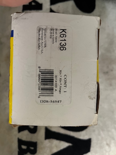

Just heard back from Bill, lower ball joint PN is K6136, but no known PN for the grease boot by itself. If I come up with a valid replacement PN for the boot, I’ll post it here.

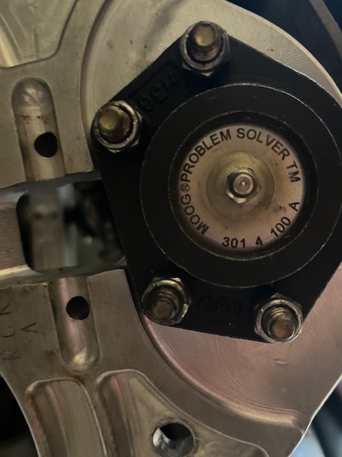

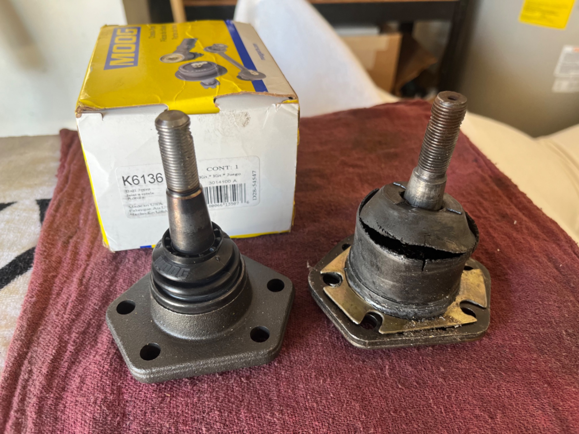

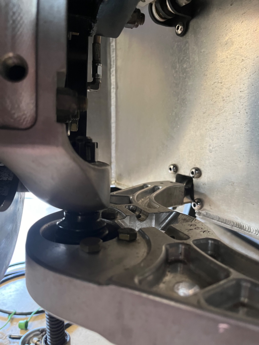

Just to follow up. I decided to replace the LBJ with a new Moog unit ordered yesterday from Amazon prime and received today…$27 shipped to my house!
It was poorly packaged and the threads were a little dinged up, but a little attention from a Swiss file and it was ready for install. The integral accordion style grease boot is a nice improvement over the older design. It went back together easily.
Johan
What’s the #number on those Moog ball joints? I ordered the K6136 but they are about 1 mm smaller in diameter than the ones delivered from RCR.
