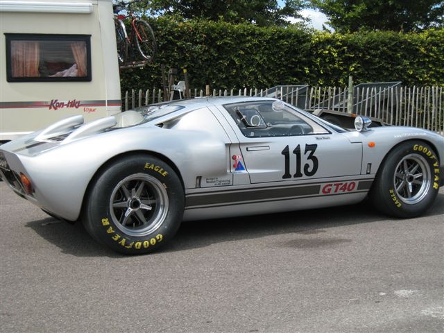

Slicks on 15s

It also very much depends on the rolling diameter and ride heights you want, we run 26.5 inch height on the rears ( as the originals), but the Avons are nearer 24 inch, so it means altering supension ride heights and thus geometry settings, which may be either be detremental or beneficial depending on what you are trying to achieve.

Hi
I am looking for tires with appx. the same height as original. That means 26-27" on the rear, and not many manufactorers have this size, and even fever have tires with qualities good for road racing over serveral laps. The one closest so far is Goodyear.
Frank:
Can you help me with some product numbers, sizes and type information on the Goodyears you have in your picture? Your tires seems different from the Goodyears I have found so far. Can you advise me to a UK supplier?
Best
Regards
Trond
Trond, I import them from Shelby Goodyear in US, these are Nascar sprint tyres, I can give you detail by E mail if you wish to contact me, Frank
