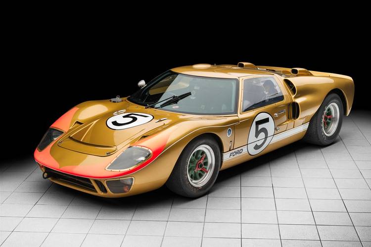

oh, here’s my inspiration and plan for final paint job. Probably not an original thought but I love the look.
