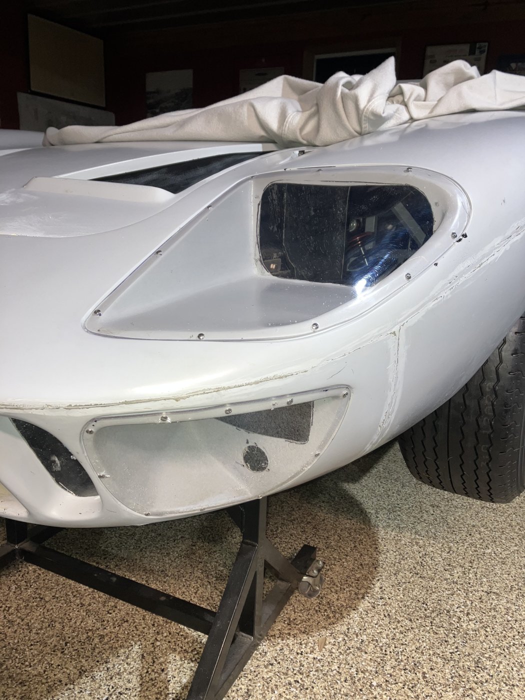

I just do not like the 6/32 slotted pan head screws of the original car, so ordered 6/32 countersunk oval head slotted screws. So a couple at a time, counter sunk the cover and replaced. I like this much better look and feel. Just need to follow up with riv nuts or inserts

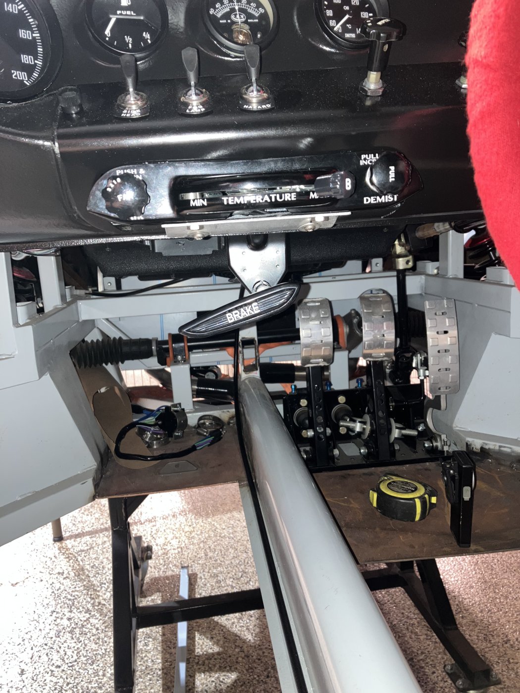

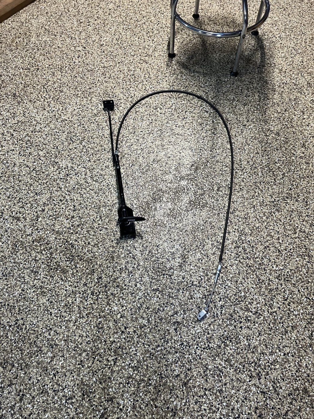

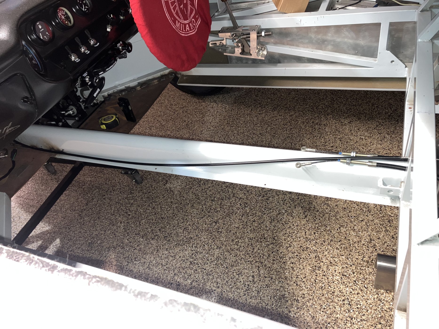

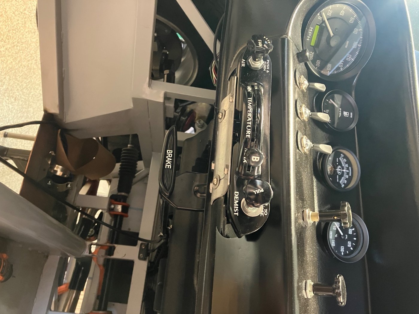

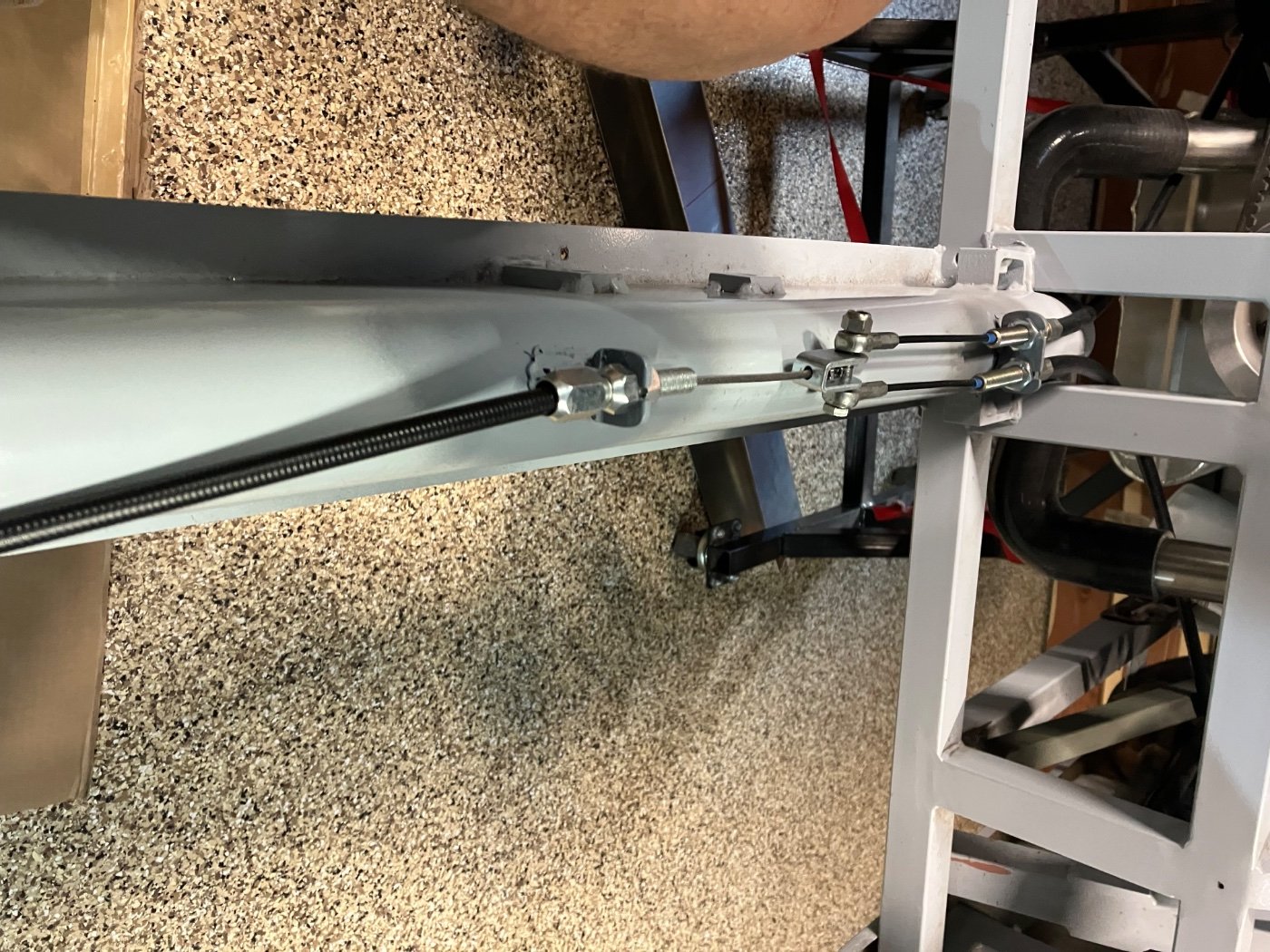

Got in my reproduction 1965 Mustang brake pole assembly along with a cable melting things together and getting a trial fit. I like the look and it reminds me of the original Mark one pull handbrake lever.
Davidmgbv8
Finished parking brake today.works well
