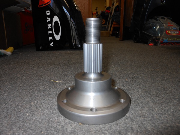

Hello all,
I need some sourcing a part for a CAV GT40. The part I am looking for goes by a few names but from what I can tell from my research there most commonly referred to as a(n) stub axle, drive flange, or axle flange. It seats right into the transmission. I will post of a photo of this, any help y'all con provide as to what this is exactly and where I can source it will be greatly appreciated.

The parts that I see in Audi's system all say something about 88mm and the dealer rep mentioned the 88mm aspect. I dont know what measurement that is for but I measured the largest point on my stub axle and I have 113mm on the outside, as in the area where it bolts to the axle.

I may be confused here but are you talking about the same part? I thought Dave's axle flanges were on the outer end of the axle through the upright/wheel bearing. It looks like William needs the inner flange that goes into the transmission which would be an Audi part.

Dave's axle is pictured.

That doesn't look like a Factory 01X cv stub, which would explain why it broke. I'd be willing to bet it's a custom piece. 01X stubs have provisions for a 88mm tripod style cv joint.
