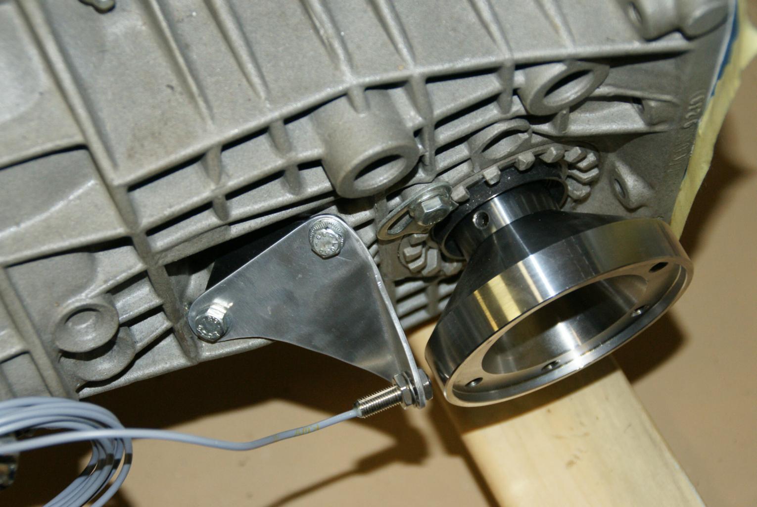

Hi guys and gals ..... I now have my gauges and senders and sensors .. So how have you mounted the speedo sensor at the rear axel ... any pics please ...

There is a bracket with the instrument set for this. Its flat and slotted for adjusiment.
The magnets are glued to the edge of the CV adapters or you can use the heads of the CV bolts which is better as it gives 6 pulses instead of 2 pules.
Bend the bracket and bolt to the side of the gearbox or attach to the chassis horse shoe frame.

I didn't have one either. I have had to fabricate one. I'll post it later.
Andy, perhaps you missed my email about this. Could you post a picture of the bracket and how it mounts?

Its a flat bracket 1/8" thick with two slotted holes.

Since I couldn't find mine and didn't know where to put it, I fabricated one. I suppose this is the intended location for it. This mounts over the two-bolt cover for the mechanical speedo cable.
