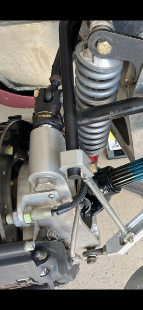

Helping a friend building a RCR with Porsche (getrage) g96.trans. Where do you get the speedometer signal from?
Best regards Håvard
I use the half-shaft bolts at the transaxle. My magnetic sensor (I use the one for the Lucas speedo and the RCR 8-pulse speedo) sits in a home-made L-shaped plate. See: https://www.gt40s.com/attachments/swaybar1-jpg.138693/
Originally set up (by the original owner) used holes drilled in the right rear brake disc - which did not work! I suppose the signal was too weak. Moreover, the discs get very hot and electro-magnetic devices do not like heat ;-)
Note that the tip of the sensor should be quite close to the bolt head (~ 2 mm). The Lucas sensor has a diode which blinks upon operation which is handy when testing the system.

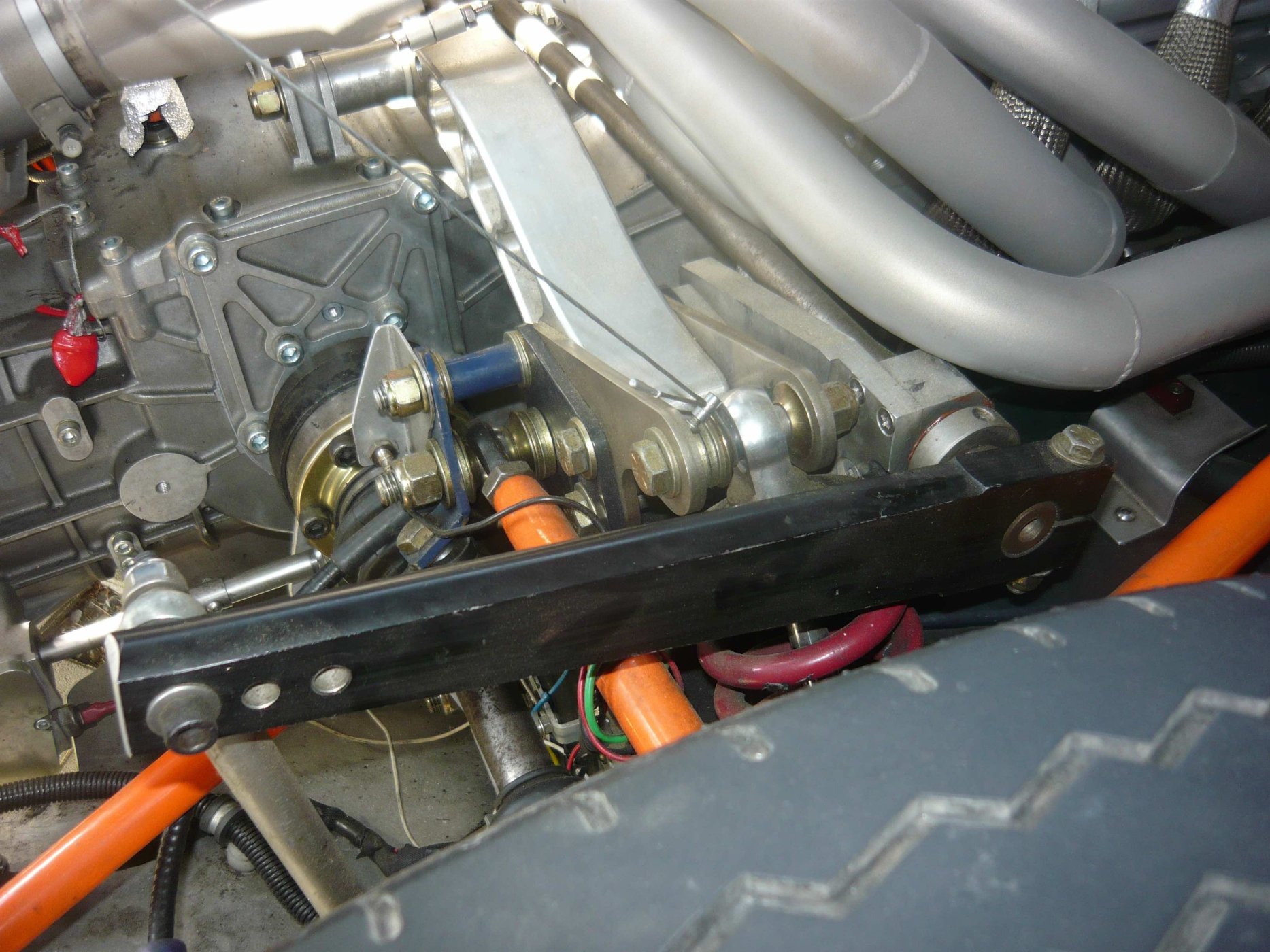

That’s how my car was set up, also by the original owner, with dimples drilled into the left rear rotor, but in my case it does function. However, my 8 switch Speedo is at the extreme limit of calibration, with all 8 switches set to the off position.
