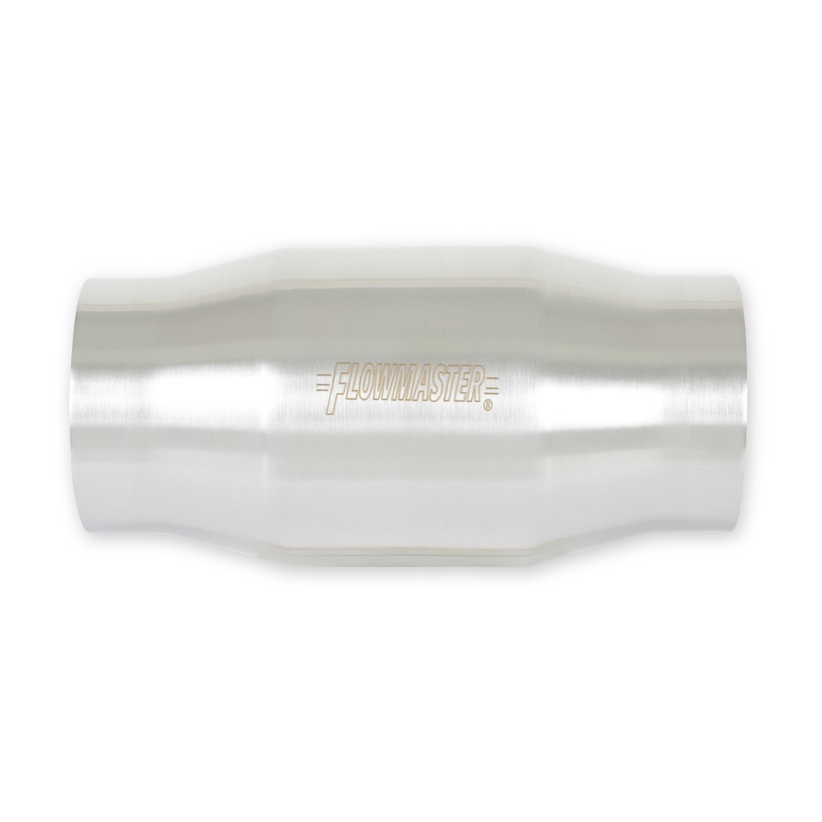

You're going to have to have the exhaust with cats custom fabricated. At one point I thought I might have to go that route for emissions testing. Short ones like this might work:
