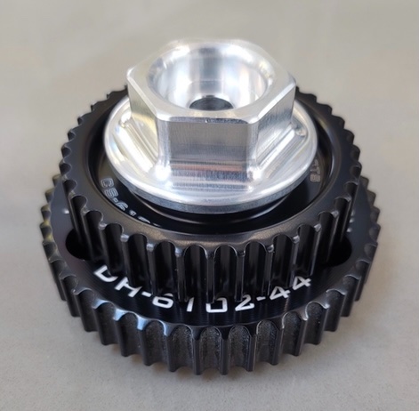

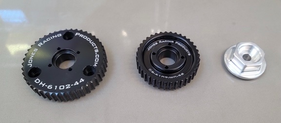

Rod, I was anticipating the same issue. My BBC for my Lola should have hopefully around 825 pounds feet of torque. As we all know there is next to no room in these things for your normal setup, yet alone tensioners. I would have no room or desire for a serpentine belt drive. I had a company build cogged pullies for everything including the ac unit. This should be a zero squeal, minimum room setup. Been well over a year waiting for my engine so I haven’t been able to mock things up yet. Health issues since last May has kept me from really giving a crap anyway but hopefully I’ll start again soon.
Regards Brian

Rod, if I may add, Chris at Jones Racing is a incredible wealth of information. As my situation is not a normal drive setup, they will custom make ANY combination you could ever dream up. These cog drives are used on 2000hp plus engines all the time. That alone made me go with them, and the EXCELLENT customer service from Chris was only icing on the cake. I can't recommend these guys highly enough. Although, I don't have my engine ready to go, I did tons of research at the track. Hopefully one of the other excellent suggestions from other forum members will work for you. Just have this in the back of your mind if a long term solution is needed.
Regards Brian

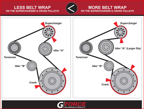

Do you have enough belt "wrap" around each pulley?
Aweful example in Yellow:
Increasing belt wrap, beginning with a good start.
