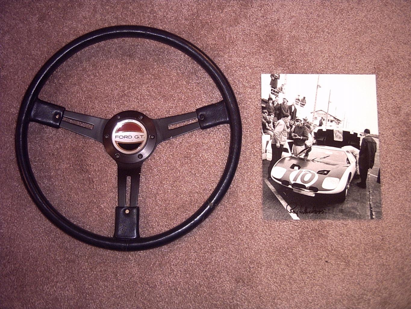

I'm having my seats made as we speak, the guy has supplied seats to many original cars and is cheaper than Gelscoe. If you care to PM me, i will also tell you where to get your steeringwheel, i have an original one off the second prototype car.
