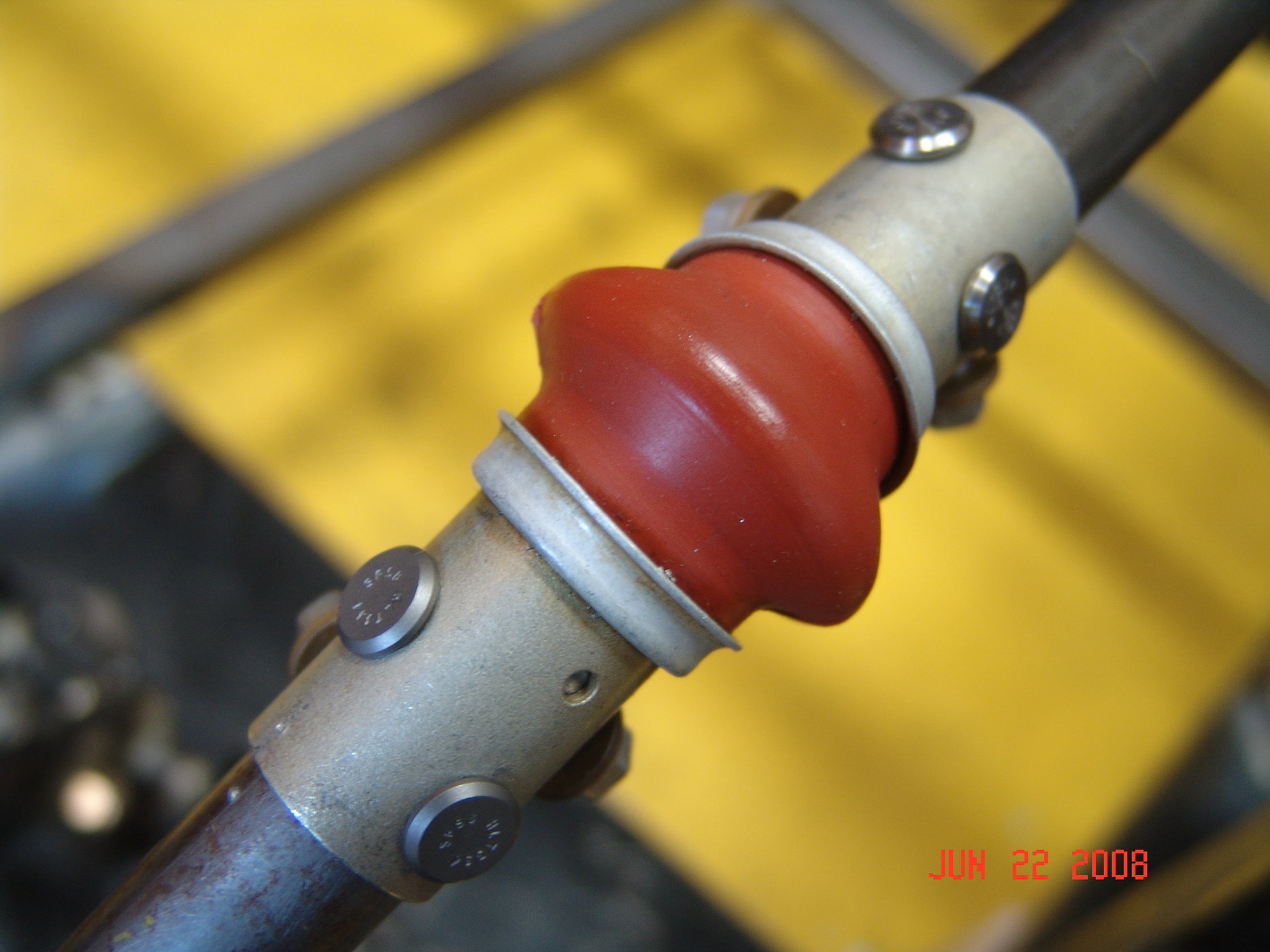

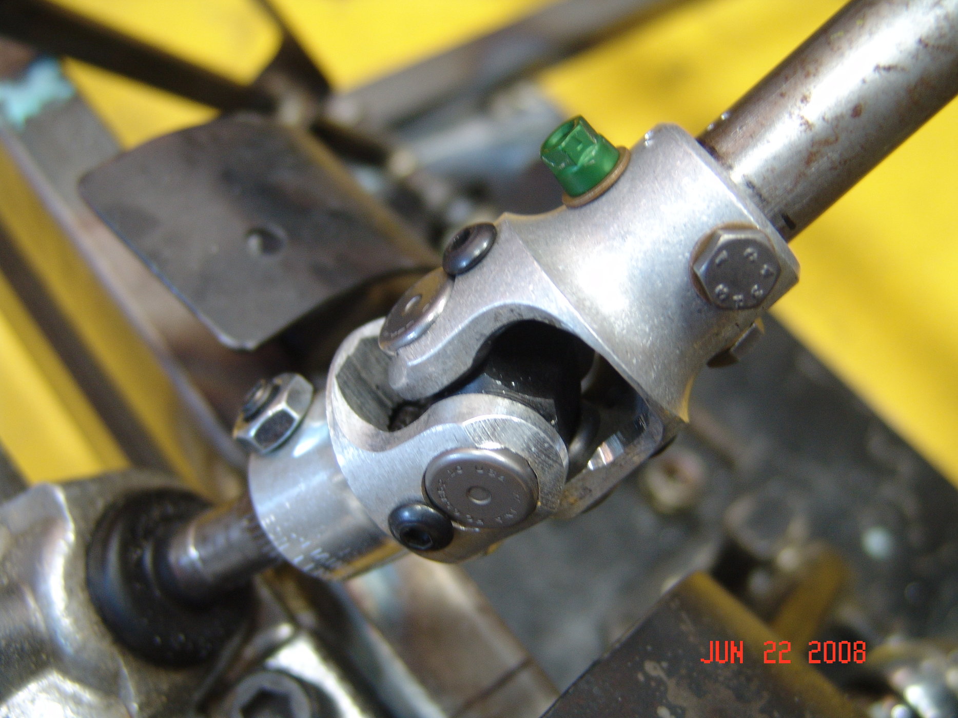

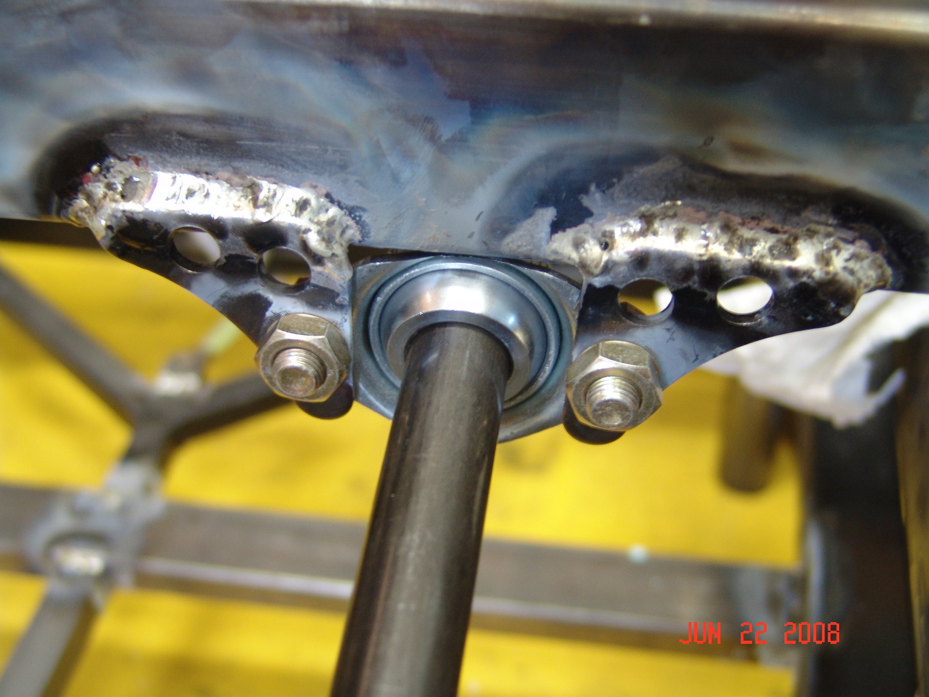

3/4" OD CrMo tubing with Borgeson & Apex u-joints. I used a Mark Williams splined quick-release on the steering wheel hub.

I did not find a column that was the right size or sufficiently lightweight to suit my application. There is an offset with a short piece of tubing between the two u-joints so that will crumple in a straight-on impact.
