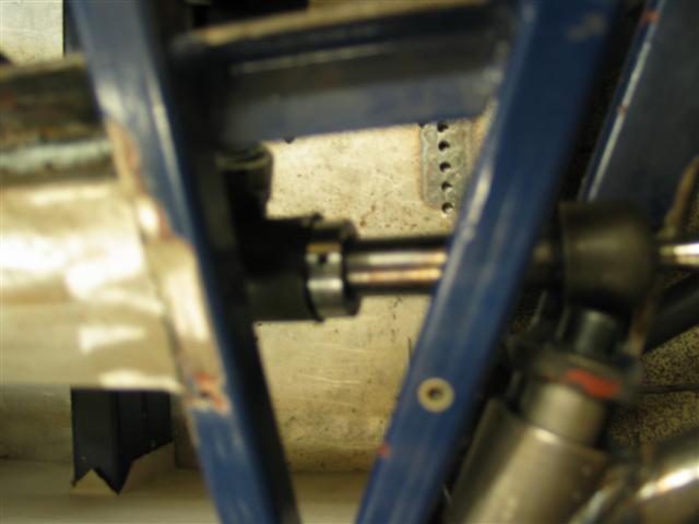

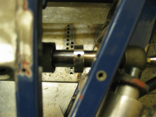

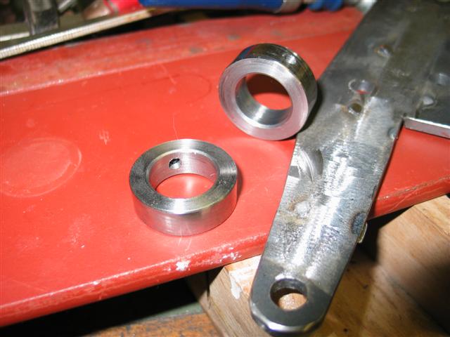

Brian, Phil and Julian, many thanks for your input, the answer is totally different than what I had in mind, I envisioned a physical stop on the moving parts of the hub carrier or something, see daft as a brush!! :pepper:
This makes much more sense!!
Here are the pictures
