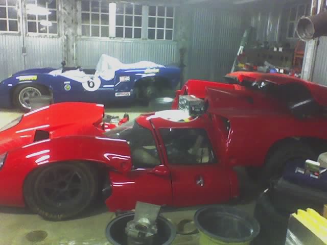

T70 barn find ?
The MK III coupe body is now a shell on the floor, but still looks cool.

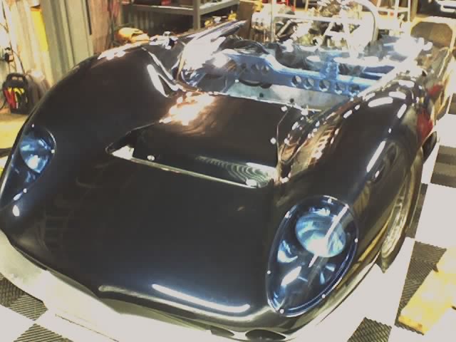

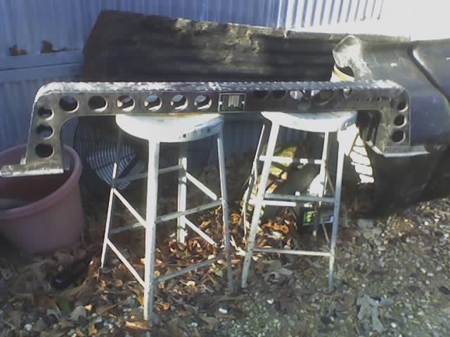

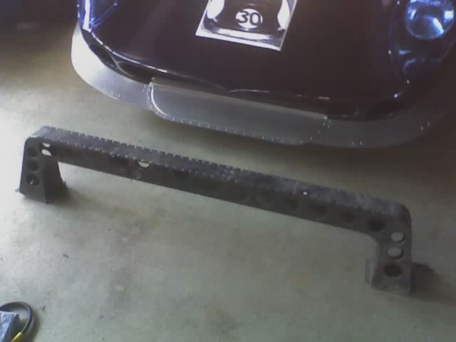

this is the original dash support structure that was only on the Gurney car. It had been "cut down" when the coupe conversion occured. We re-made it, but I do have the original. The chassis plate is attached to it.

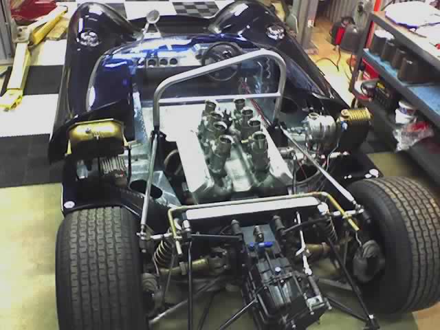

Now all that is left are the headers, wiring, plumbing, fuel cell, gauges (which I have, thank goodness), decals, brakes, bearings, tires, crack check, re-nickel, alignment,
and then put a bettery in it, fire it up, and fix all of the problems that will surface !

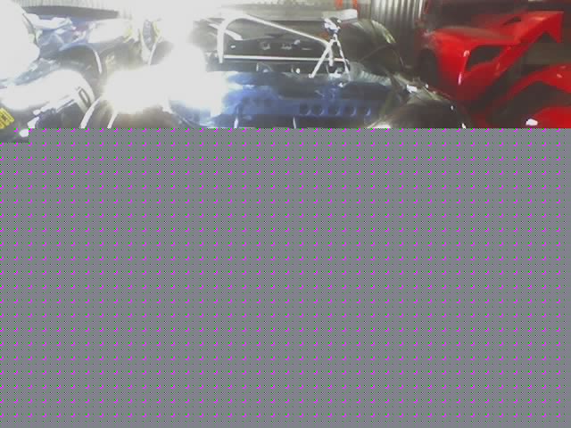

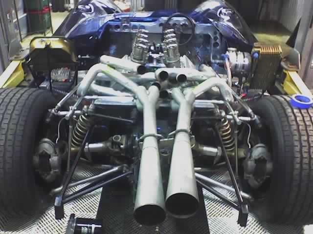

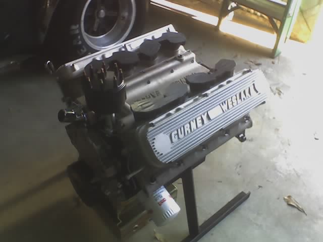

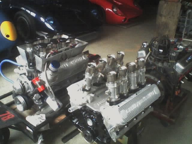

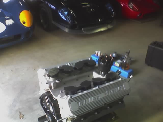

I'm trying to fit headers and it is a challenge. These are from a GT40 and I am trying to adapt them, but it might be easier to start from scratch. The Lola chassis rear crossmember is higher (actually, the engine sits lower in the Lola would be a more accurate statement) so these headers will need major modification to work. /ubbthreads/images/graemlins/help.gif

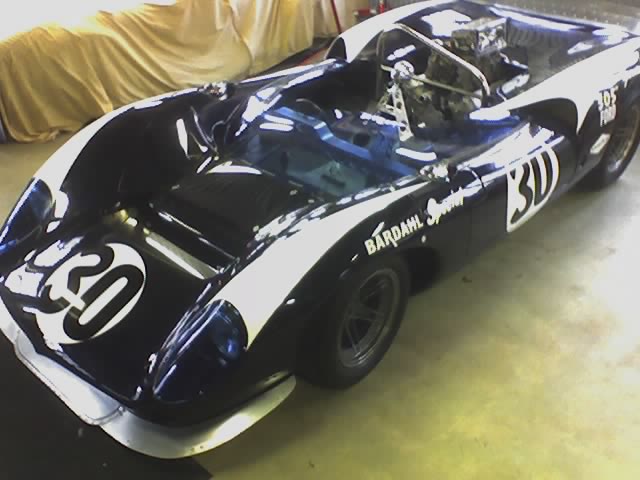

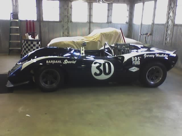

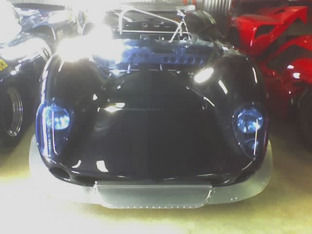

I quit on the headers and worked on the cosmetics some more.
Less frustrating. 2 Lola enthusiasts,Sean and Claude, from a sign company helped me make the decals and we put them on today.
