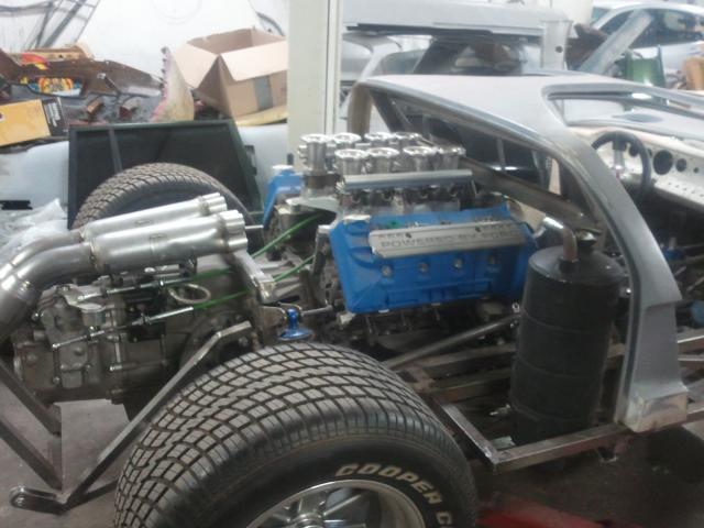

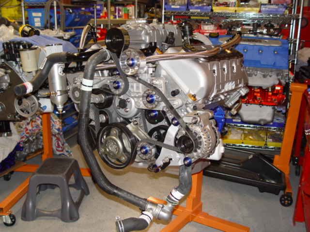

I have the 5.4 32 valve GT engine and need the thermostat housing. I think I can use different housing from other modell. Which modell is best. I show in one image my engine and one image a thermostat housing I think should work for my setup.
And where to buy?
Thanks in advance

I have used that specific thermostat and housing on both my GT40 and my Pantera with very good success. I like it because it is remote and can be mounted up front behind the radiator simplifying plumbing at the engine. THe housing and internal thermostat is avialble from Ford. There is also a 160 thermostat available for the housing fomr aftermarket manufacturers. I will need to go to the shop and get the part numbers. Kirby Schrader also used this unit and may have the message available where I sent him the part numbers. I will be going to the shop in the next few days and will get the numbers for you.
Mike Trusty
It isn't available as an assembly so you have to order the pieces separate from Ford. Here are the numbers:
Water neck F6ZZ8592BB
Housing XR3Z8K528AA
Seal F1VY8255A
The 160 degree F thermostat element is from HyperTech and the part number is #1011.
Mike Trusty
There is one more option that will likely be much easier to get and cost about 25% of the modular thermostat is one that I have used on serveral high HP cars. Look for a thermostat for a '85 BMW 318i. It is a remote bypass thermostat like the Ford unit but can not be taken apart. If you can arrange your hose to fit the BMW unit it will flow plenty of water. I have used in on several high HP Pantera.
