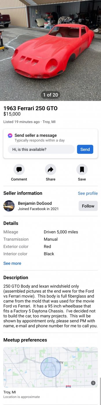

This is interesting, I'm wondering who made the body?
Who made the body?
I’ll give you three guesses and the first two don’t count.
Hint - look at the location and ask yourself who does business in that area…

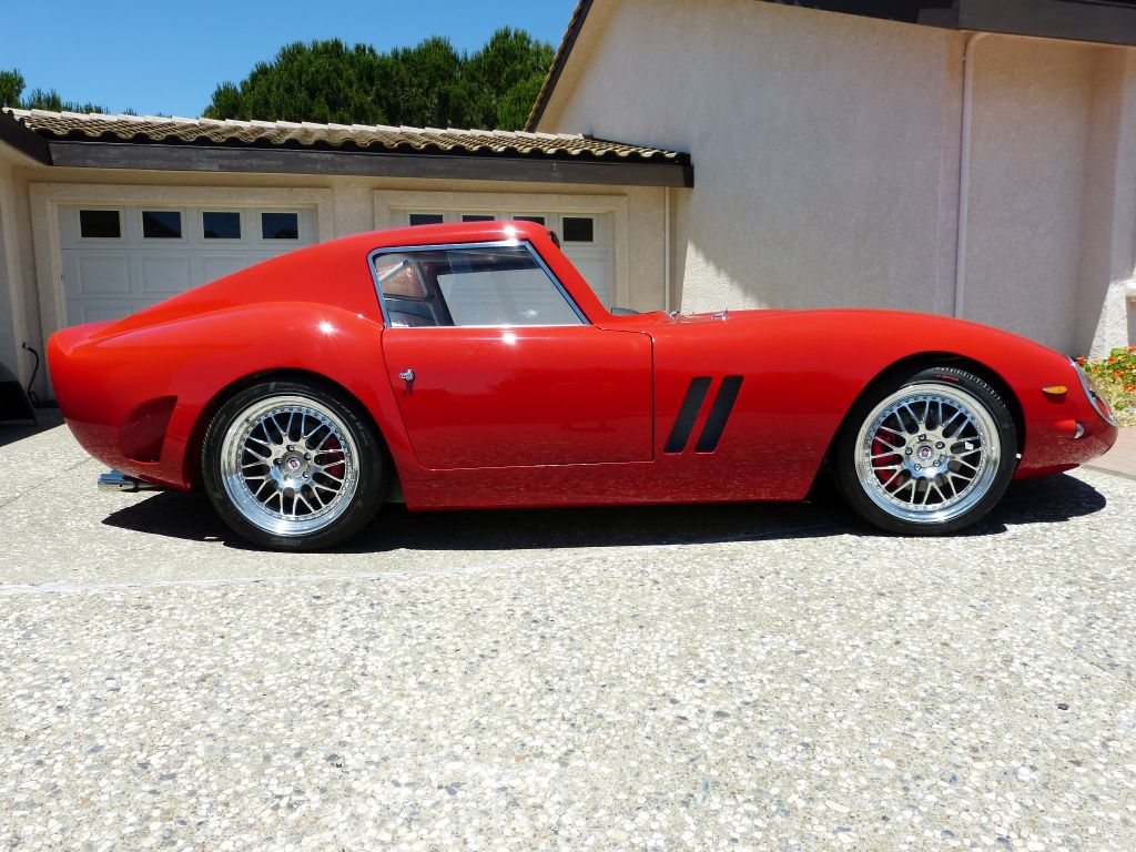

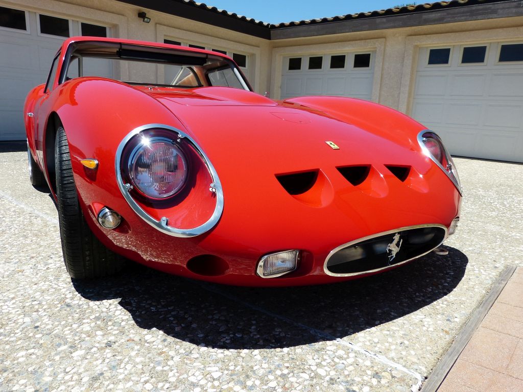

Here's a homebuilt Ferrari 250 GTO with a body that I built.
The molds still exist if anyone is interested in building one. It's 94.5" wheel base and body is 6" wider than original GTO. Mine is build on a custom tube spaceframe/chassis using C5 drivetrain (thus the extra body width). You could potentially use a shortened C5 chassis.

I don't have an opinion other than the previous post about likely made by someone local that is well know for one-off movie cars. Anyway, I considered it briefly but I don't need another project unless it could be a fairly easy build. With a one piece body with no jams or door inners it's just more than I want to take on right now. Fabricating jams, fabricating or finding a suitable door shell and then matching that to the "B" pilar to get the latch and seals to work out is just more than I'd want to jump on right now.
Rick Muck- Mark IV
GT40s Sponsor
There wasn't a Z chassis used in F v F
We used Cobras track cars which we lengthened the wheelbase on , due to time constraints.
We did the 250 and the 275 gtb bodies
We did these from scratch

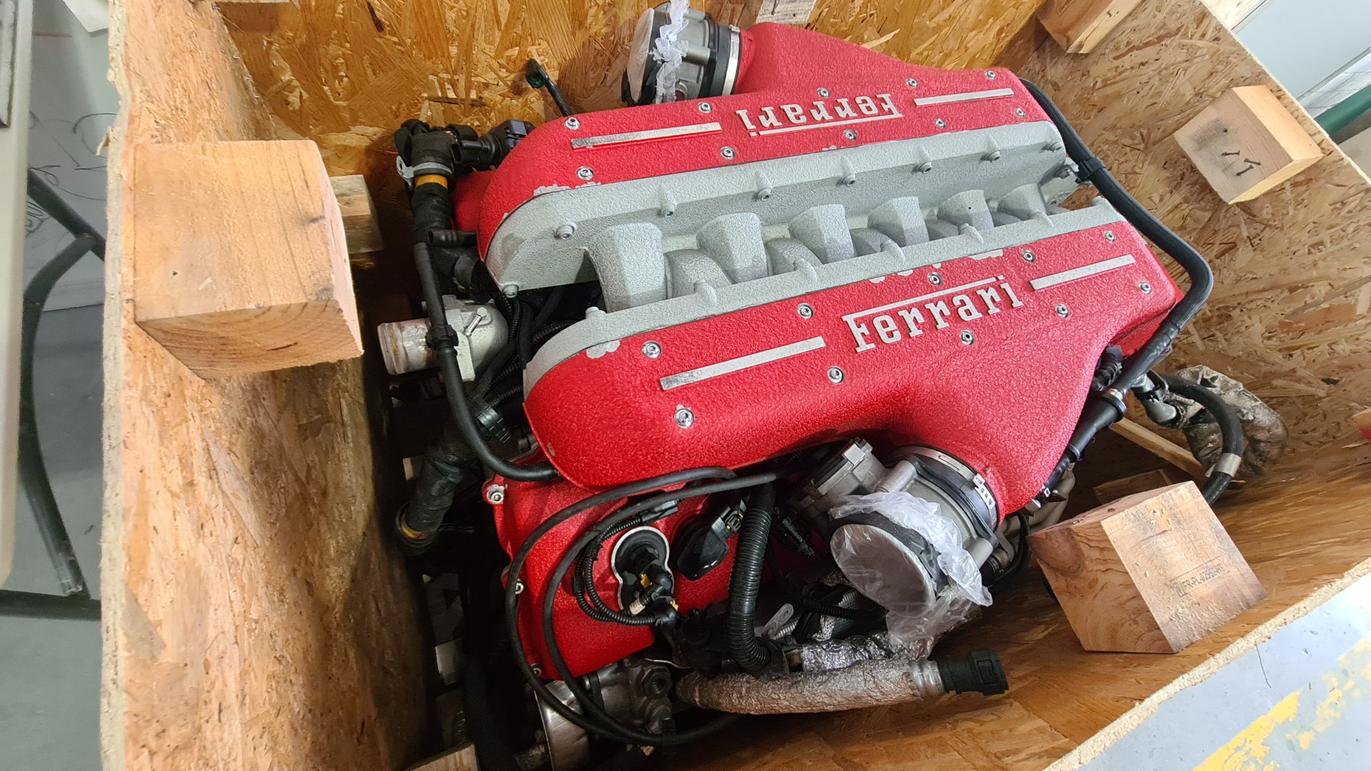

I have a VERY low mileage Ferrari FF V12 engine here that is waiting for a project just like this... if only I could buy a roller of the 250 ;)
