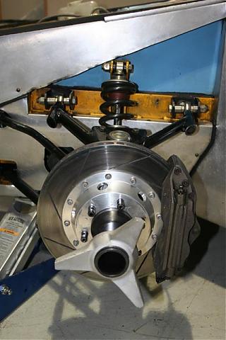

I have been fitting new front uprights and other stuff to my car. These are John Wisher uprights, spindles, steering arms (but my specification), spinners, and brake calliper mounts topped off with Mick Sollis brake bells. Roy Smart replacement GTD arms top and bottom.
For those interested, I am running -0.65 camber and at present 7.5 degrees of castor. This may change. Initially set at 4 degrees we have loaded it up to get more feel but with another planned steering rack change 7.5 may be too much. We shall see. Ackerman is great. On the turn plates when the outer wheel is at 13 degrees the inner wheel is at 15.5. At 20 degrees on the outer wheel the inner is at 25 degrees. KPI is 5 degrees. I get full lock to lock on the steering with no interference on any part of the wheel or suspension parts.
Ron has been chasing me to post a picture so here we are.....

Mike Pass
Looks really nice Malcolm.
Any chance of a view from the front? Can you let us know which parts you used for the steering arm and caliper brackets? Are you using AP discs and calipers? The Ackermann is much improved - how did you calculate/achieve this? And now the "million dollar question"........cost?

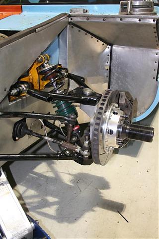

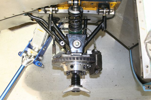

Some more pictures below. Hope this is of help.

Malcolm
Looking at this picture, I think I need Brian McCarthy over to do some polishing on the old ali panels here..... But I guess they will do as they are over 10 years old!
Malcolm
Callipers are Alcon, you can get these fromTrident Racing at Silverstone although I suspect they have a newer model now as these are 12 years old. Discs are AP items, about £200 each?
Ackerman calculation, hmmm, trade secret here. I used the old, "that will be method" and stuck my finger in the air and sucked in hard and guessed! Some experience of playing with this before helped but I have good positive ackerman as proven by turntable readings. Too much for a race car but enough for a road car.
Also I can now dial out bump steer with the ball joint steering connection as I can spacer the link up or down to suit my set up. Have lathe, can turn spacers!
