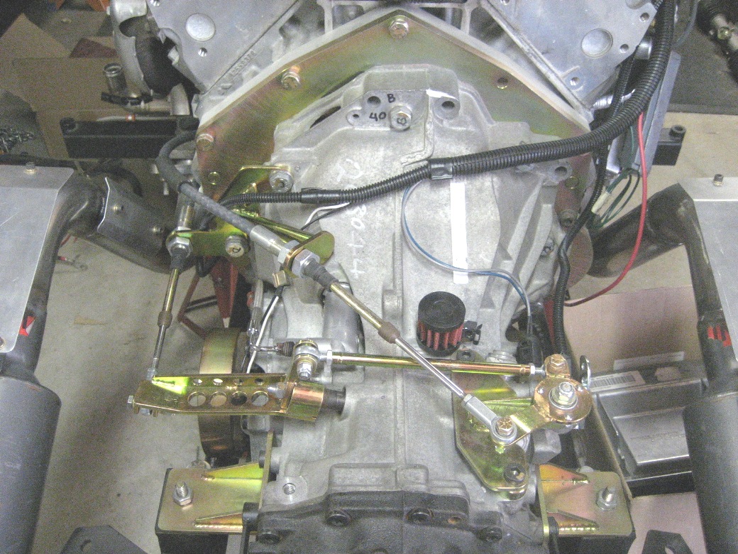

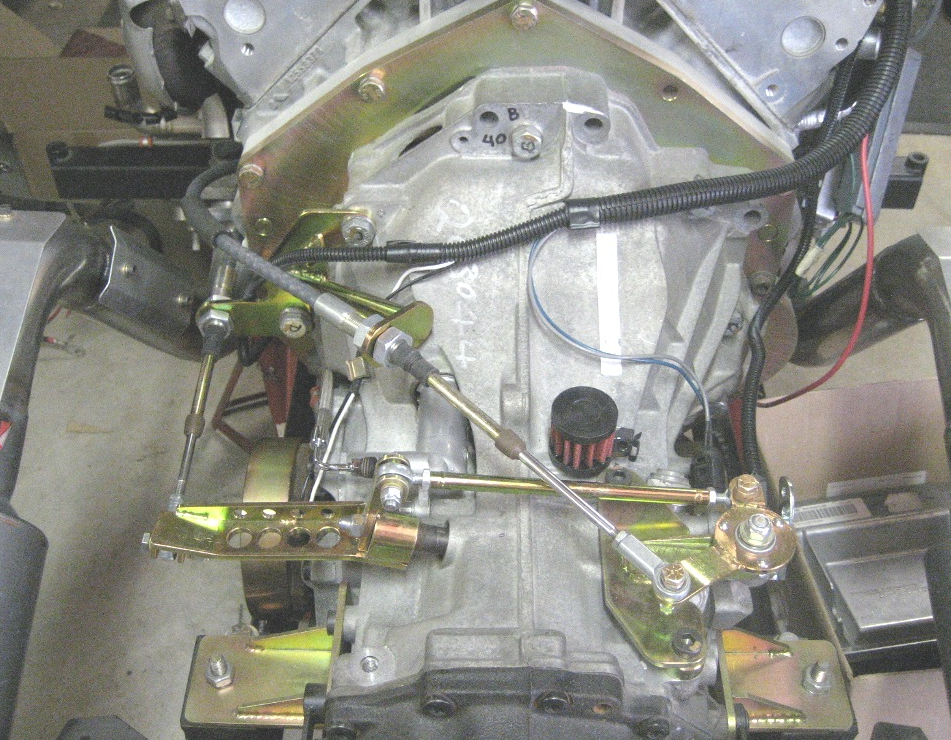

I think centre console, cable shifter and 01E gearbox should definitely be doable. (I'm planning that, so I hope so!)
I've got ideas from this forum and going to use a Toyota Celica shifter as Bill Musarra has done here (picture in post #3).
For the gearbox end, there's a good picture here. That's for a 016 but will be a similar set up for the 01E. Bit of fabrication should get a simple / neat solution.

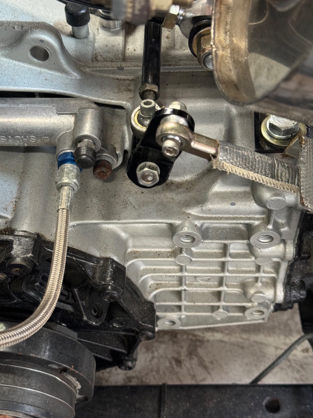

Darrin,
Although not in a GT40, I used that Celica shifter (somewhat modified) for the 01E. It has an adaquate enough gate for a 6 speed application, IMO. The photo is how I configured the linkage at the transaxle.

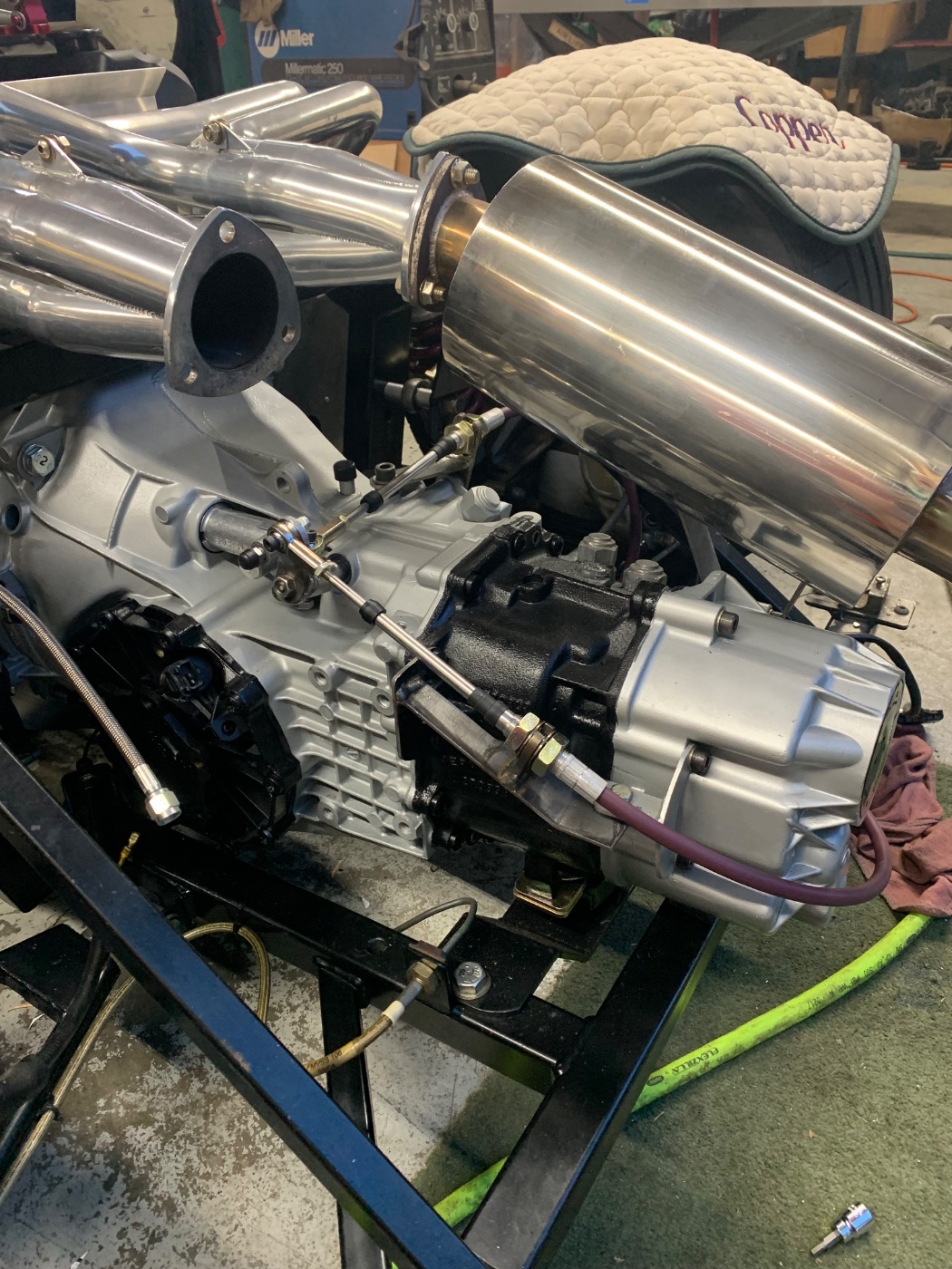

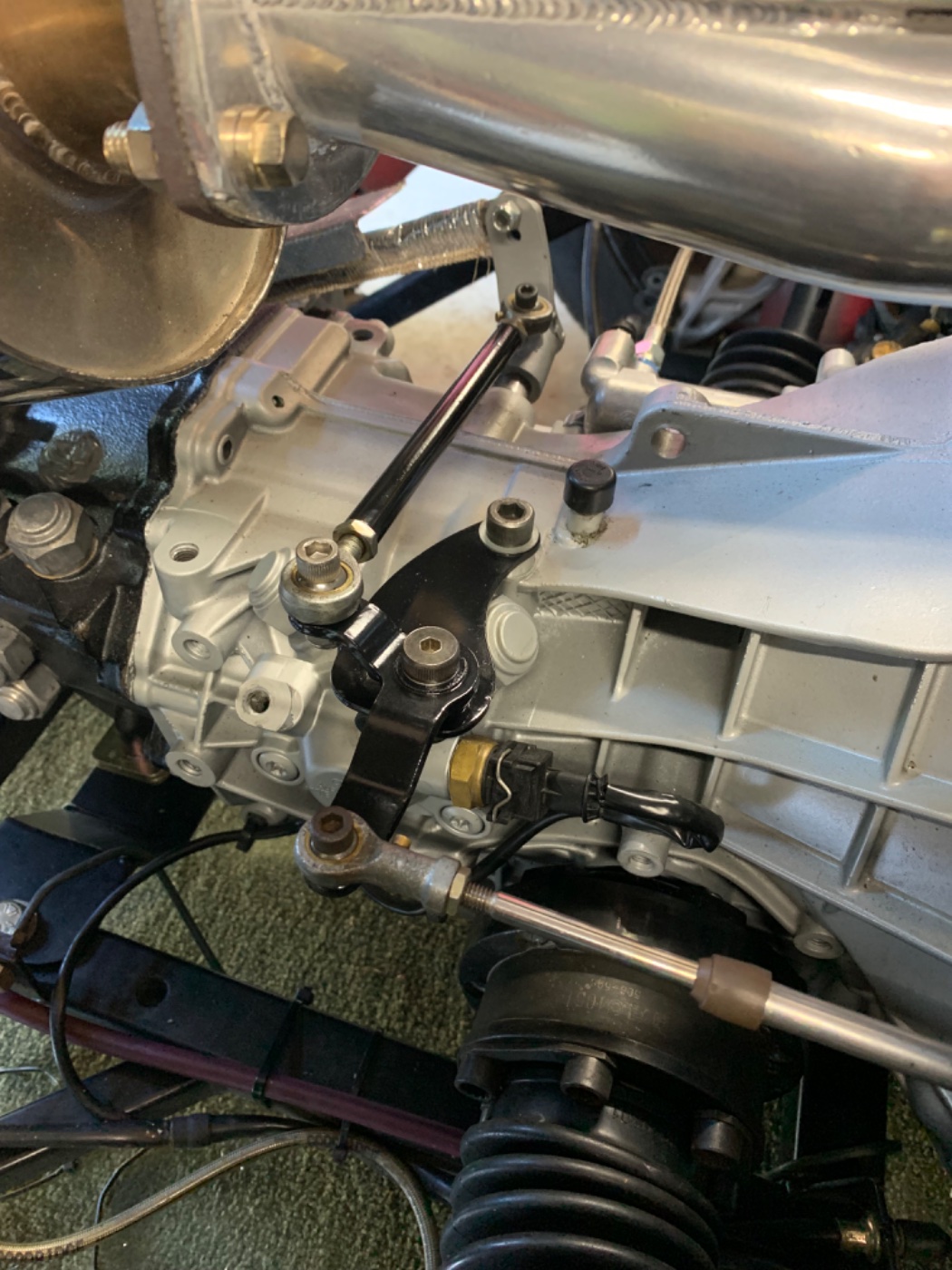

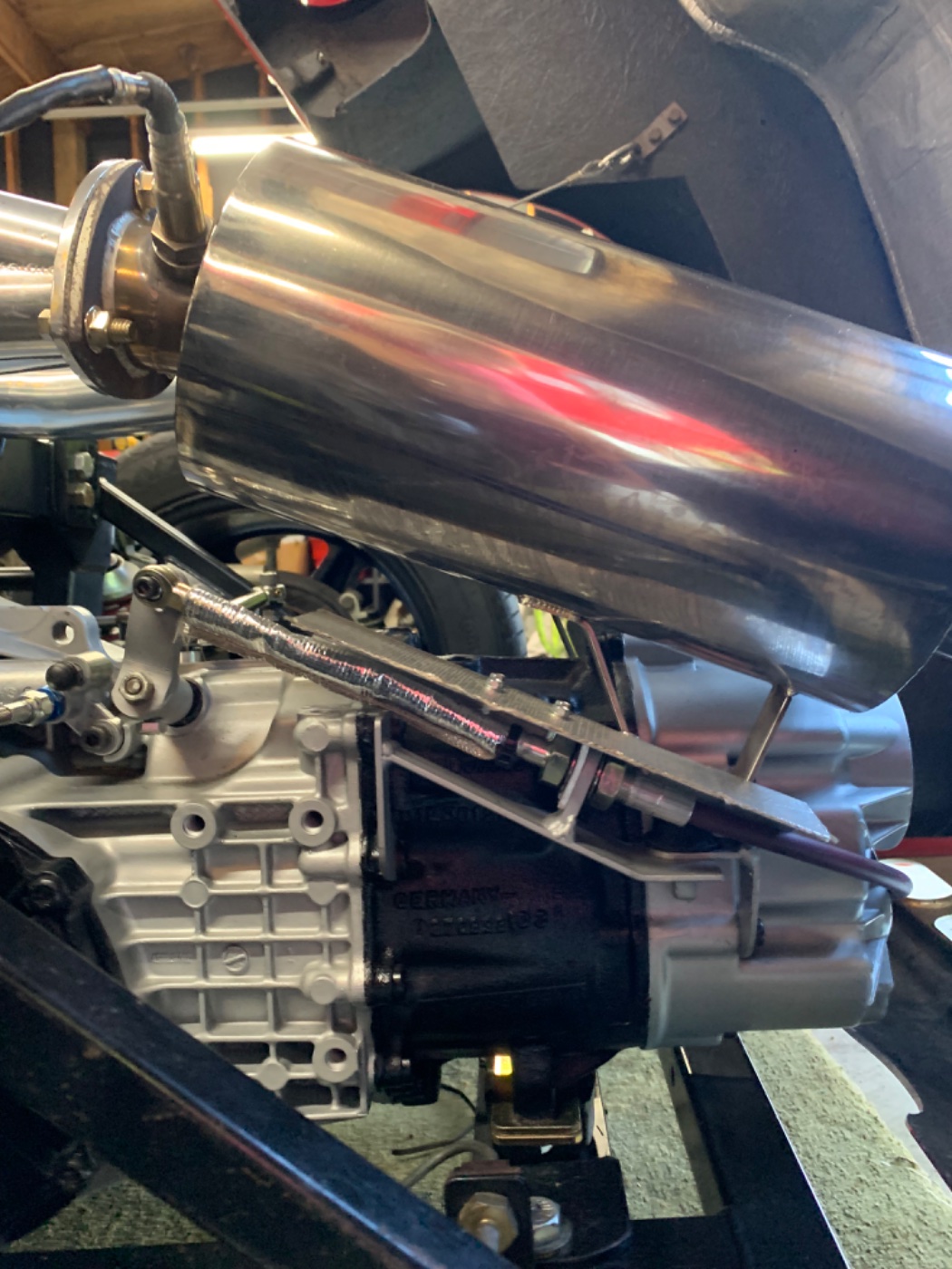

Jim Dewar
I fabricated this linkage converting to O1E from an 016.

Adrian Starling
Hi Jim, thank you for sharing your linkage pictures which are incredibly helpful. Do you by any chance have drawings for the individual parts? Kind regards, Adrian
Jim Dewar
I simply used metal from the scrap bin, I didn’t work from any drawings for dimensions.
