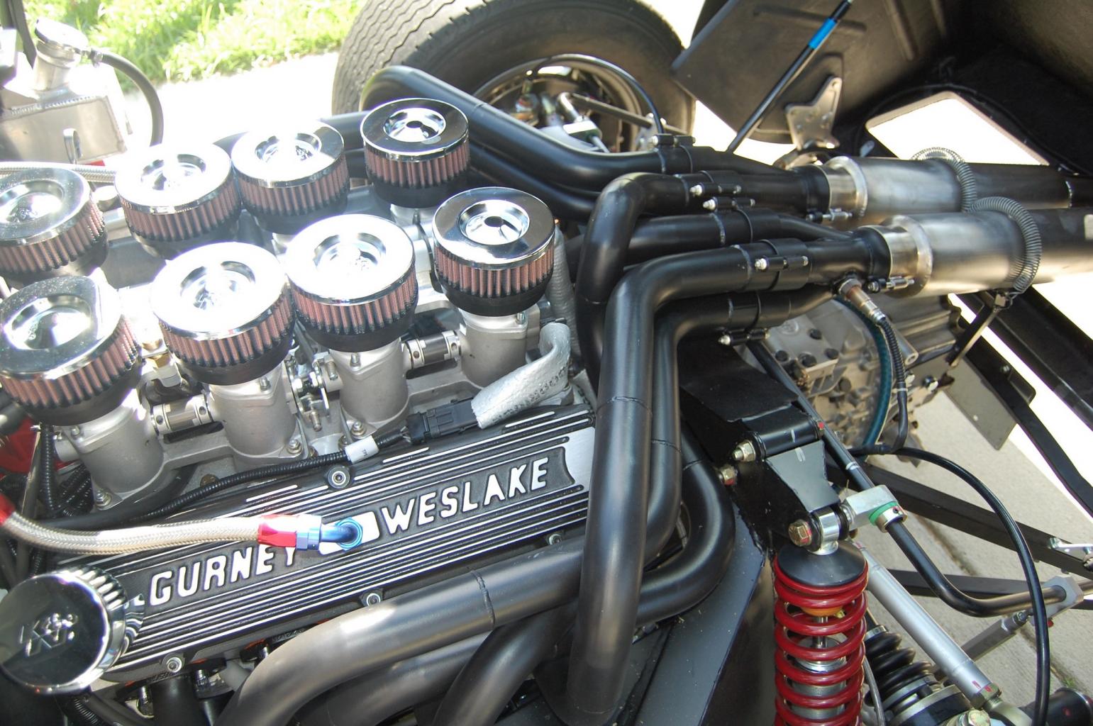

<FONT color=black><FONT size=3>Hello guys,
I'm having trouble with my injection system, while hunting down potential issues I saw on my laptop that the voltage of my throttle position sensor is changing with temperature of the engine. Yes, afterwards it does not make sense to have electrical components or fuel line that close to the exhaust system…..
These changes come into my mind to fix the issue:
· <SPAN lang=EN-US style='FONT-SIZE: 10pt; FONT-FAMILY: "Verdana","sans-serif"; COLOR: black; mso-fareast-font-family: "Times New Roman"; mso-bidi-font-family: "Times New Roman"; mso-fareast-language: DE; mso-ansi-language: EN-US'>Changing the setup (TPS to the front) <?xml:namespace prefix = "o" ns = "urn:schemas-microsoft-com
P> <P class=MsoNormal style=
· Adding a turkey pan / heat shield
· H
eat insulation of TPS and fuel line
What is your opinion/experience? Do you have some examples for heat insulation to make a quick fix??
I would be thankful when you share some Information/pictures.

My assumption is that the cable has a slight dead-band (slack) in it that allows mounting components, engine, etc to expand with heat without actually tightening the cable and thus changing the TPS position.
Dwight
RCR GT 40 Gulf Livery 347 Eight Stack injection
change you move the TB / TPS from the 7/8 position to the 1/2?
Dwight
Consider flipping the throttle bodies so that the sensor is in the front on the right hand side. that is how mine is set up. Then there are no worries.

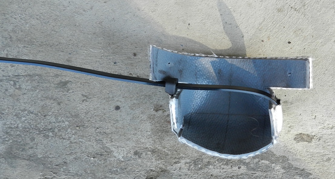

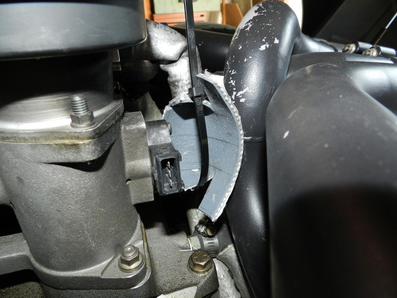

Quick and dirty solution
First thanks for your idea's - flipping the throttle body is a bigger (winter)project.

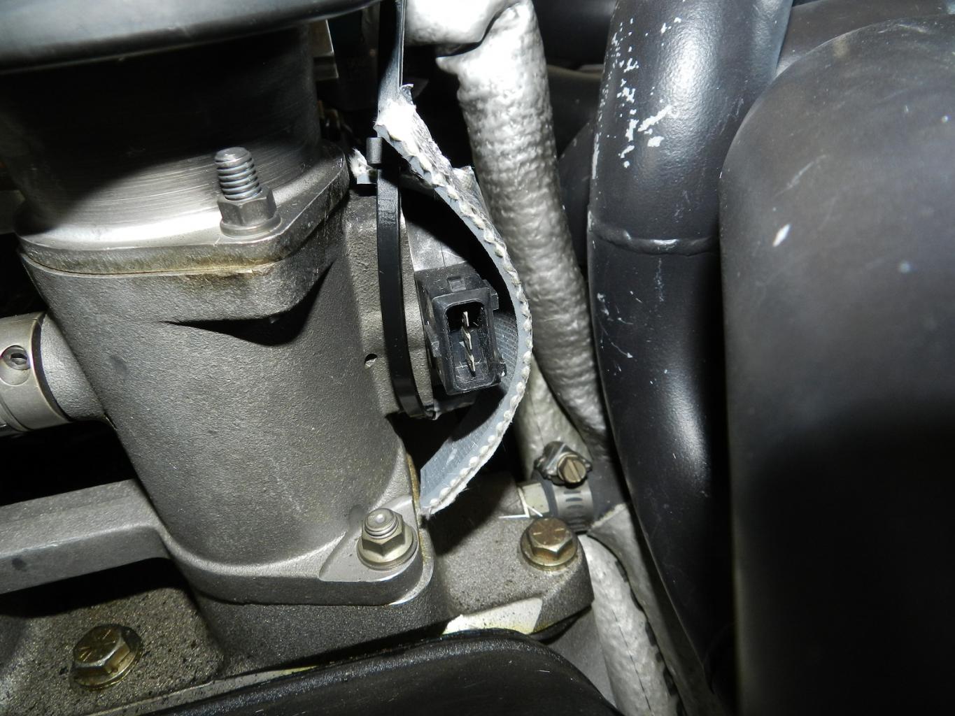

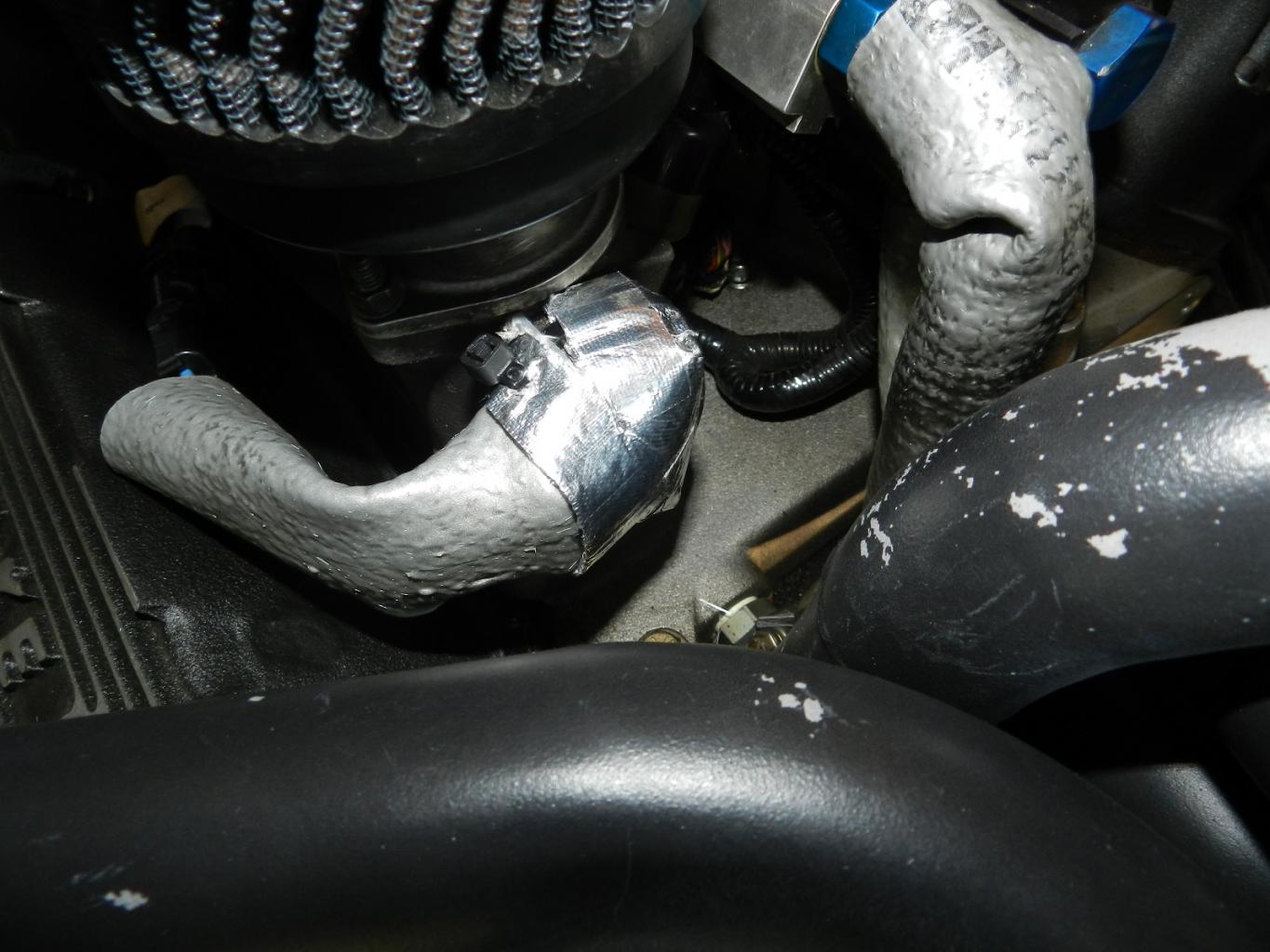

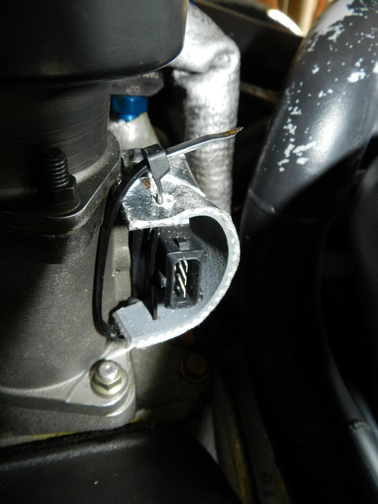

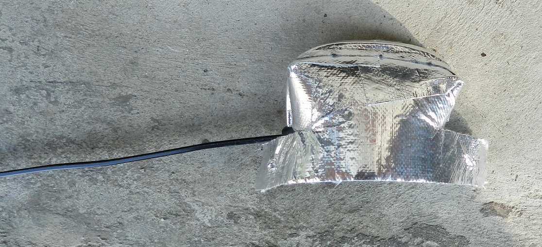

To have a quick fix I made heat shield out of Koolmat (KoolMat Hi-Tech Heat Insulation).
Will see if this changes something....
Markus
SPRF40
Short Feedback.
The heat insulation obviously helped.
After driving today the TPS voltage stayed exactly the same (low setpoint).
