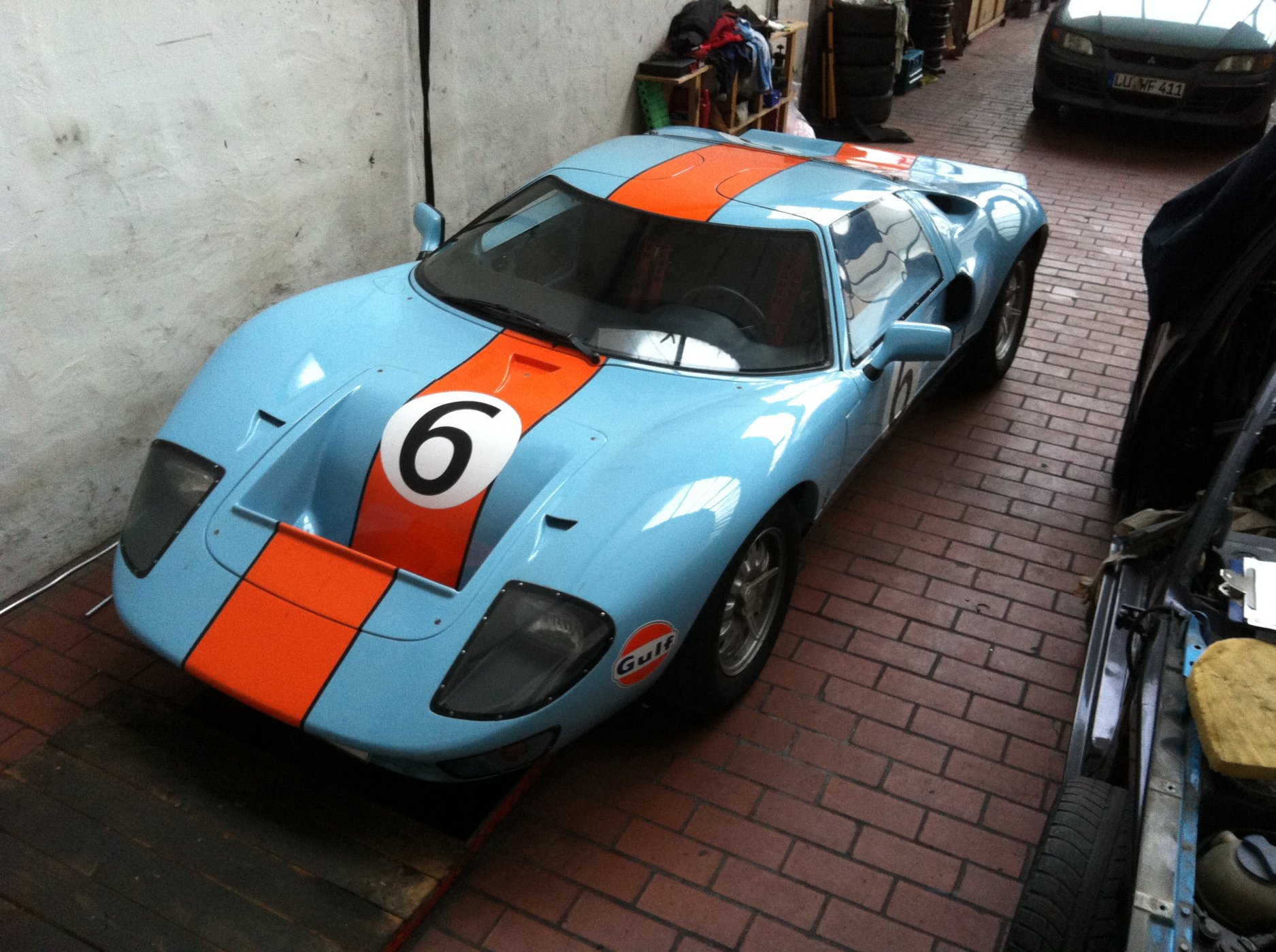

Hallo Jiri,
unser GT40 ist noch nicht fertig. Die Anpassungsarbeiten an der Karosserie nehmen schon viel Zeit in Anspruch.
Gruß Frank
Update:
.....Working on the doors for a perfect size and gap dimension....
clad the plates at the door area with black leather, cover for the tank sender and protective strips ( stainless steel )..........
....making a ventilation hole in the front area.........
The wheels with tyres............but i think i must change the front tyres in a smaller diameter.......now 215/70x15.........change in 215/60x15
HI Franky, the standard size for the fronts is 215/60/15
The build is looking great, you're making excellent progress :-)
