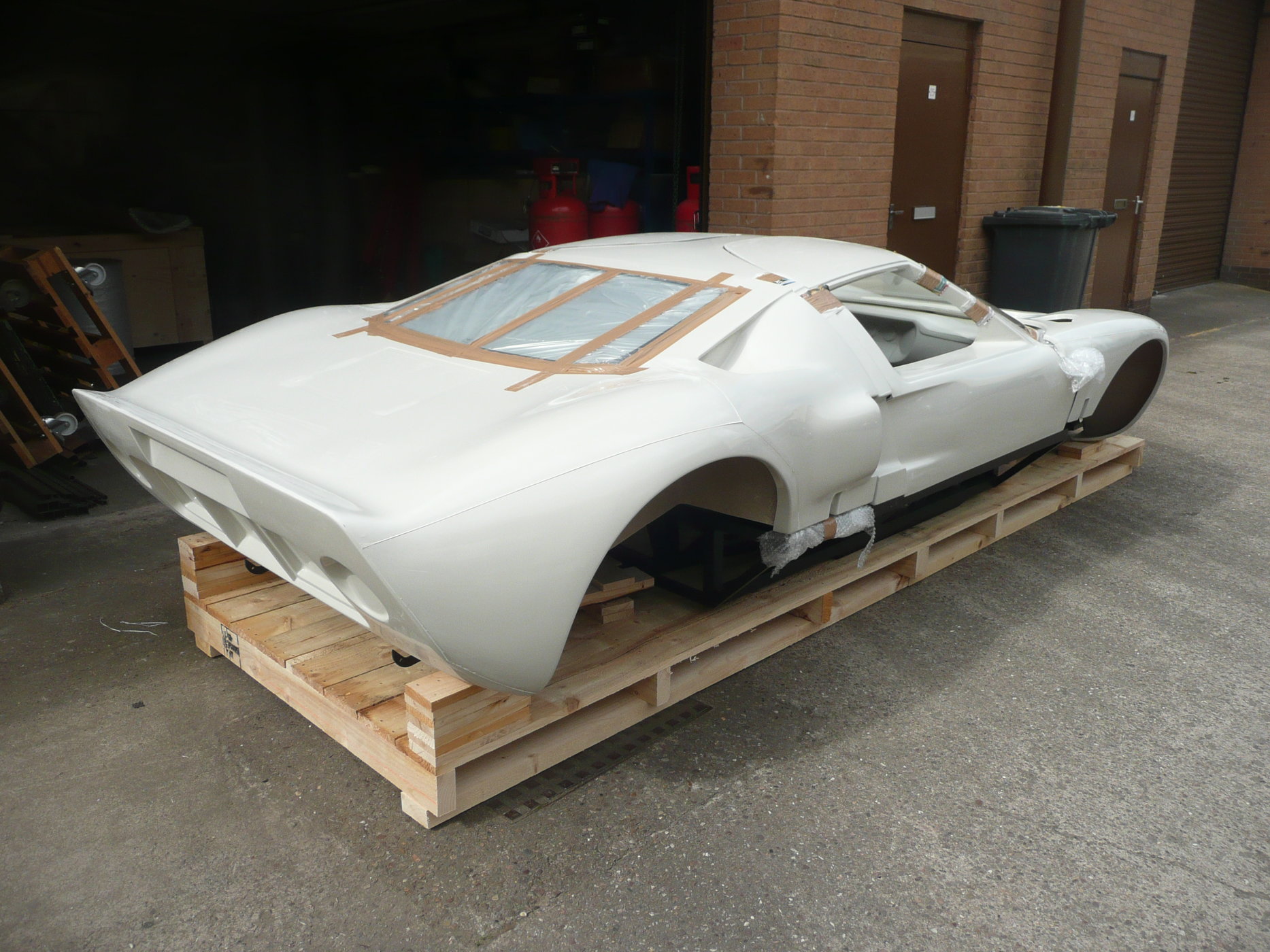

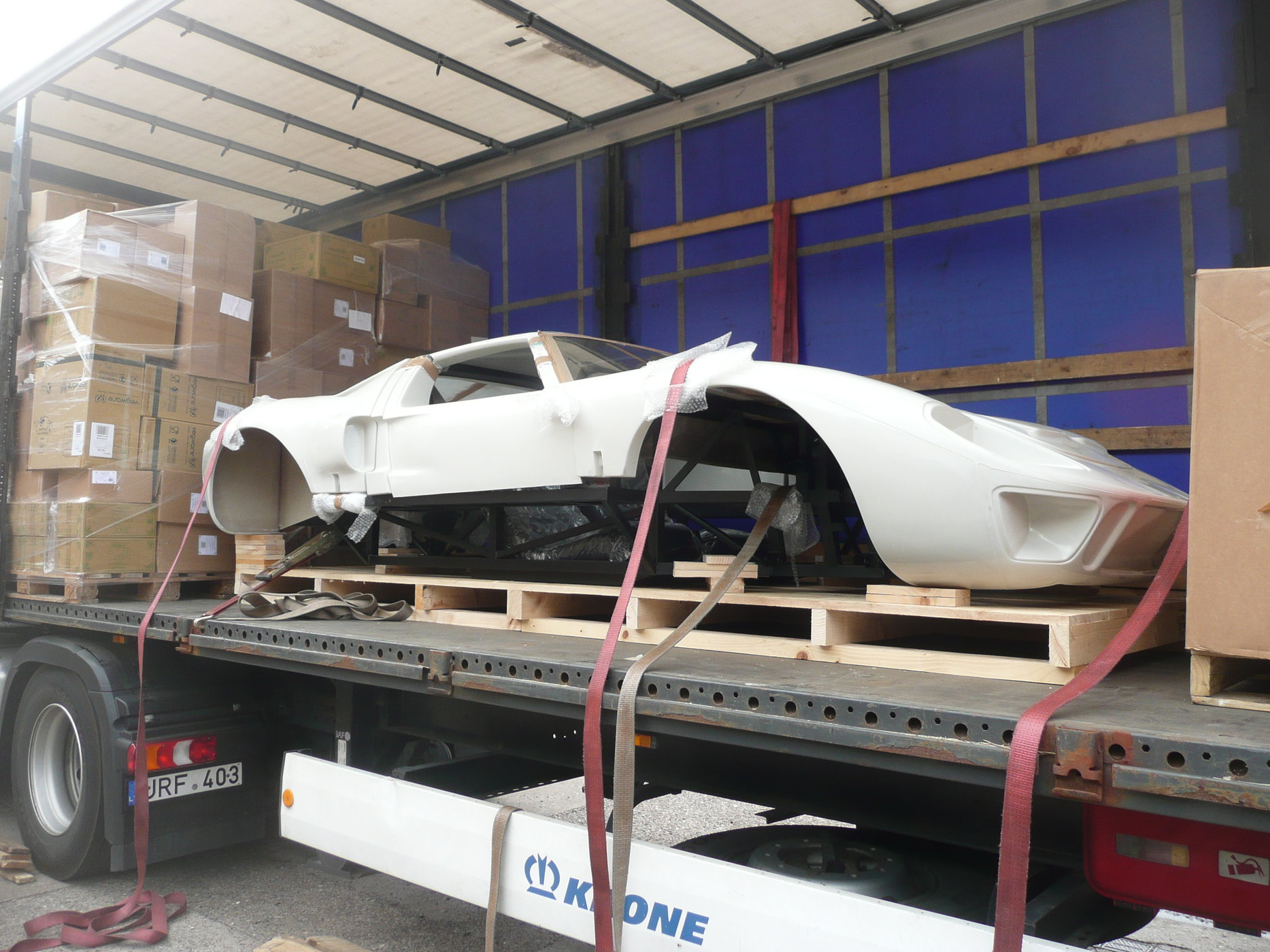

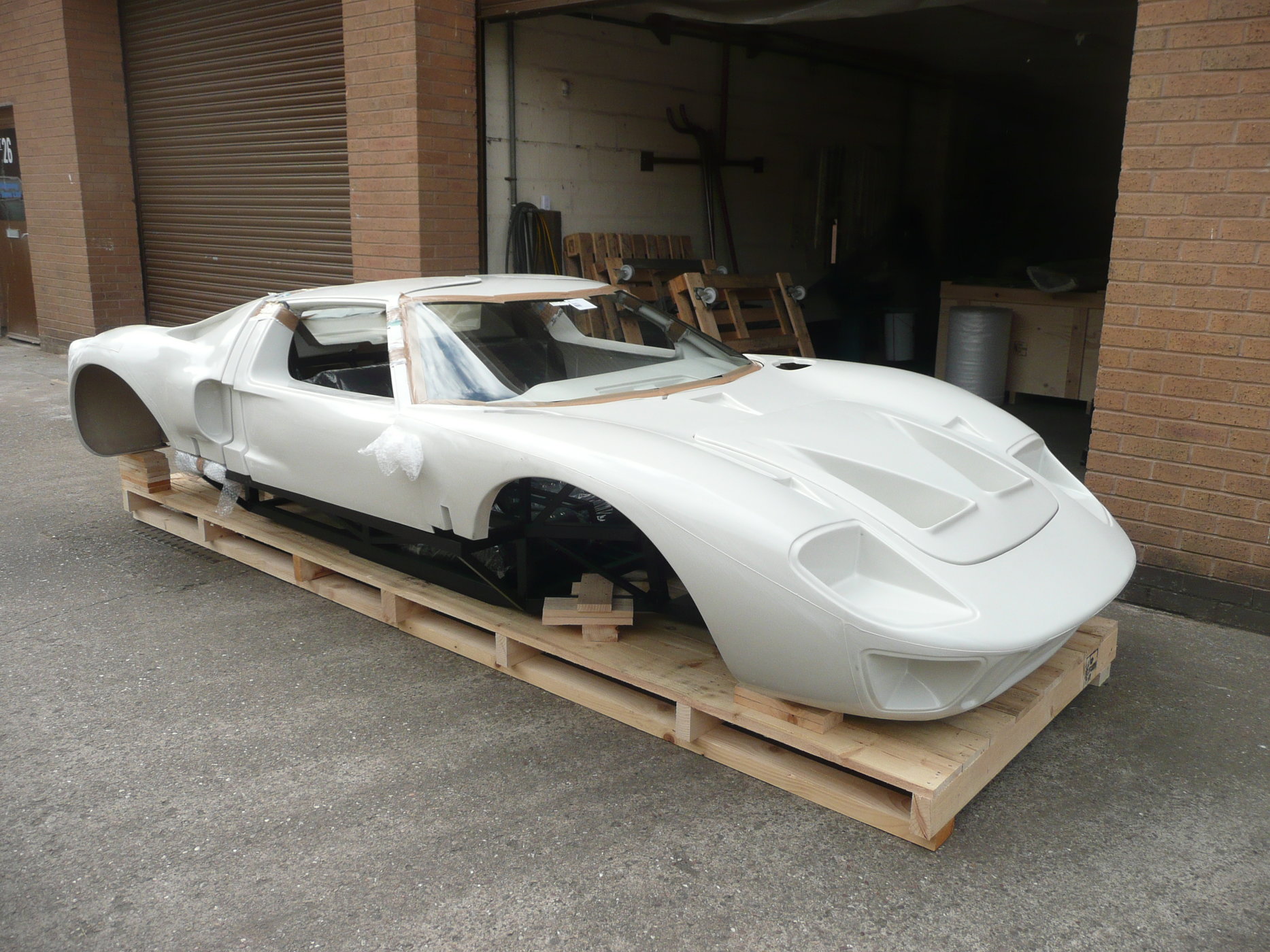

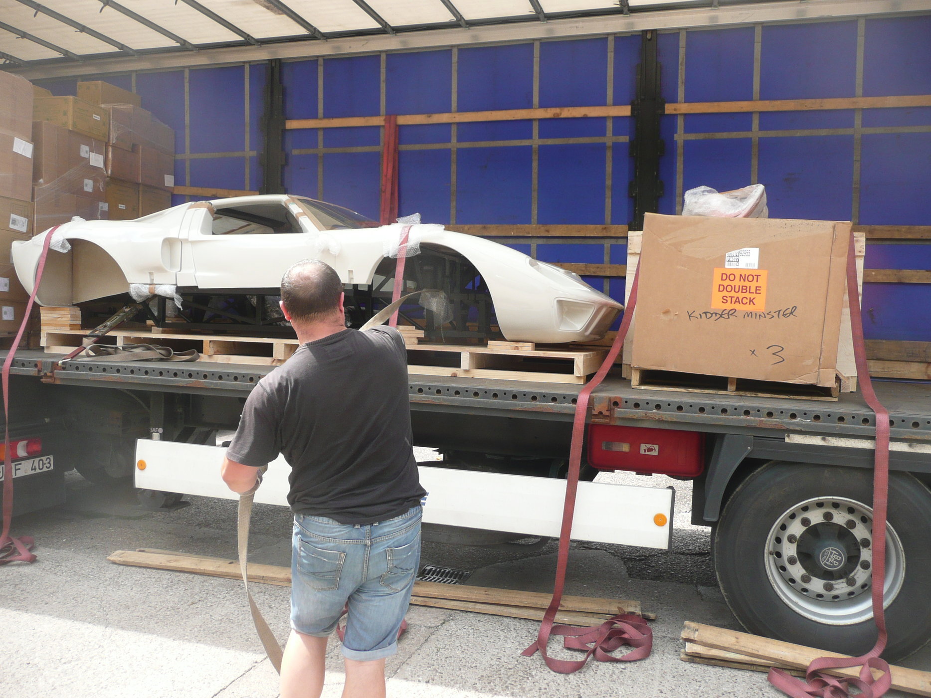

Oppening the wood box. All parts are in very top condition.
Every individuall agreement ( Glass rear window, bulb, gulf rear vents, etc. ) was taken into account. Till now only the condenser i didn´t found.
Every parts are inclusive all screws, nuts etc. Every bags are marked and labeled. The powdercoated parts are packed with newspaper. Very nice. I can really recommend the Tornado Kit from Andy.

Very nice Franky
Could I suggest you place the windscreen in the "spider" as the fiberglass can distort slightly and then makes the glass fitting a real pain later on
Fix with masking tape or similar.
Franky. That looks a great package. ;-) I'd suggest at this stage you don't put too much faith in those chassis stands. They look very "lite". Suggest something far more sturdy before you start progressing.
Keep the posts coming.
