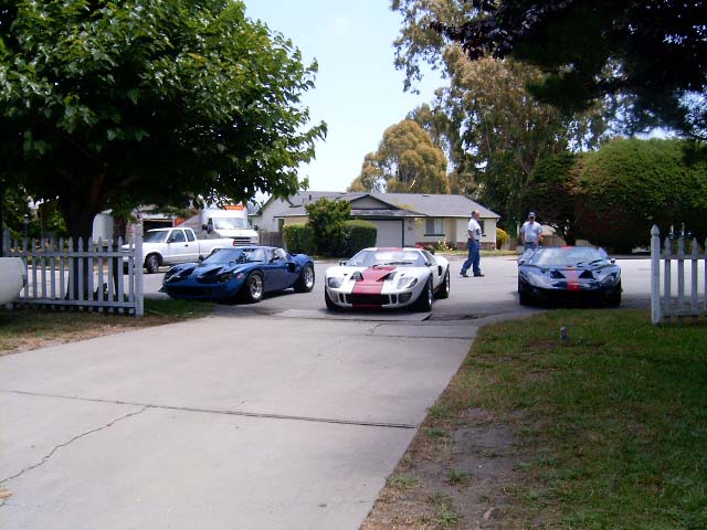

Me and bud took a drive down to Monterey to say hello to Chris, and to let me put a couple of hours at a time on my newly built engine.

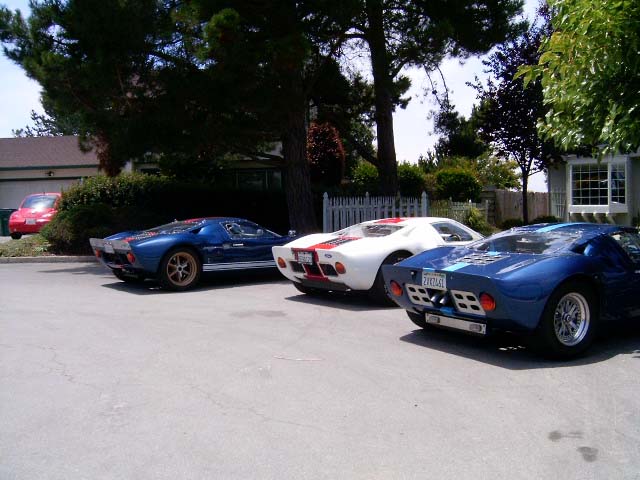

After all the trama poor Betty went though she doing very well now. Runs real strong with her nice reballanced motor. Not quite enough time on her to get her a real go but she seams REAL WILLIN.
The weather got a little warm cooming back and I got a first test of the cooling mods I've done. With air temp at about 93F ish I had a water temp about 185-190. Oil temp about 180F and rock solid. No big temp spikes with sitting still or putting my foot in it either.
All in all the old lady is runnin just fine.

Howard,
Some good pictures there that have me intrigued. Is it a trick of the light or are you running with canard wings on the front to increase front downforce. I notice that you have also added the alloy flap to the rear thus adding to rear end squat potential. What improvements to handling have you encountered please with both systems in place ?

Relax, Brian, those west coast guys get an extra 9 months of building weather each year, that's why they all drive GT40s to their get-togethers and we drive Hondas and pickup trucks. :)
Howard Jones
Yes I did put on some canards. I haven't had the car on track yet so I really can't tell you if they have had any effect that would be felt at road cornering speeds. The idea was to balance the aero on the car with the rear adjustable plate.
The adjustable plate on the rear of the car does have quite an effect as I have had it on the car for a couple of years and I've fooled with it's setting from time to time. I haven't seen much effect below about 80MPH but it will create quite a bit of down force above that speed. It is adjustable from 0 inches to 3" of height. At full effect I can feel the increased drag at freeway speeds, 70-80 MPH, I currently have it set to about 1 1/2" as kind of a middle setting.
It also makes a very nice license plate mount.
