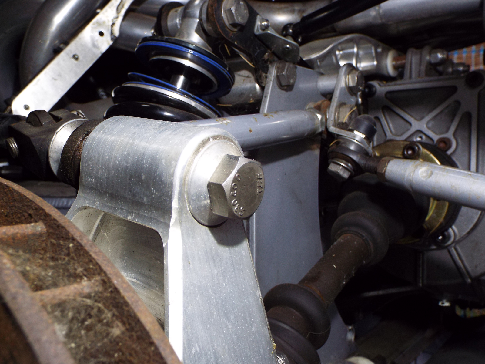

Thanks for the advice everyone .
Looks like I need to do some shopping then . I would think they were used because 8s are near impossible to find over here.

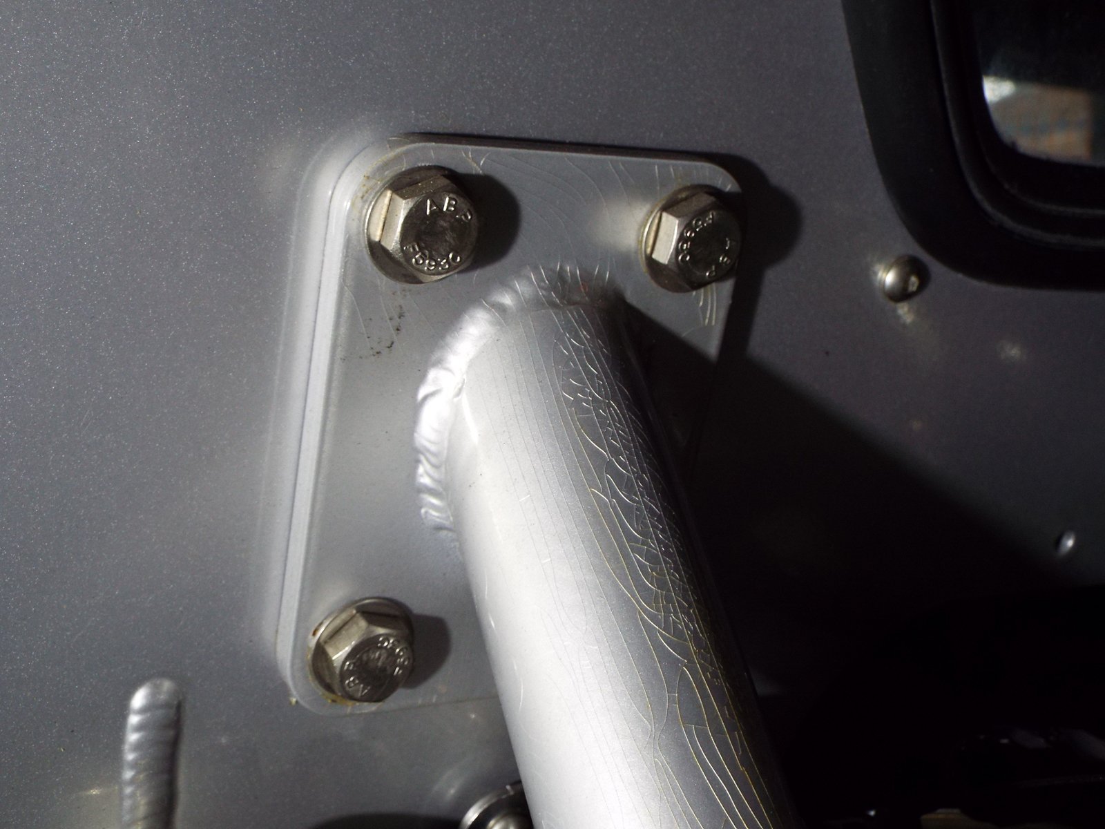

Most of the fasteners look like 304 apart from the two on the lower rear wishbones , brake discs and caliper mountings .
Engine mounts too.

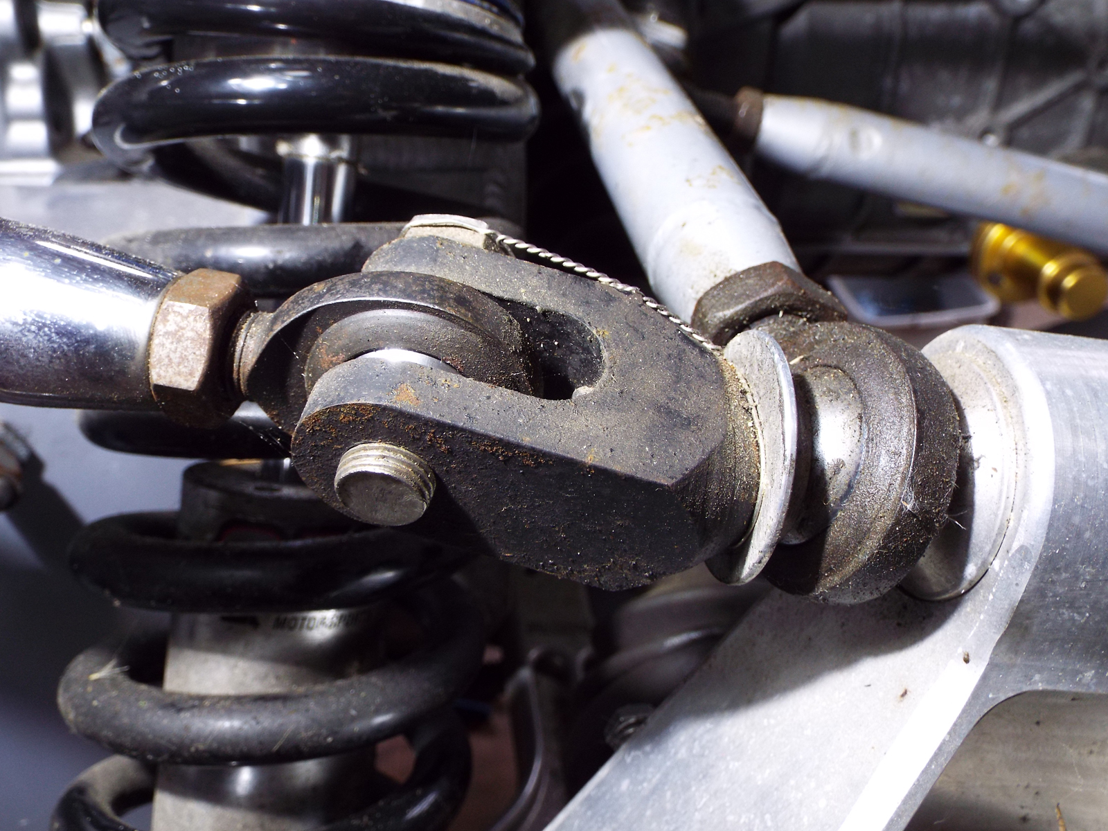

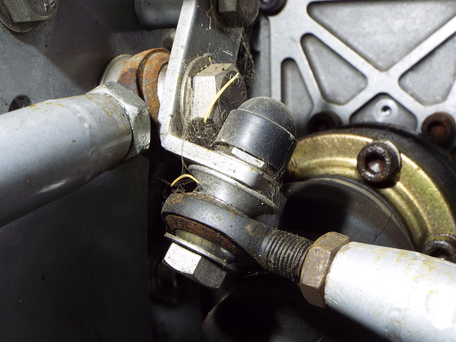

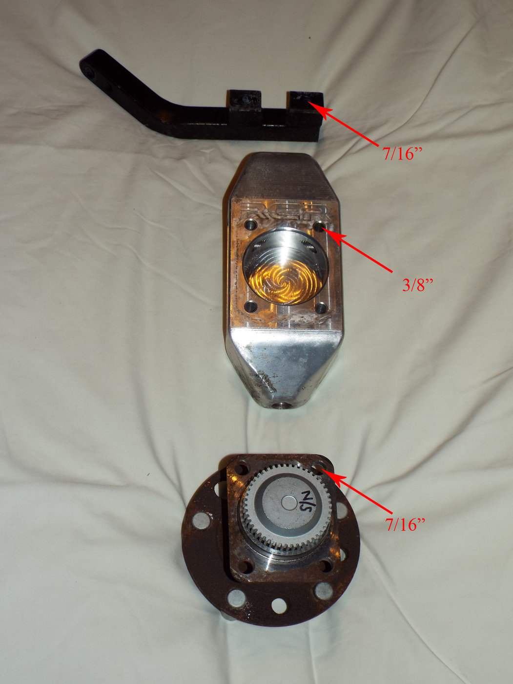

On the same subject of fasteners , I noticed the front hubs and steering arm holes are larger than the holes in the part they fasten to ( using 3/8" bolts ) . Should I leave this as is or enlarge the holes and use 7/16" bolts ? Any thoughts ?
In the second pic, is this an acceptable way of doing this ? Usually bolt goes right through and uses a locknut , not threaded into the hole.

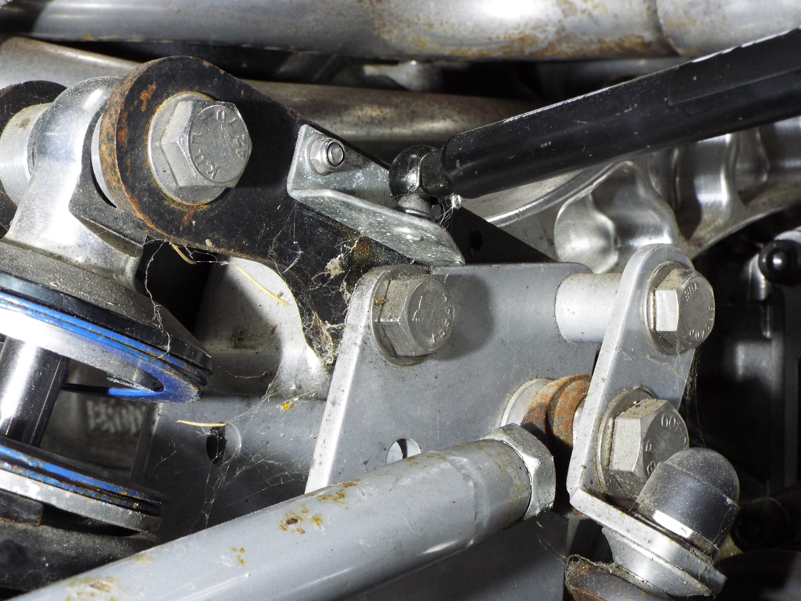

Other four pics are just examples of fasteners in various places

There is no reason to use anything except grade 8 on any part that will kill you. I call them itwillkillyou parts. But they are more or less all the suspension pieces that keep the wheels on, steer, brake, power transfer, and safety equipment.
On pic two: I would use a longer bolt and a 1/2 height lock tight nut on the outboard side with a washer under it. Pic 3 is close to too much threads showing on that rod end. pic 3 and 4 you need these: Porsche part

For a street driven car I wouldn't rush out and replace all the 1/2"-20 stainless fasteners since the sheer size of those bolts makes the joint reasonably strong but I'd replace them when it is possible to do so with something better. I wouldn't risk running on a track with SS bolts, though. Notice that the chart in that website shows that even a grade 5, 1/2"-20 bolt has an ultimate tensile strength of over 18,000 lbs and over 14,000 lbs shear strength so no need to panic- just replace them and hope the previous owner used Never-Sieze on those threads.
Regarding your question about mismatched bolt hole sizes: Never fasten two parts together with a bolt that is undersized in one hole! You have two options, first, as you suggested, machine the 3/8" hole to 7/16" or sleeve the 7/16" holes down to 3/8". This is not a good idea. Having the larger bolt will give you a stronger joint, plus the sleeve would need to be an interference fit (be pressed into the hole).

Ed - before going out and machining your upright or making bushings, take a close look at how those parts are to be bolted together. The bolts there may take zero shear load and therefore don’t need to be sized the same - I can’t say for sure since I can’t tell how they all go together. I’m guessing the hub is piloted into the upright and that all shear loading is taken up by the bearing and pilot, not by those 4 bolts. There’s also an aluminum upright being mated to a steel hub; different materials, different CTEs. Ed - If you don’t understand what I mean by this paragraph then find someone who does and have them review your car. Either way, I’d check with RCR if you don’t understand what’s going on here.
It’s exceptionally difficult to manufacture an assembly using multiple sources and assume that every piece made by everyone will be exactly the same each time - every component will have some type of manufacturing tolerance. So RCR likely designed the upright to use a 3/8” bolt knowing that the hub would be machined with 7/16” holes of unknown positional accuracy - the smaller bolt ensures that any hub you purchase will fit, now and forever. If I were designing this assembly I would make the hub fit almost exactly and allow the bolts to vary - shear loading taken by the pilot, axial loading taken by the bolts. Making all 5 exact would be an exercise in futility and extremely expensive.
I can think of a thousand places on my car where my holes are purposely mismatched (every single one). Every commercial and aerospace product I’ve ever designed also employed non-identical hole sizes. I’m sure my manufacturing/production teams would have screamed for my resignation had I made any bolted joint a zero tolerance match.

Whatever the considerations others may put forth, I would not put a 3/8" bolt into a 7/16" hole. If precision is required, drill & install dowel pins & match-drill the bolt holes.

Going to match drilled or pinned holes without understanding what’s happening is also another terrible idea. Let’s say Ed match drills his uprights as you suggest - you did recommend that he modify his hardware to match hole sizes. 2 years from now it seems his hub has excessive play and he needs a replacement. Wouldn’t you know, the new hub no longer fits because his previously match drilled holes don’t line up. Should he sleeve his upright to match the new hub, or should he go to en even bigger bolt. 4 years from now, what should he do?

PS, the hub bearing outer body sits into the upright and that is what locates it in position and takes all of the lateral loads fore, aft, up and down. The four bolts clamp it in place (in and out) and prevent the bearing from loosing it referenced positioning in the upright. Use grade 8 American made bolts, locknuts, and washers for the four bolts and you will be fine. HOWEVER!!!! they must be kept tight! Check them a lot at first until you known they remain that way.
