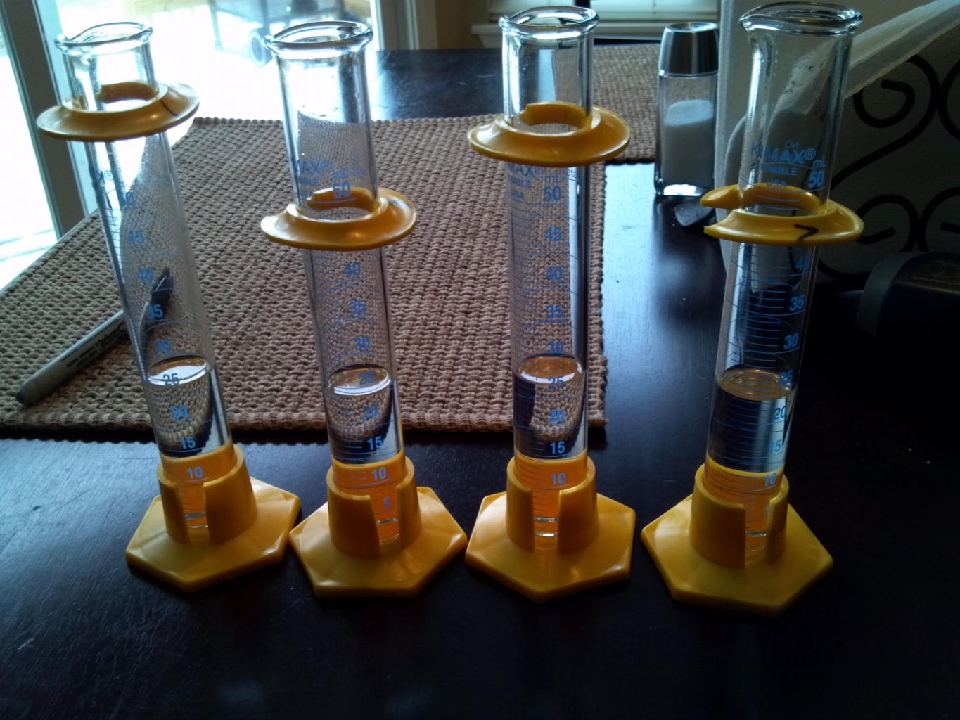

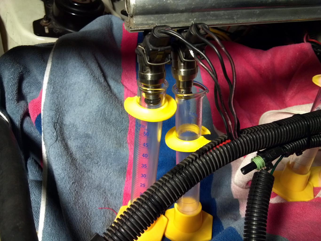

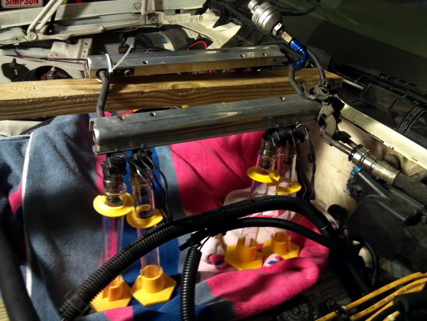

Well, pulled off the intake and everything looks ok. While I had it off, I decided to test the injectors just to erase any doubt they could be a problem. I had already swapped them around without any change, so I was pretty sure they were not the issue.
Attached some pictures of my injector test. I found that the injectors are more accurate than the graduations on my cheap graduated cylinders...
I'm thinking that, through the process of elimination, I have some bad lifters and that's whats causing the problem.
