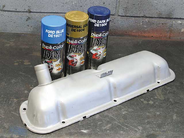

I ran across a set of stamped steel "Power by Ford" valve covers which had been cleaned and refinished and I bought them. Are there any photos which show these as original fitment on sixties GT40s? I guess my real question is: what DO original GT40 valve covers look like? Given the large number of variations on these cars, I find it hard to believe that there would be only one original fitment. I AM familiar with the ones that have the box-like breather built up on top of what appears to be just a stamped steel valve cover (I had a chance to buy a set from Bill Wonder a while back and I am kicking myself that I didn't do it).

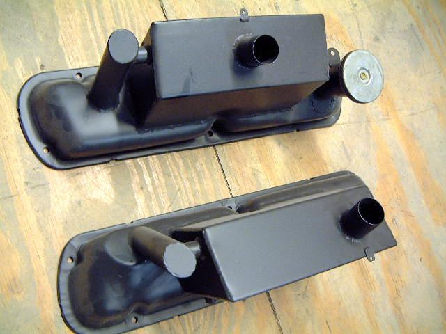

They look like this.
Although some were standard tin ones from the HiPo heads

'They' were from the first 221/260/289 steel covers, no names, no logos with filler/breather fittings @ Rear on both sides. Same style of pressing as attached Daytona pic.

These are made from the same stuff, I think, but they say "Power by Ford" on them, stamped into the tin.
It looks like the breather box arrangement has to do with ventilating crankcase pressure, or returning condensed oil to the engine- kind of like a catch can built onto the vale cover, Am I right?

The "Power by Ford" embossed valve covers started in 1967. Early 221-260-289 tin covers did not have oil breather/fill tubes as the oil was added via a tube in the front cover. Circa 1965 they added the filler tube/breather on the valve cover and dropped the tube in the front cover (also when the changeover from generator to alternator took place).
The tin cover genrally will not clear roller rockers but you can add an aluminum spacer that is available.

Turns out the valve cover spacers are available from Ansen; I got a pair through Mustangs Unlimited. I am going to set a set of the repro tin valve covers, either gold or dark blue, from the same source. With the spacers, they ought to clear the roller rockers. The PBF valve covers will end up on the Kirkham Cobra's engine, once we get them cleaned up and repainted. All of this is just details, I suppose, but why not.
It turns out that the original oil-box covers that I passed up from Bill Wonder wouldn't have fit in any case- they would have required the spacers which would have made the overall height too much to fit under the rear bodywork, I think. Although the box design is kind of cool in its' own way.

Can you explain the function/plumbing of these original valve covers? What is the purpose of the two tubes which rise from the end of the valve covers, but are capped off? Did the boxes in the center have hoses which went to a catch tank, and if so, what did it look like?

I have a original pair of Hi-Po valve covers I would like to convert to the optional GT40 "race" valve covers with ventilation boxes but am lacking info also.
Looks like push-in breather caps on both sides and a raised oil fill pipe away from the headers on the right side (chained cap in case of the 'ooops')?

I used valve covers like Jimmymac's photo. There was a clearance problem I resolved by slight flattening of the baffles (a little modeling clay between rocker and valve cover) with a hammer to clear the roller rockers. I also ordered the spacers but could not tolerate the appearance and returned them.
