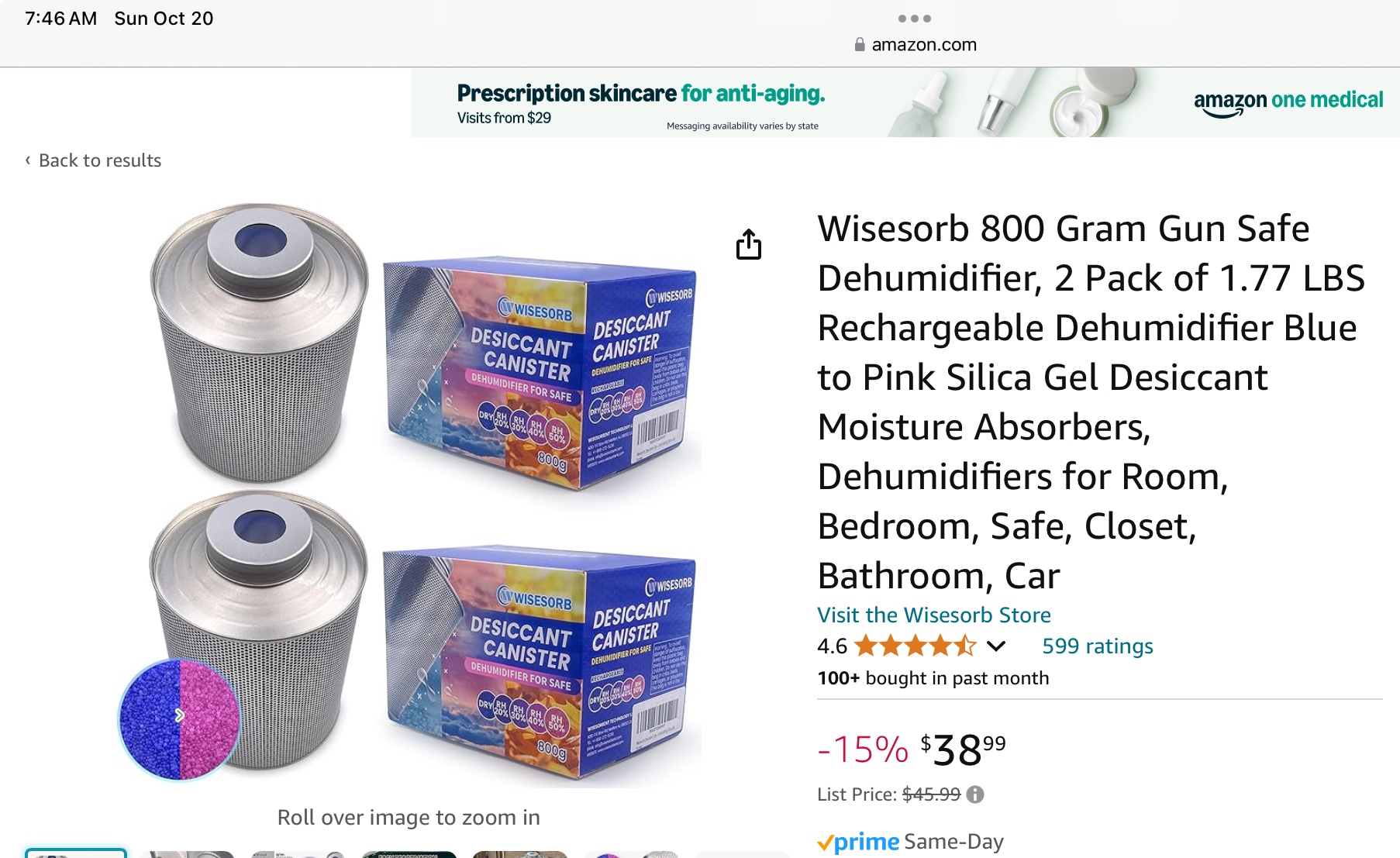

On another note - after having had one of my cars totally inundated with mold one year, I found these rechargeable desiccant cans and I put one in each car. No more issues…
Link ::
