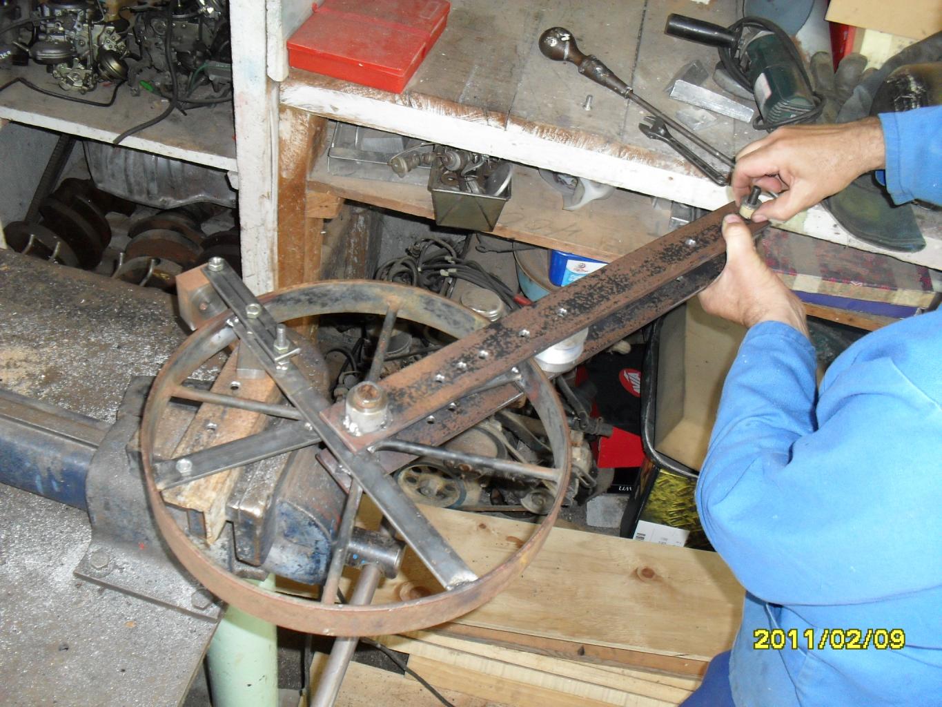

I bought this vice about 35 years ago. Am still using it without any problems. The width of the jaws are 6 inch. Notice how it is fabricated from what looks like mild steel. I once broke off completely the top jaw of a vice that was made of cast iron. If I ever need to buy a vice again I would go for this type again.
Any how this is my 2 c
