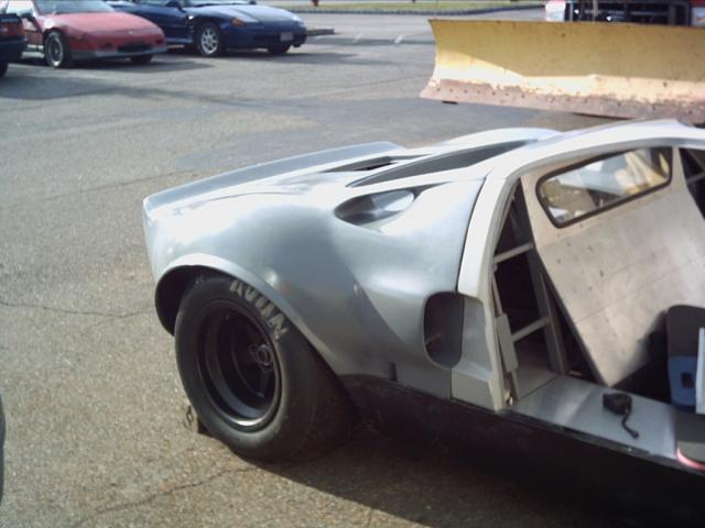

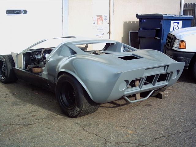

My rear bodywork has an inner panel in the arches so the vertical clearance decreases rapidly as you move towards the outside of the bodywork. Here is a photo that shows my trial fit.
Most of the side profiles I have seen show a similar amount of clearance between the top of the tire and the bodywork.
Hope some of this helps.
