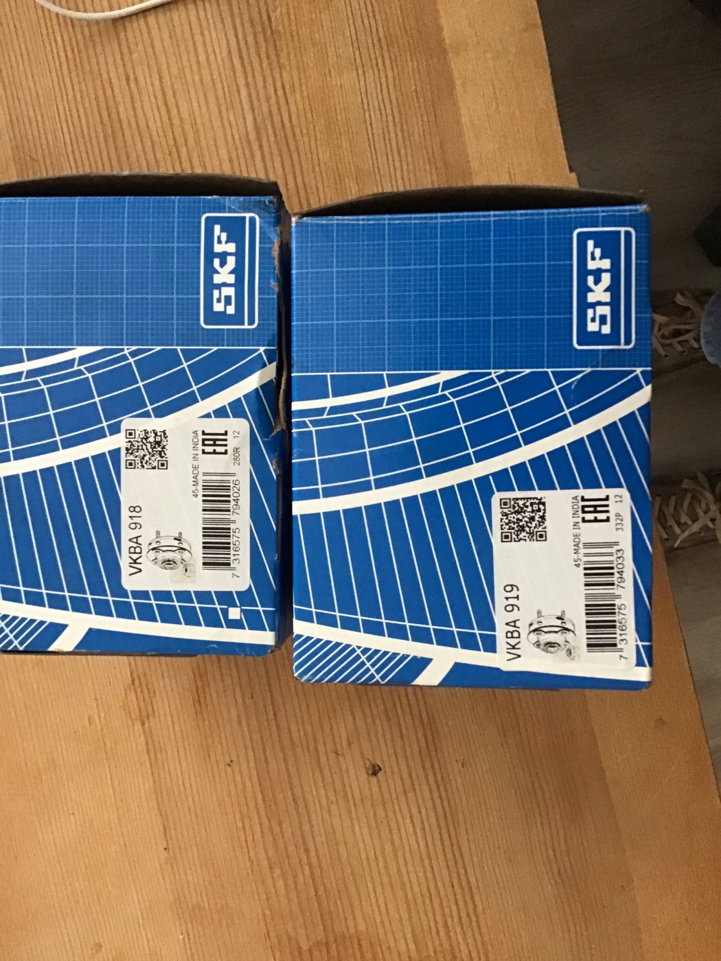

Hi All,
i have ordered this week bearing kit for my sierra rear wheel hubs on my old kva.....
the sierra uprights or scorpio are 5stud (5X112) and have abs sensor axles
for this combo i found SKF VKBA 918 AND SKF VKBA 919. And one is lefthand tread 22 X 1,5mm (same size as normal tread )
Paul
