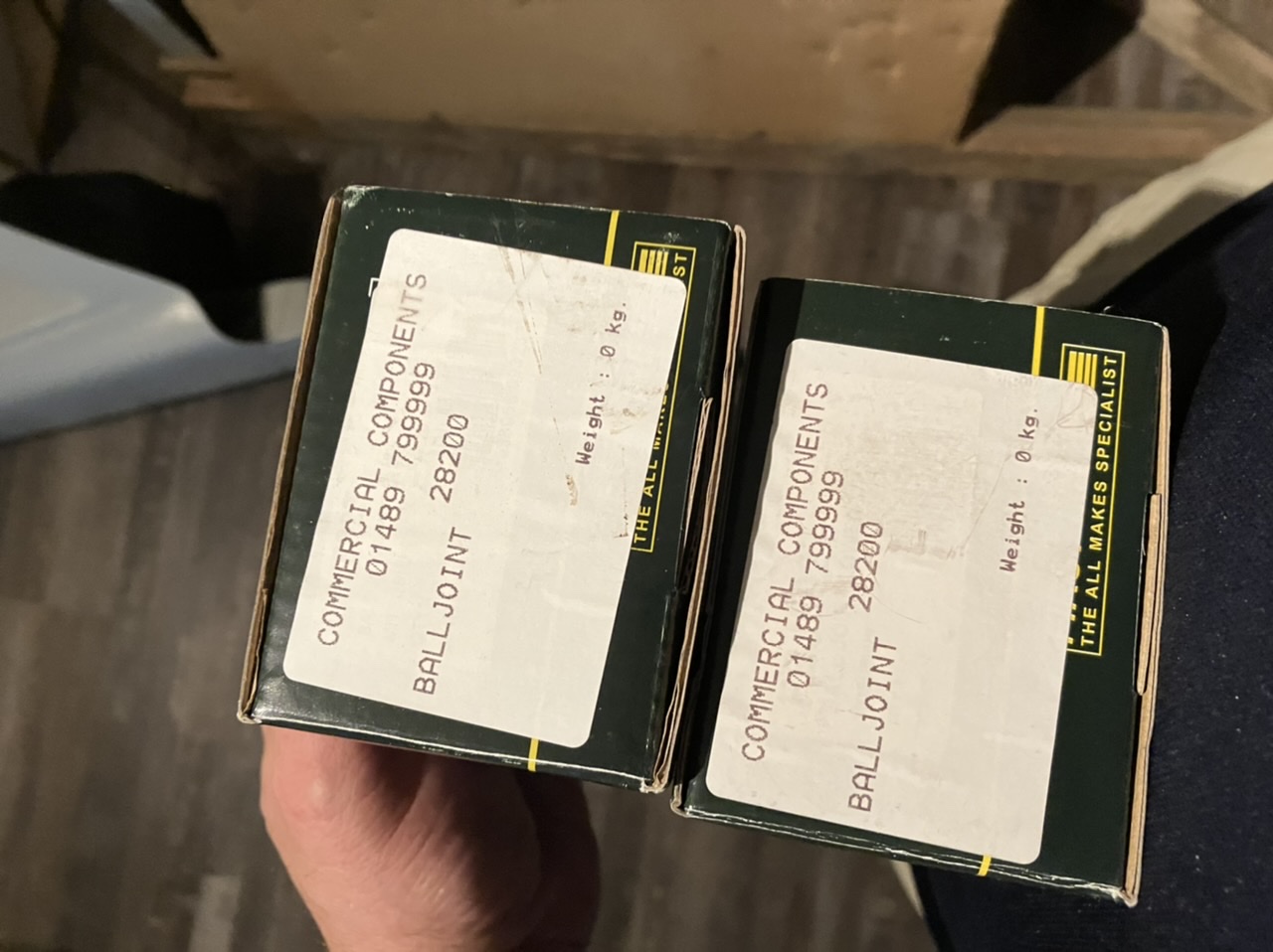

Davidmgbv8

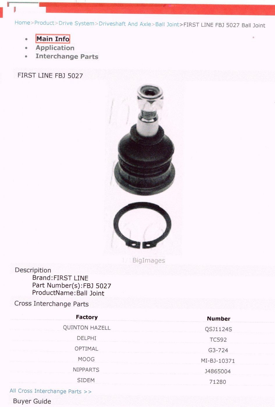

These boxes were in my SGT crate though they were already installed in the A arms, went on Firstline web site and looks like what is there.

Thanks David!!!!
I've deffo got the SGT ball joints. I'll see if I can get hold of one of these.
