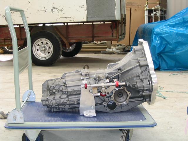

which audi 6 speed diesel box for my 302?
i bought a brand new box from germany from an a8 6 spd manual with code edf which is the one with the built in oil cooler pump not all of them have this feature.

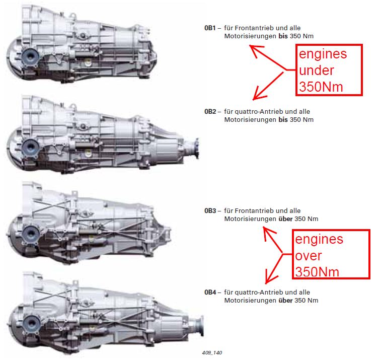

http://www.vwclub.bg/~dragocl/pdf/SSP/ssp429_d.pdf
http://www.vwclub.bg/~dragocl/pdf/SSP/ssp392_d.pdf
http://www.vwclub.bg/~dragocl/pdf/SSP/ssp409_d.pdf

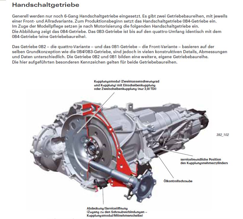

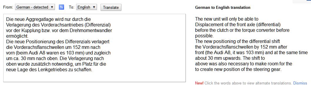

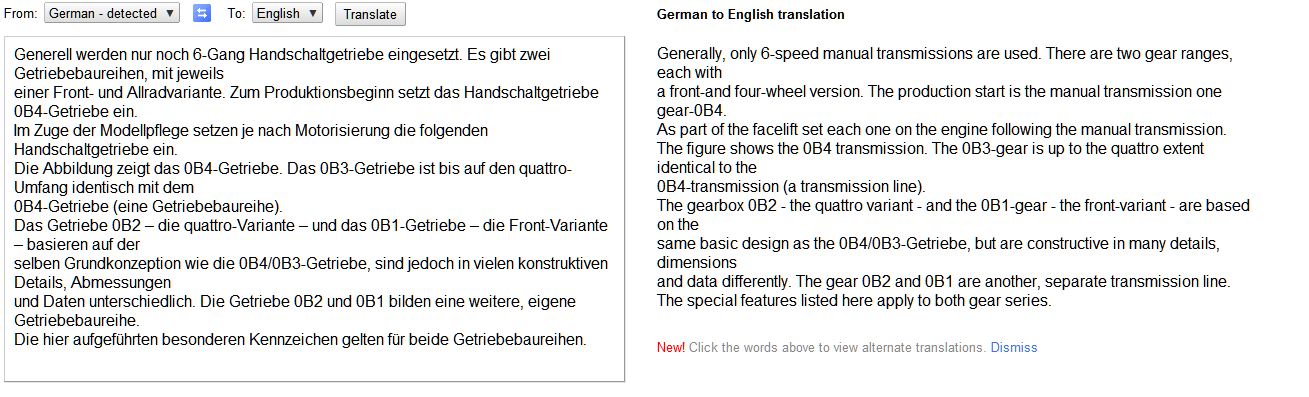

Using Google Translate :
The production start is the manual transmission one gear-0B4.
As part of the facelift set each one on the engine following the manual transmission. The figure shows the 0B4 transmission. The 0B3-gear is up to the quattro extent identical to the 0B4-transmission (a transmission line).
The gearbox 0B2 - the quattro variant - and the 0B1-gear - the front-variant - are based on the same basic design as the 0B4/0B3-Getriebe, but are constructive in many details, dimensions
and data differently. The gear 0B2 and 0B1 are another, separate transmission line.
I guess that means that the 0B4 and 0B3 are identical apart from Quattro and the 0B2/0B1 are similar to 0B4/0B3 but have different ratings and gearsets.
Looks like the 0B3 is the one I need.

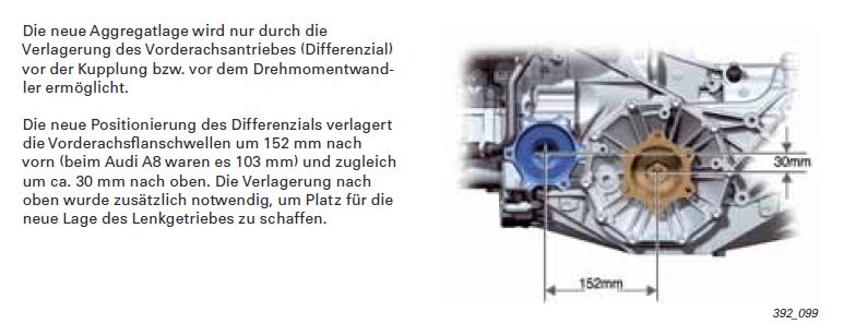

It also shows how much they moved the driveshaft forward, and up.
