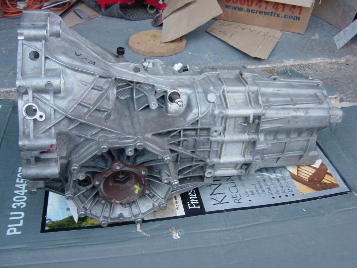

I have an Audi 01X with the FYA code (I am still building). Its from a 2003+ Audi A4/A6. My installation uses the Kennedy Audi 5000 adaptor plate, flywheel, pressure plate. ALl you will need is a drive plate made up and a different spigot bearing adaptor and needle roller bearing.... and probably a rebalance of your engine.

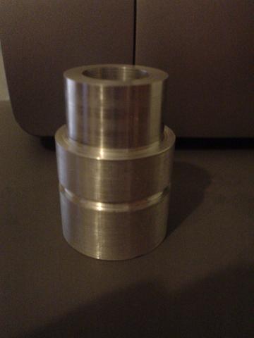

Where did you source the pilot bearing? Did it require an adaptor or something due to difference in shaft length? Was that the only change from an 016 needed to install it?
From the picture, it appears the shift linkage would be in a different location than the 016 trannsmissions (gasoline engine). Where is the linkage located on yours?

I made the adaptor myself, see below. I go the roller bearing here in the UK from RS spares: IKO Nippon Thompson | Mechanical Components | Bearings and Seals | Roller Bearings | Needle Rollers

Thanks for the info regarding the adaptor you fabricated. I was afraid of that. Don't have a machine shop in my garage. Wonder if anyone markets that adaptor?

Here's a couple of PDFs that may help you out. 1 is the drawing I did for the adaptor. If all else fails I guess you could get someone with a small hobby lathe to turn it up for you (ignore the material bit, I ended up using some bar I just had laying around, I only have a hobby lathe). BTW no guarantees on the dimensions etc You'll need to check everything first
The other is the rough drawing I did for Helix, who made my drive plate up. The input shafts are in a different place (and size, the 01X has a bigger shaft and spline).

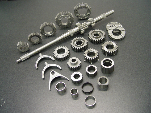

It has taken some time, and with the help from Pfitzner Performance Gearbox (PPG), we have come up with a straight cut dog gearset for the 01E. These can be made in helical as well and synco. The reason I went this way is for the simple fact that I don't want to warry about the box and I want lightning fast gear changes with better gear ratios.
I'll try to post some photos of the actual gearset (they're over 2m each and I'm not sure if I can reduce them) but at this point of time, I can't comment on the performance as it's not in the car as yet. Once in the car, I'll start a new thread on the box.
