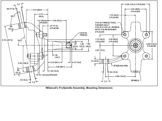

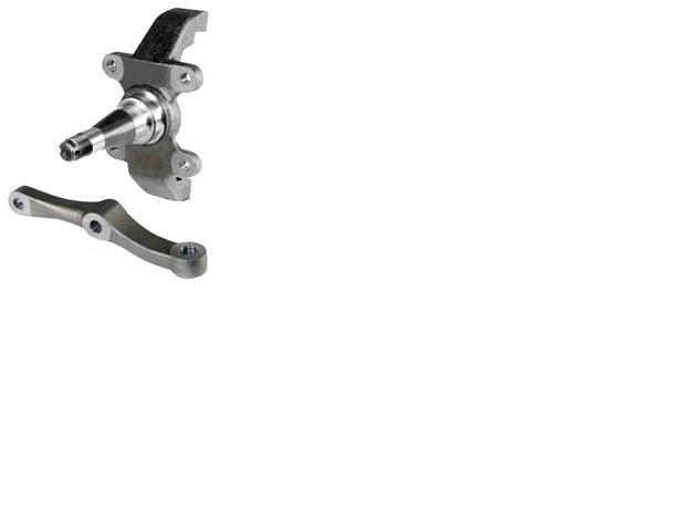

Has anyone used the Willwood pro spindles on a GT40.
can be viewed on Wilwood Engineering - Forged One Piece Steel 2" Drop Spindle
I am building a GT40NZ kit which uses Australian Holden HQ (GM) uprights and from reading the info on king pin angles thought I would go looking for an alternative. The Willwood is 11 degrees from their web site compared to 7.5 for the HQ
Another possiblibility is Ford Sierra which I am told is 10 degrees but have not had it confirmed.
Is there any others worth looking at ????
Has any body used Ford Sierra Uprights ????
