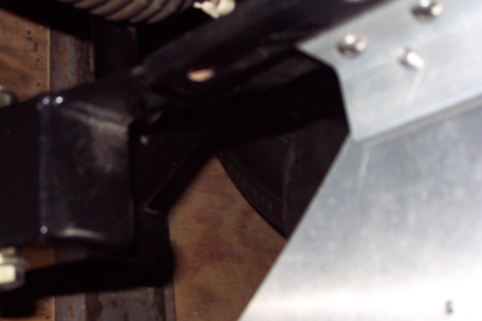

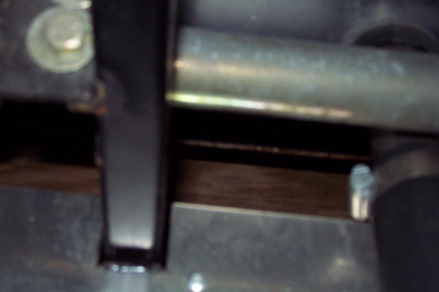

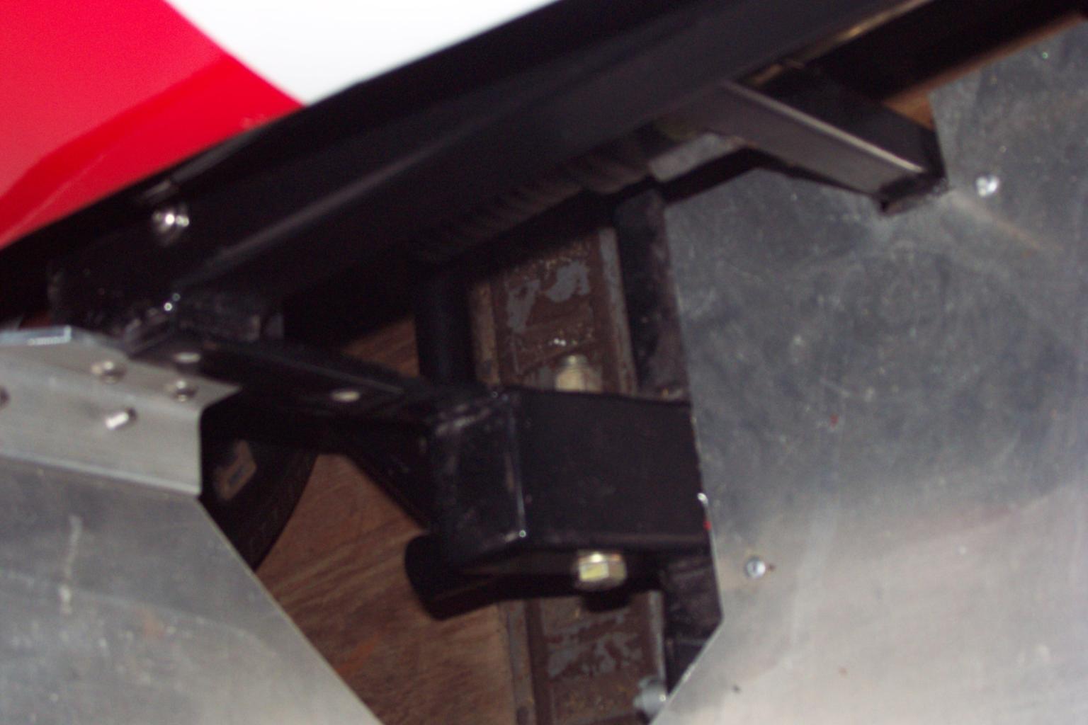

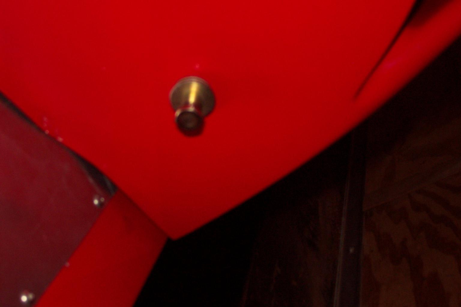

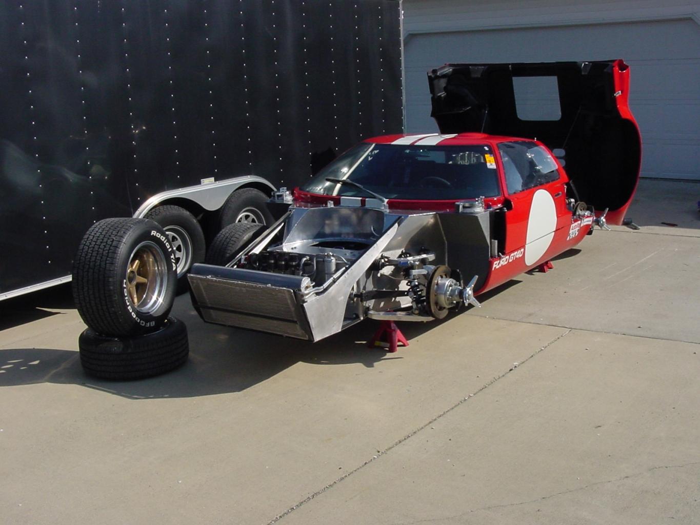

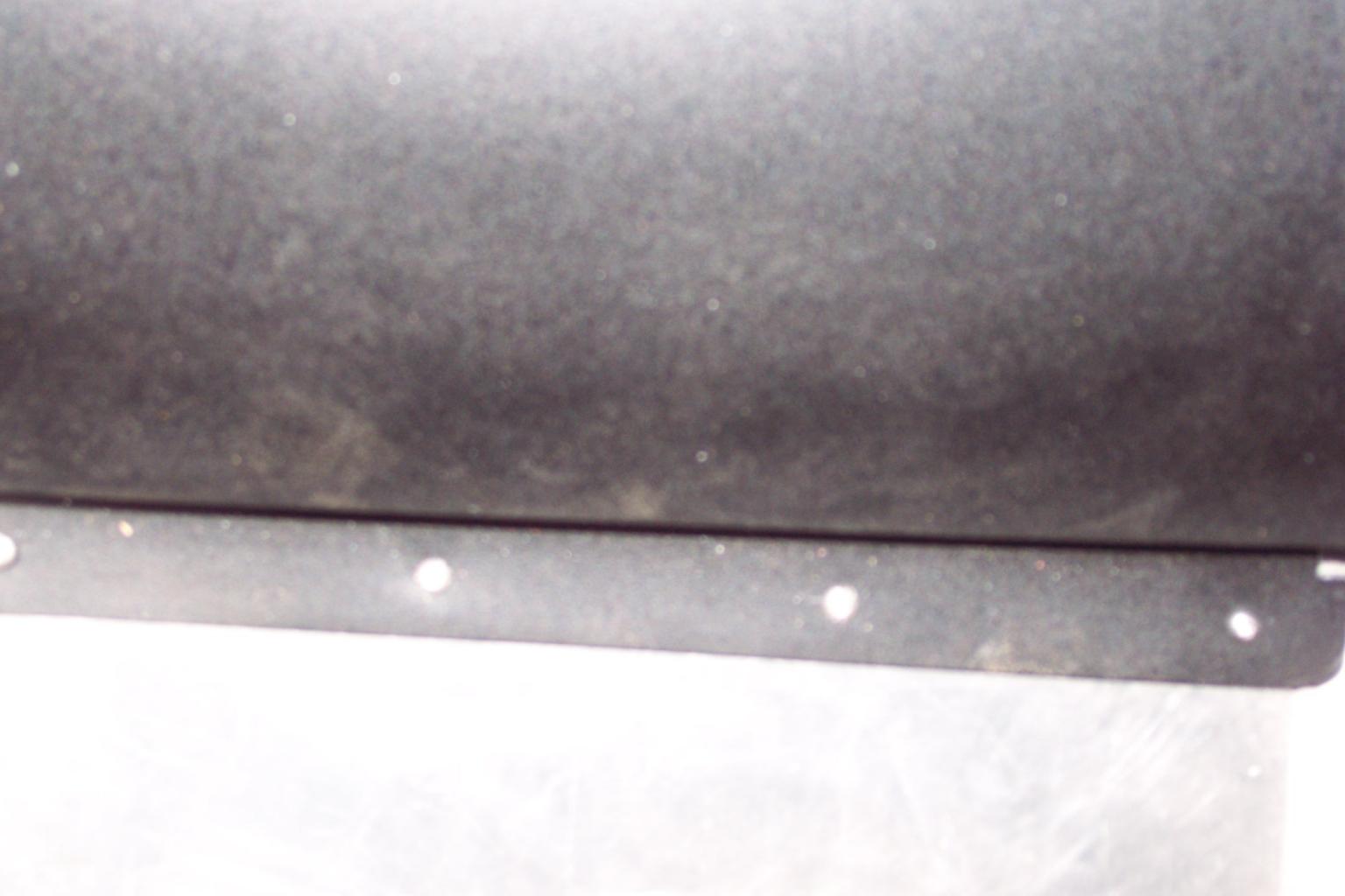

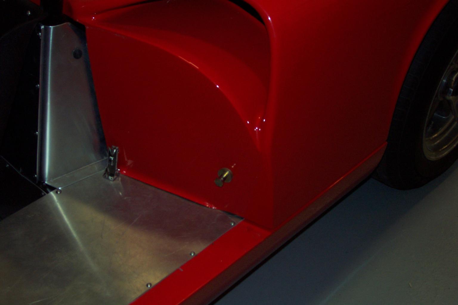

Would this car pass a technical inspection at a race track? Here are some pictures of my Lola T70 Spyder, which was built by a “professional” shop. The shop owner represents the car to be a “high quality build”. It lacks seatbelts, amongst other things. Barring the lack of seatbelts, would the car pass a technical inspection on the track?
The first pictures are pictures of the tail and the door locking pin affixed to the tail. When you close the door, it catches the pin affixed to the tail and the doors stay closed. The pin is not affixed to a stationary solid point on the car. If the tail is off the car, there is no way to keep the doors closed, so if you wanted to do some hot laps with the tail off the car and make adjustments, you can not do that. The tail is held in by quick pins in the rear and a single catch on either side of the car as can be seen in the first photo.
The next two pictures were taken looking down the nose panel by the radiator. As you can see, the aluminum paneling does not close off either side of the chassis as you can clearly see the suspension, car tire and plywood floor of my trailer.
The next picture was taken by putting the camera down the radiator cut out of the nose panel. You can see the radiator lines, steering rack, as well as trailer’s plywood floor, as the professional builder felt it unnecessary to aluminum panel the entire floor.
The builder had this car for over 4 years and feels I should be happy with the quality of his work.
So my questions are, would you consider this a “high quality” build and would the car pass a track technical inspection? If there are any NY DMV inspectors on the board, would the car pass a NY DMV road inspection?

I can't tell from your pictures but is the issue that you can see the trailer floor when your sitting in the car?
I didn't see Randy's post.
Maybe paint the trailer floor a nicer color ?
Seriously, the issues you mentioned with the car could be repaired at the track
in order to run for the weekend. You could strap the doors closed until you found a better way to secure them. Original T70s have complete aluminum paneling
but the coolant hoses run outside of them (and sometime scrape). What about other issues that have to do with track use ? What is the clearance under the oil pan and does it have a fire system and such ?
Where were you when the car was being built ? It seems a little late
to make detail changes. Did you buy it to sell it or are you selling it because you
are not happy with it ?
If you actually want a race car or even a track day car, then the day the car arrives from the manufacturer, whether that is Dallara, Lola, Crawford, Riley etc. is the day you start taking the
car apart and updating it. Racecars do not come brand new ready to race.
As a matter of fact, nothing is ever really ready to race, except that they just made last call to the grid !

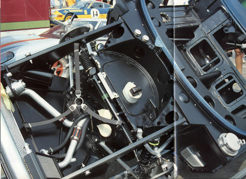

This a picture of the GT40 front end. The suspension is not totally sealed off. If you looked down the radiator opening you would be able to see the floor on this front end as well.
I have also seen quite a few FFR daytona's that run the upper radiator hose in the passenger tire well. The lower radiator hose on every cobra I have ever built has been open to the road below the hose. I have never seen a front engine car that had any type of floor extend under the radiator. I realize yours is a mid engine but the fact that the hose is exposed would not keep you off the track.
That is an honest answer although it might not be the answer you wanted, you would definately be allowed on the track.
Dean, I am only seeking "honest" answers. Based upon the picture you provided, I can not confirm any of your statements.
I do not know what answer you think I wanted, and as the photo's of my car show, there are no brake cooling hoses installed.
Perhaps you can answer these two questions for me. As you owned an RCR vehicle, (1) weren't the wheel wells completely paneled/sealed using aluminum? and
(2) wasn't your car's floor completely paneled/sealed in aluminum or was your car designed and built with a giant hole in the floor by the radiator hoses/steering rack?
Thanks, Gregg

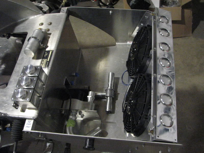

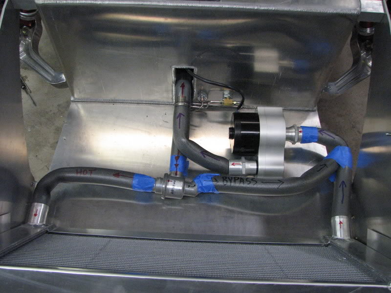

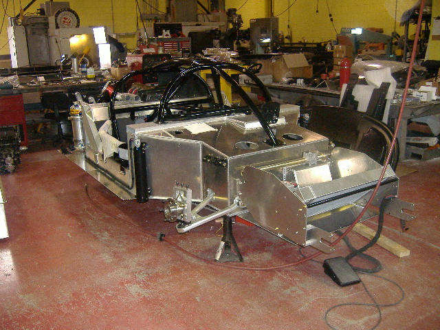

All RCR cars vent some of the radiator air into the wheel wells..similar to a modern Porsche Boxster...there is an open area in the panelling to reduce the air pressure under the nose panel...and prevent potential billowing of the nose due to enough air not being able to vent through the nostril/scoop/rad exhaust area...
Point in case...original Mk1 twin scoop nostril panels are not as efficient as the Mk2 single scoop.....
The better evacuation of air in the nose area of these 1960's designed cars also helped with aerodynamics...again the Mk1 vs Mk2 nostril panel is the perfect example...
There is no wheel well panelling on an RCR40 ....There is an open space above the radiator support side panels also..
Here are pictures of the RCR40 design...the third picture is of an original GT40 (black chassis)...the SLC has exposed steering rack, coolant tubes and is fully sanctioned by race organisations in the USA and happens to be National Championship winning car in the fastest class with NASA.....see last two pics.

Fran, thanks for the photos. They show that RCR panels the floor and protects the radiator hoses. It also shows the tub is sealed by the suspension pickup points. My car shows a lack of both.
Any idea why a builder would fail to skin the entire floor and protect the radiator & radiator hoses from street/track debris?
Any idea why a builder would fail to seal off the wheel wells and protect the suspension mounting points from street/track debris?
Any idea why a builder would mount the door locking pins to my removable fiberglass tail, instead of a fixed mounting point on the car like they did on Ron Earp's car?
Thanks, and I will look for your replies.
Gregg
The rad hoses are exposed on the SLC and run into the wheel wells...with no protection and no issues to date even during a 1000 mile race
The only area required by SCCA/NASA/NASCAR/IMSA et al to be panelled is the floor of the cockpit area.
Check the suspension pick ups on an original GT40...they are exposed...its good enough, and safe enough for a 4 time Le Mans winner...and many original GT40s from the 60's are still around with the exact same layout with no modifications made..even the continuation cars from SPF have this same detail.
Door pins are attached to the tail to prevent the tail blowing open as the tail cannot be opened with the doors closed....redundant safety precaution,there are two over center latches plus the door pins, as one never knows when a tail section may not be properly latched and the driver pull away and lose the tail section, many GT40 owners can attest to this being a real issue, same goes for Ultima GTR owners. The SL-C has a similar redundant system...the tail cannot be opened without the doors first being opened..
Rons car has two tubes that will prevent the tail from blowing open in the event of a forgetful leave..hence he does not need the redundant "save my tail" door pin solution.

The bit that would not work here in the UK is the door catch system. The catch would have to be fixed to a chassis part of the car and be a double click to shut. Otherwise it would fail UK road tech (IVA) I believe. Seat belts are also a must have requirement for a road car and very sensible for track car. I would be trying to knock your price down if it were me buying your car to cover these items.
