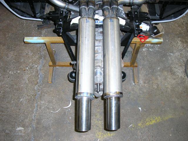

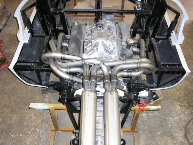

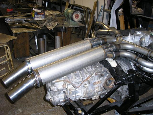

Mick at Southern GT did my bundle of snakes I have a 351W engine and Porsche G50 gearbox. He borrowed my G50 box as he had not done an exhaust for that set up before. I believe he has the jigs / templates to do them for Porsche G50, Renault and Quaife ZF type boxes. May be worth contacting him to see if he does Audi ones if you are interested.
I suspect it will not cheap with shipping, but buy cheap buy twice and the Quality is remembered long after the price is forgotten you will also save you a lot of time
Southern GT - Manufacturer of the new Southern GT40 Replica-1skif4k8a3o0j257im4kchid50
Pictures of my exhaust built by Southern
