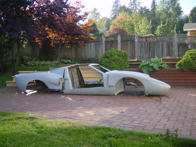

Eric,
From the profile shot, you can see that the height of the door sill grows quite a bit toward the front(should be even). That might be a pain to fix, as you'll have to re-work the sills and doors, in order to get a straight line.
Re: Your opinion and please don\'t flame me to bad!
It actually is even just the weight of the body crushing it. Not that it matters as I have cut that whole bottom off and rolling some aluminum sheet for the bottom.
Here are the pix of my body when I got it. /ubbthreads/images/graemlins/cool.gif
#2 /ubbthreads/images/graemlins/cool.gif
#3 /ubbthreads/images/graemlins/cool.gif
#4 /ubbthreads/images/graemlins/cool.gif
