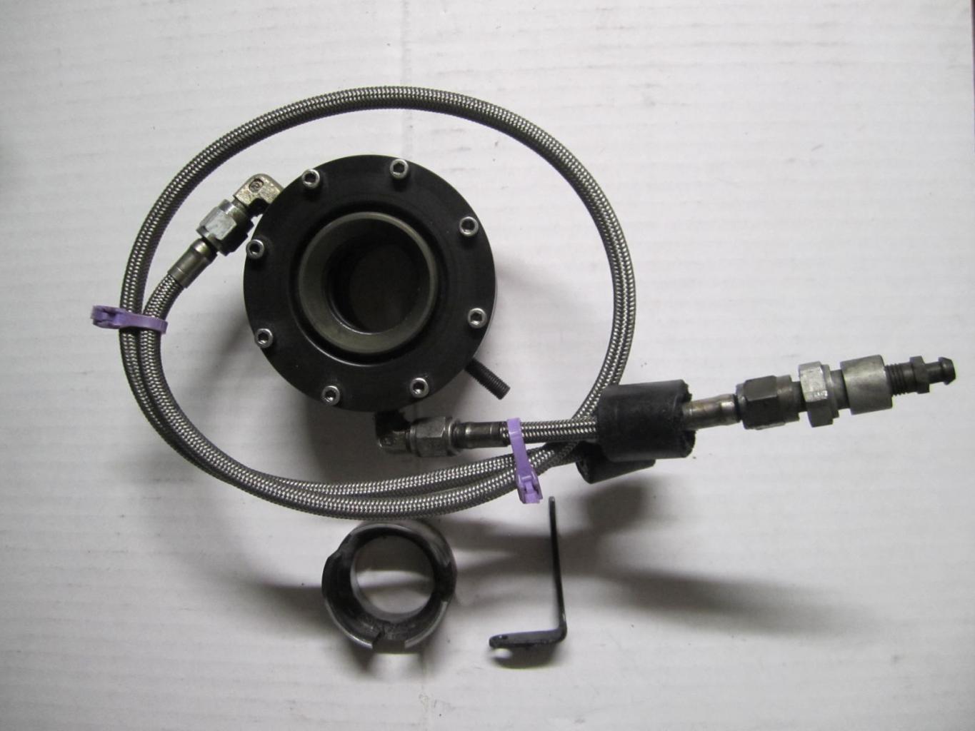

I purchased a hydraulic unit from Joules on here, it may be worth dropping him a email to find out where he got it.

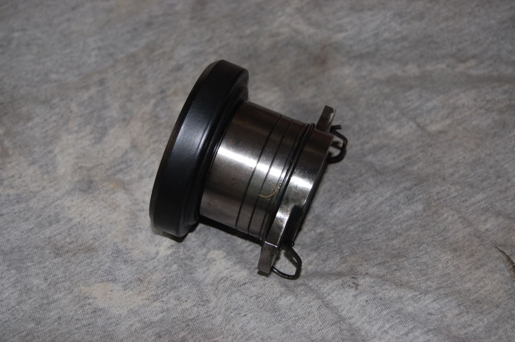

I meant the actual spacer, the hub that the fingers engage, instead of using an original pantera one, I've seen ones with spring clips built into the spacer to better grab the fingers but i don't know which ones to use.
The one I posted before comes with hub and springs. The Summit photo is incorrect. See attached photos. It's McLeod #16525.
